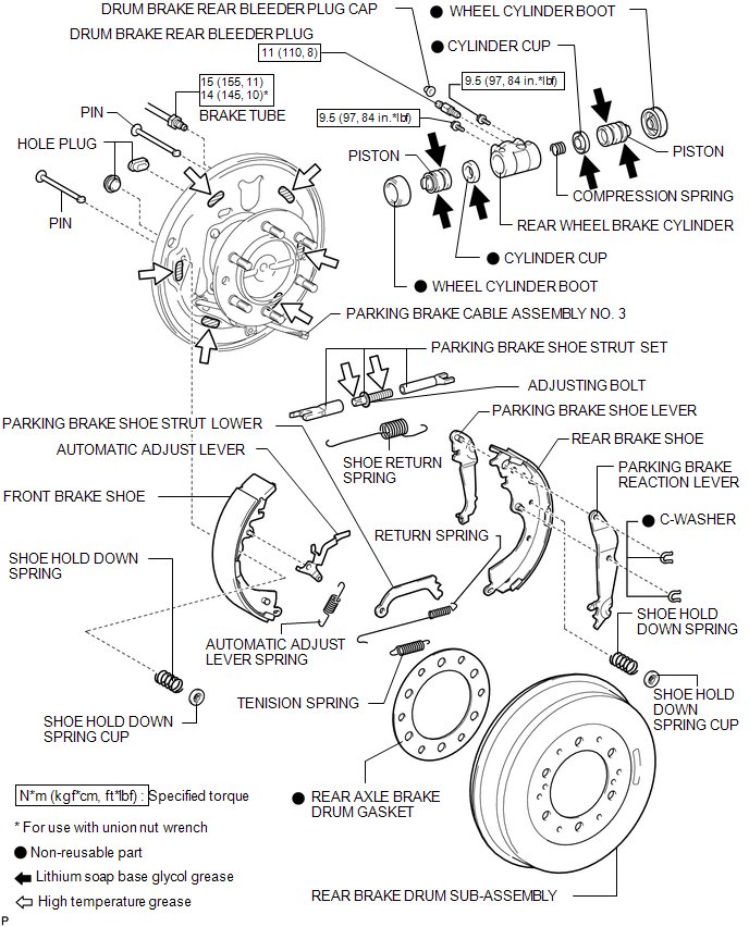

    You can follow a manual, https://www.ttguide.net/components-508.html
    Or what I would recommend, only do one side at a time. The left and right are typically mirror images of each other. So as long as you take a couple of pictures and compare each side before removing any components, you will be fine.
    Make sure you do not push the brake pedal while the drums are removed, this can be a costly and messy mistake. It can blow a piston out of the brake cylinder.
