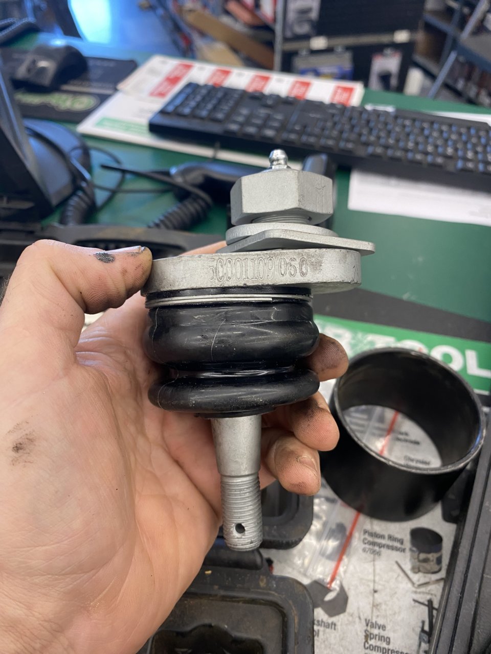

    I got new ball joints from SPC to replace one that’s worn but not sure on what tool I need to remove it from spindle and then do I need a press to get the new ones into the spindle or can I crank down on the castle nut until they are seated.
    I went by O’Reilly’s and they had a ball joint tool but it didn’t look like it would work the the offset design of the SPC ball joint and my spindles are gusseted.

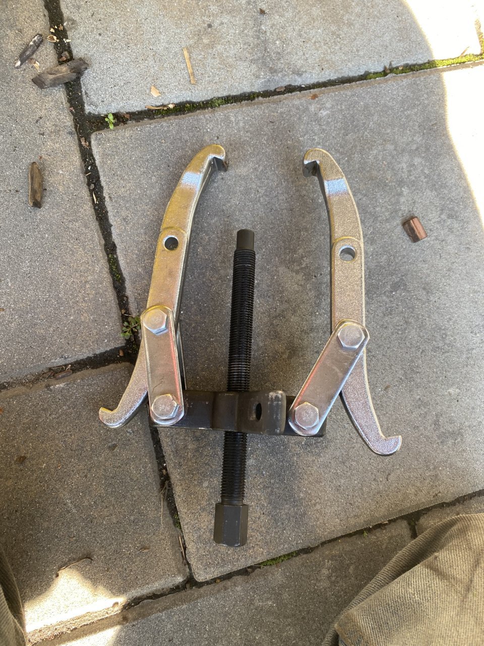

    A894696B-D952-4456-9418-5E0AA5432F87.jpg Wasn’t able to get any leverage with the hammer to get a good hit, even with a long punch but found success using this puller. It can be set with 2 or 3 arms. In the 2 arm config I was able to get it so that the gussets didn’t interfere.
    thanks everyone :hattip:
