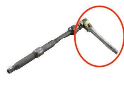

    So, I've got the typical 1st gen tacoma steering slop issue. I dont want to do the tac weld mod or whatever, I'd like to just replace the entire steering shaft assembly. Well, I just tore into the truck to replace it and found that I cannot figure out how to remove the upper portion of the shaft (the smaller upper portion above the ball joint thing that connects into the steering wheel). I got the entire steering shaft with the steering wheel out just like Timmy The Toolman shows, I even tried just swapping the lower shaft and ball onto the existing upper shaft but the spines dont match up when installing back into the truck. So thats a no go. I have to replace the entire shaft to do this.

    Hi me.
