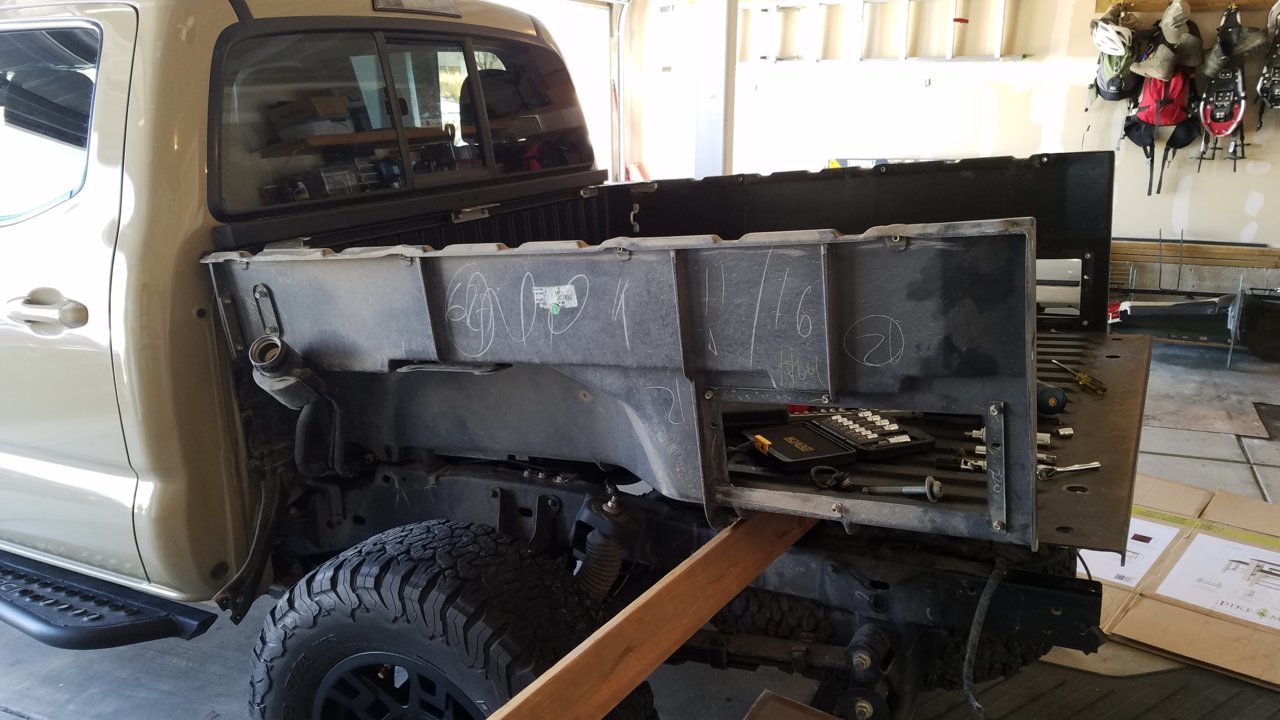

    I saw on a YouTube vid that removing all the bed bolts (the T55 ones) allows the bed to be slid rearward enough to provide extra access to the bed panel bolts behind the cab. I'll likely completely remove both bed panels just to get them out of my way for removing/replacing the sill. Since the truck is only 4 years old and being in Colorado, I'm not anticipating any rust issues or having to grind off/drill out any bolts. I'll likely anti-seize the bed bolts when I reassemble, though.

    I just did mine and found it easier to undo the bed completely and lift it up and off the trick, in order to slide the bed back you have to remove the rear bumper as well. And I was hoping to avoid this completely. The sill itself drops below the top of the bumper at the rear end making it harder to slide the old one out and new one in while still on the truck.

    I did not have to remove the bumper, but you need 2 or three ppl to lift the truck bed up and over the bumper and gas tank neck, don't forget to take the gas cap off.

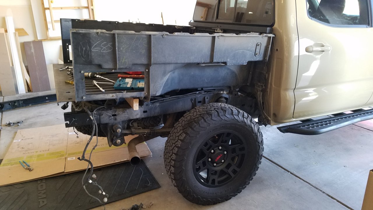

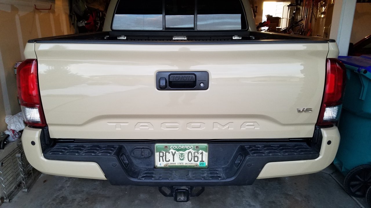

    Got 'er done...

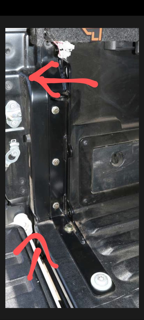

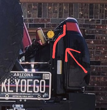

    I had to replace mine a while back due to a spare tire holder. They crack at the top where the metal bends, most bed stiffiners don't mold to that part of the sill but the total chaos ones do.

    They fail near the top? at the red line?

    The bottom corners failed from hauling wood, the bed stiffiners I got where the only ones that molded that curve at the top, but they all support the bottoms corners

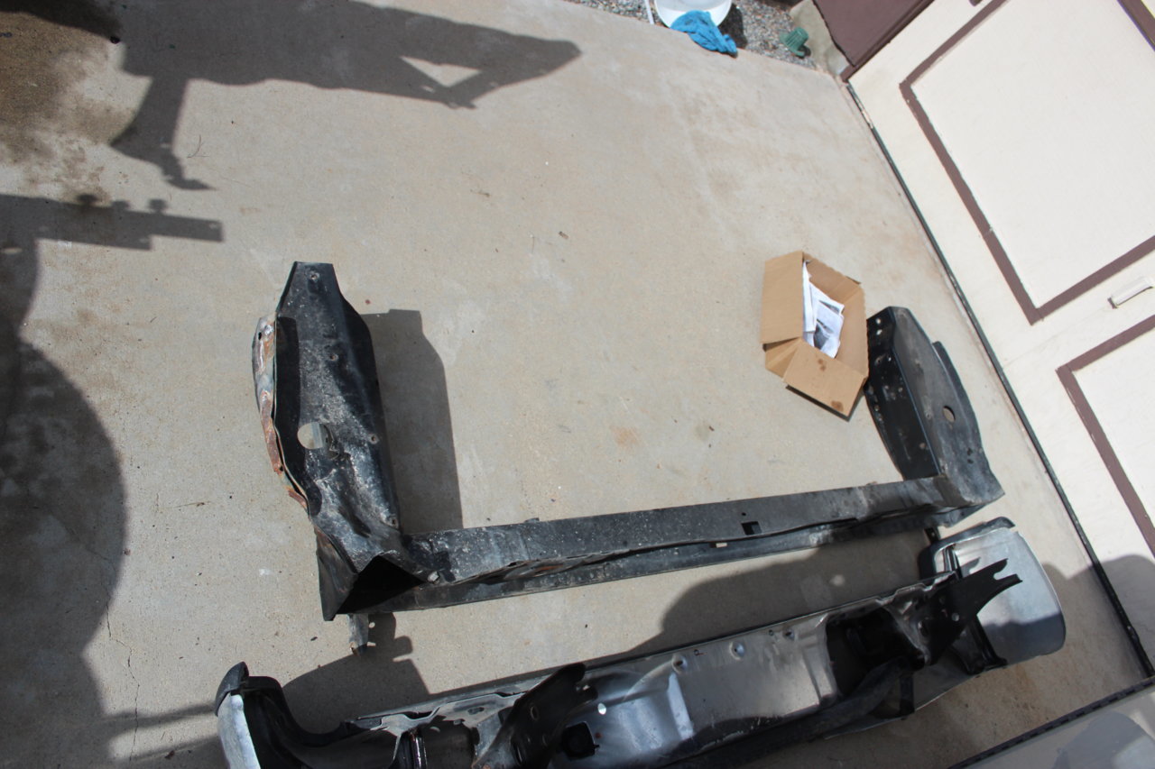

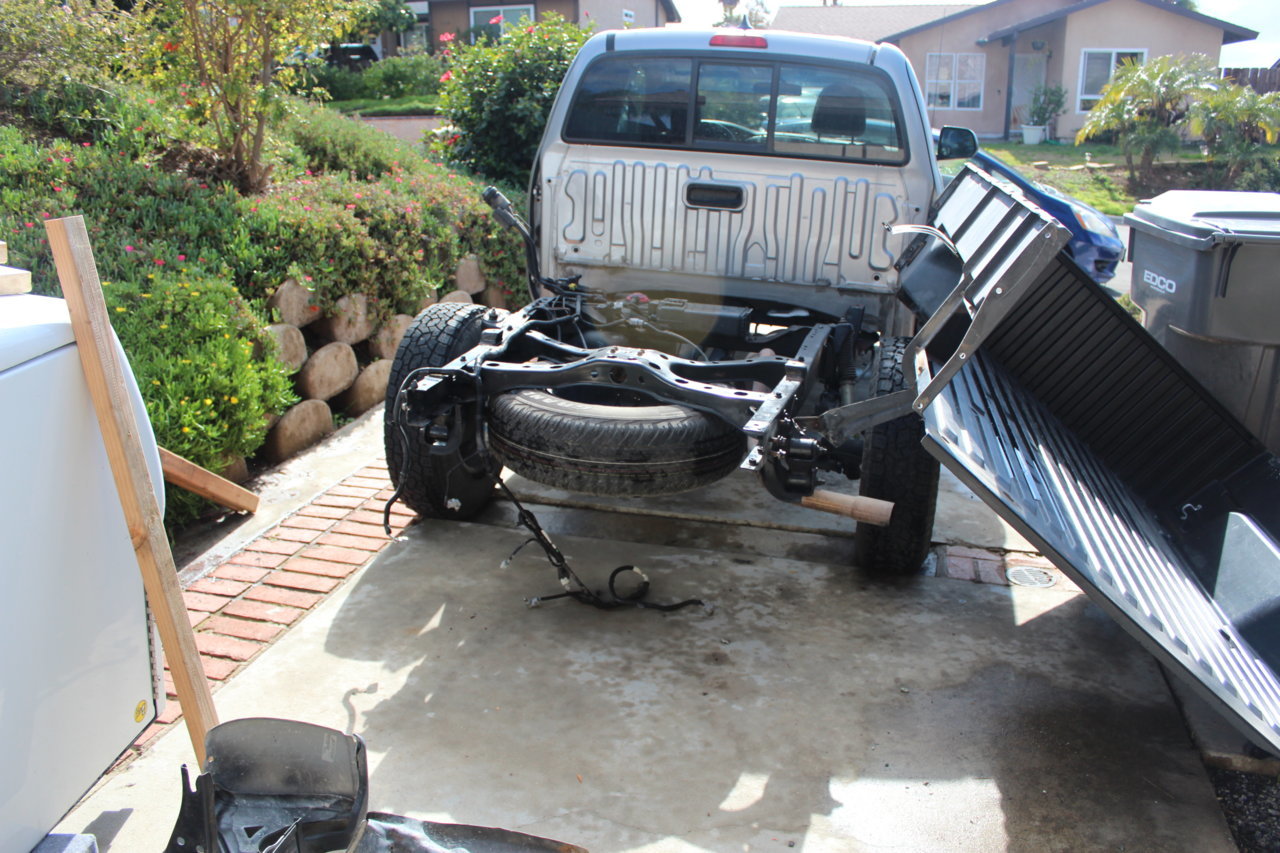

    I got the bed off & damages bed sill off - I picked up the new one at toyota got the internet discount $525 or so ouch but better than $750. The new one is sheet metal with spot welds and some glue in a few spts.
