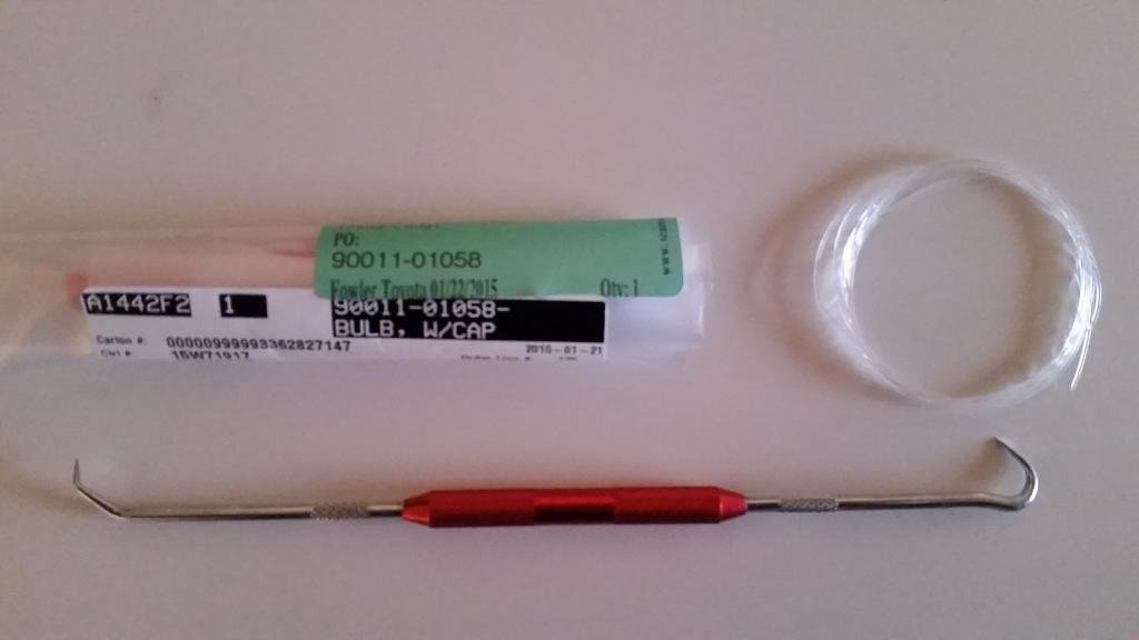

    Supplies needed:
    -From the Toyota dealer part number 90011-01058
    -Fishing line (I used some 20lb line I had left over from debadging)
    -A small flathead screw driver
    -(optional) a small dental pick style tool

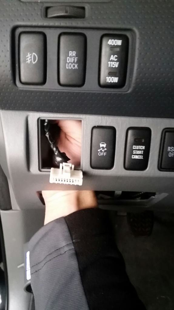

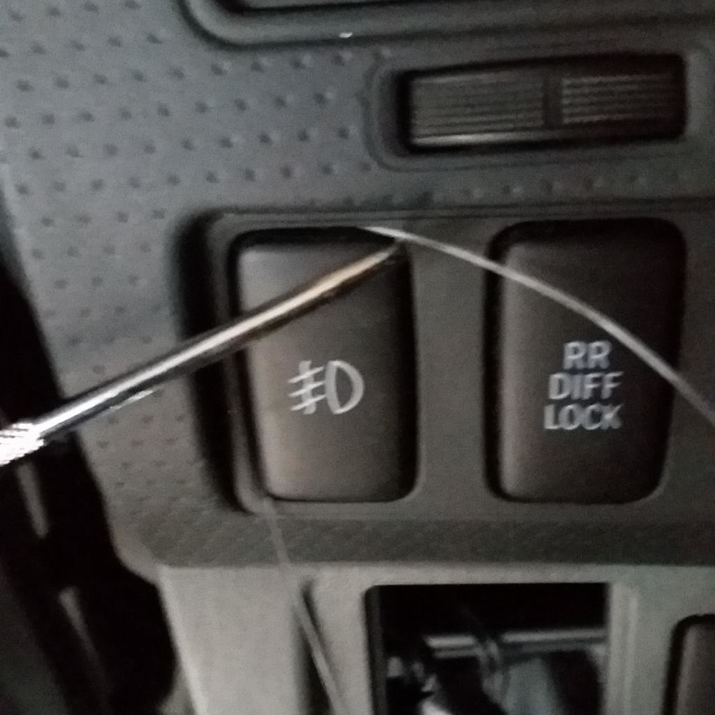

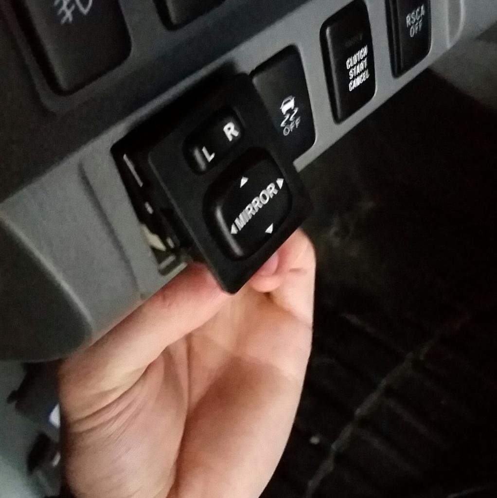

    The first thing you'll need to do is remove the change cubby on the left side of the steering wheel. This is easily done by pulling straight down on it while it's open. From here, put your hand up under the dash and push out the mirror control switch from behind.
    Next you'll want to wrap your fishing line around the foglight switch. This is where I found the pick to be useful in shoving the line under the corners of the switch.
    affe15ee-42a9-4039-a086-c5b7dde6f44b_zps_6fbbfe002dc026ffd5aa01e283d072b7dbc06c9d.jpg
    After this, I shoved my right hand through the cubby hole and pushed on the back of the fog light switch. It's a tight fit back there.
    At the same time, pull with medium tension on the fishing line and push on the back of the switch. The switch should just push out. After it's out push on the clip and unplug it.

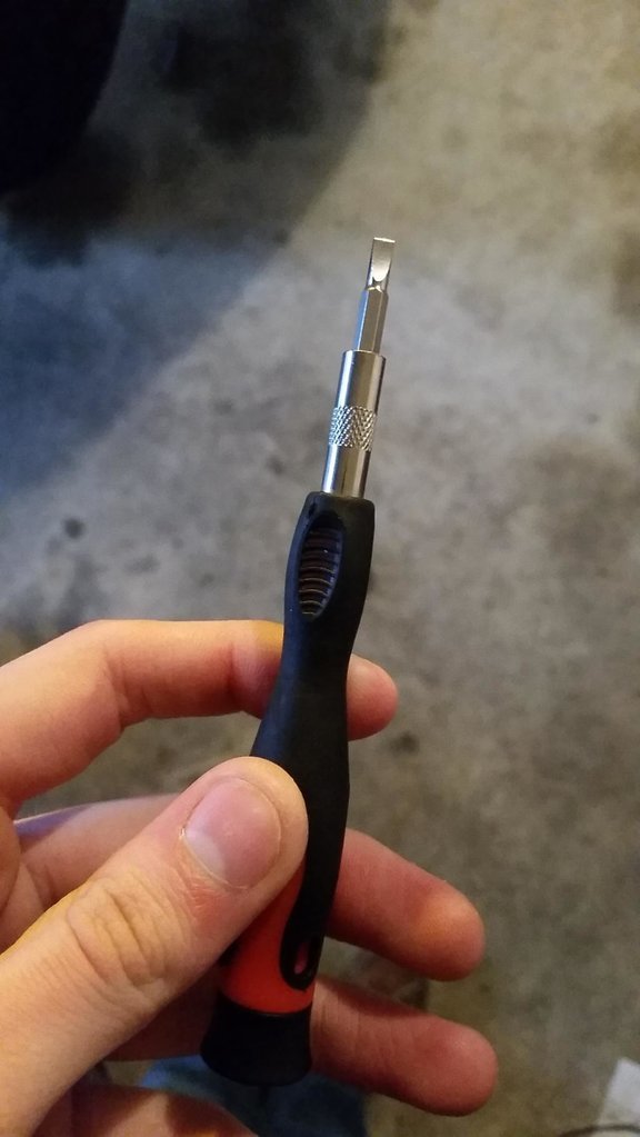

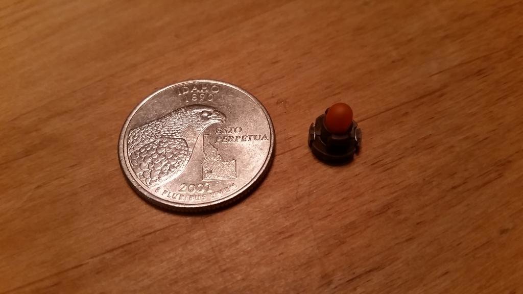

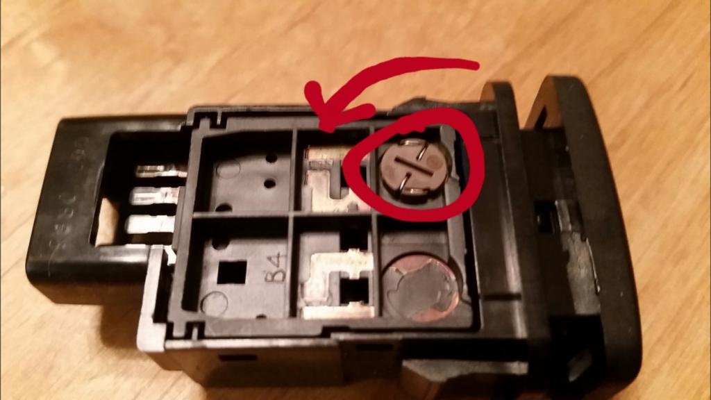

    From here you'll be able to see the bulb. Using a flathead, turn it a quarter turn counter-clockwise; it should loosen up and come right out.
    The bulb:

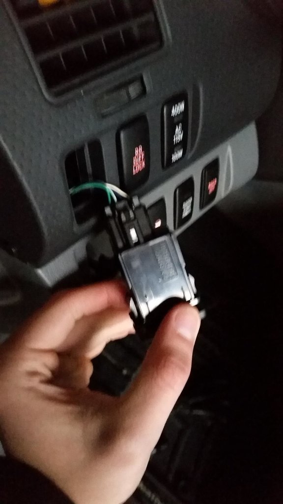

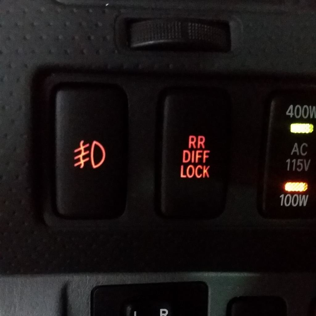

    After this reverse the whole process and you should be done. your final product should look something like this:
    131fe1fc-0edd-4d4f-80f5-0633101388de_zps_f043fee79f8990a43a6d733496bcea233e7142ea.jpg
    Hope this helps a few of you guys out. Make sure to be gentle with everything. Plastic likes to break. This method worked very well for me, and it did not necessitate me removing the whole lower dash. Oh yeah, the bulb cost me just under $7 after tax from the dealer.
