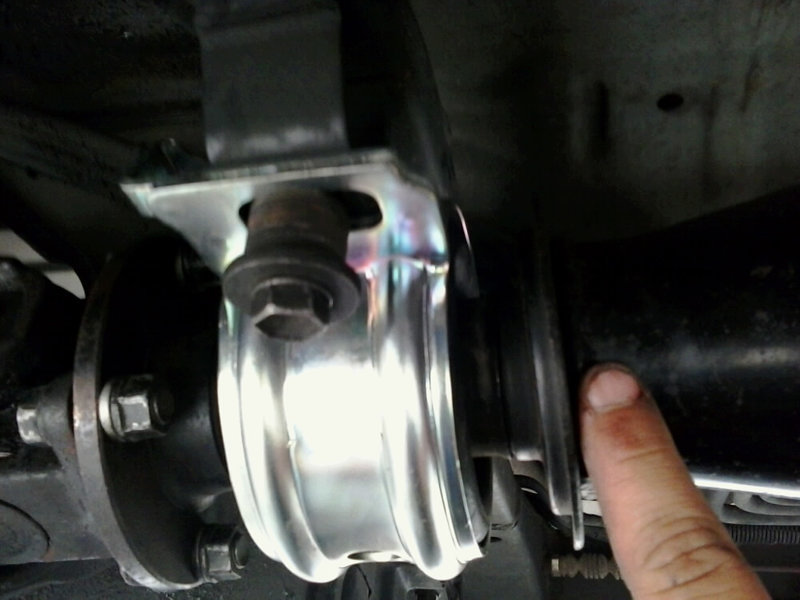

    So i just did this job and it went great!!
    One problem though. I noticed a faint squeaking noise when i first started rolling. I don't hear it anymore but when I reach and feel the drive shaft not the flange side but the other side it is extremely hot. I did put grease on it also so I don't know why it is SO hot. I have to travel a long distance in the next couple days and could use some advice. Thanks

    Can you post a pic of your angle?

    Here it is. I'm pointing to where it gets hot. As I've driven it more I noticed it is not as hot as it was earlier today. I noticed this issuer popped up in this thread a few times and there was never an answer. I think I know now. There is a note that comes in the package that says to put grease between the outer seal and the bearing. I put grease on both sides but didn't pack it in on the side that is getting hot as much as the side where the flange goes on. I wonder if I would need to take it back off and try to tap that carrier bearing down and pack more grease in there. My dad says it should be fine and will work itself out but I'm just not sure.

    I wonder if just the rubber skirt is rubbing at first?

    Not sure but the carrier bearing itself is not getting hot. Appreciate your help. I'll definitely keep an eye on it.
