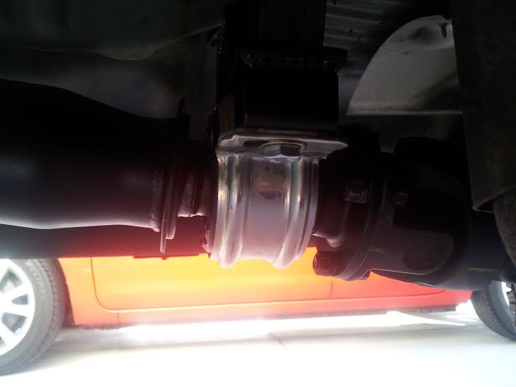

    Any help is appreciated. My 02 Tacoma had a good amount of vibration in the drive shaft at various speeds so I removed it and installed new front and rear u joints. Left the center cardon joints alone and installed a new center bearing. I also added a Street Tacos center bearing drop bracket for my 3-4 inch lift. The truck drives much better but still has a slight vibration at the start. Some questions I have are, does my shaft angle look okay where it is going through the center bearing or should it be more level with the center bearing? Or will I need to take it to Toyota and have the shaft re balanced? Below are pictures of the angle.fb573ac3-8104-49b1-8f51-751a44c1006e.jpg

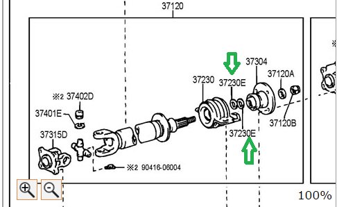

    Thanks for the guide. Helped me quite a bit. I have a question. There are two washers/spacers I took out of the old center support bearing. I did not pay attention where they came from because I thought they were broken pieces off of the old bearing and now I'm not sure how to put them back together. I saw the attached picture on an online Toyota dealer website. Do these two spacers(green arrows) stack up like this how it's shown?
    I have a PDF repair manual and it shows only one spacer. Any help would be appreciated.

    Mine was the same ease of removal and I purchased jaw pullers for no reason but to store them for the next project...

    Yes I bought a set of Jaw puller and ended not using it for this project either. I also saved them for future projects. Thanks for letting me know you had the same experience removing the bearing.
    Do you remember seeing the two spacers I mentioned above? There are two of them and I stacked them together as shown in the picture above. Does that look familiar to you?

    The spacer is just a washer and I only had one.

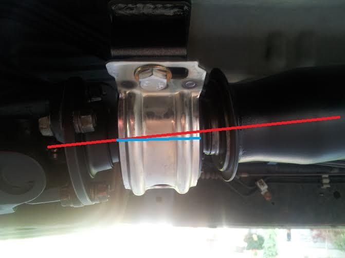

    anyone else have success with these brackets? Also curious what it looks like installed the picture on their website doesn't make sense to me.

    I can get some better picture in the daylight tomorrow. I have wanted to remove it and see what it does to my vibrations. With it on there the front and rear u joints have very little angle and I thought it would smooth most of the vibs out but it just made the vibration ranges broader. They have two size brackets depending on your lift. Really easy to put on but not sure it's worth the $75 at this point.

    has anyone else bought one of these not get the results they were hoping for?

    I just worry that if I end up putting a OEM on a raised truck that it will just get the same results as I've got now. That's why this poly bushing.

    Depends on the degree of lift I suppose?
    My truck sits on an OME suspension lift, with 883 coils in the front and HD Dakar leafs in the back, and I didn't have any issues. I'm probably rolling around 2.75" of lift overall, although as I have stated in other threads here, I don't really measure that stuff.
    IMHO, poly bushing drop kits/diff drop kits probably don't hurt, but once we all start to drift from what the OG TEQ engineers created (ie: stock driveline geometries :sawzall:) in their lovely little labs...all 500,000 mile bets are off. ;)
