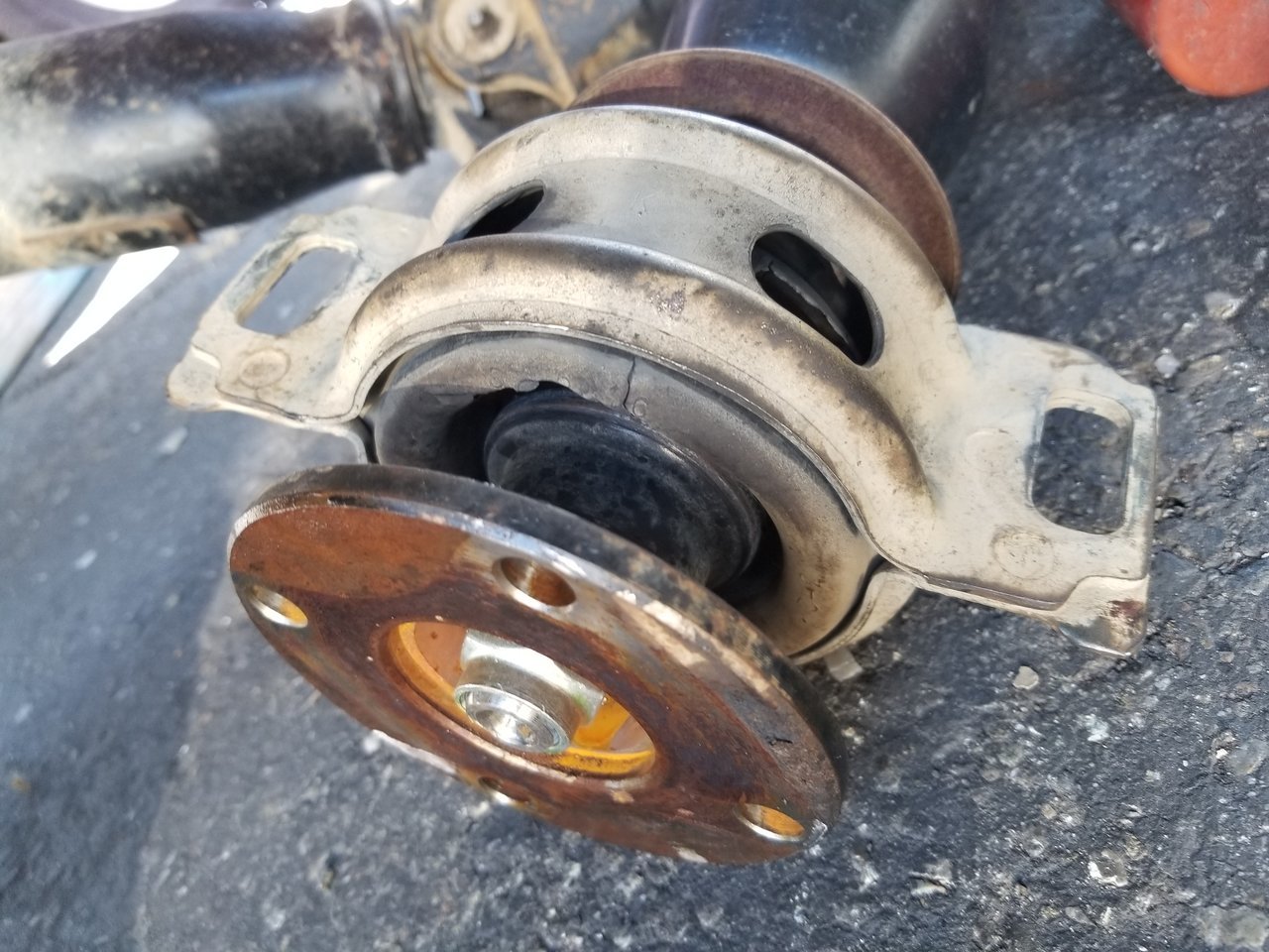

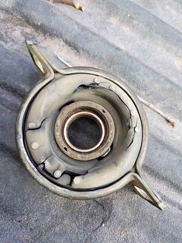

    I think i might hold the award for the most wasted carrier bearing :rofl:
    This was the condition of it from the previous owner. About 3 inches of play.
    New one is in and much more smooth with no vibrations :)
    geoyota760 likes this.
