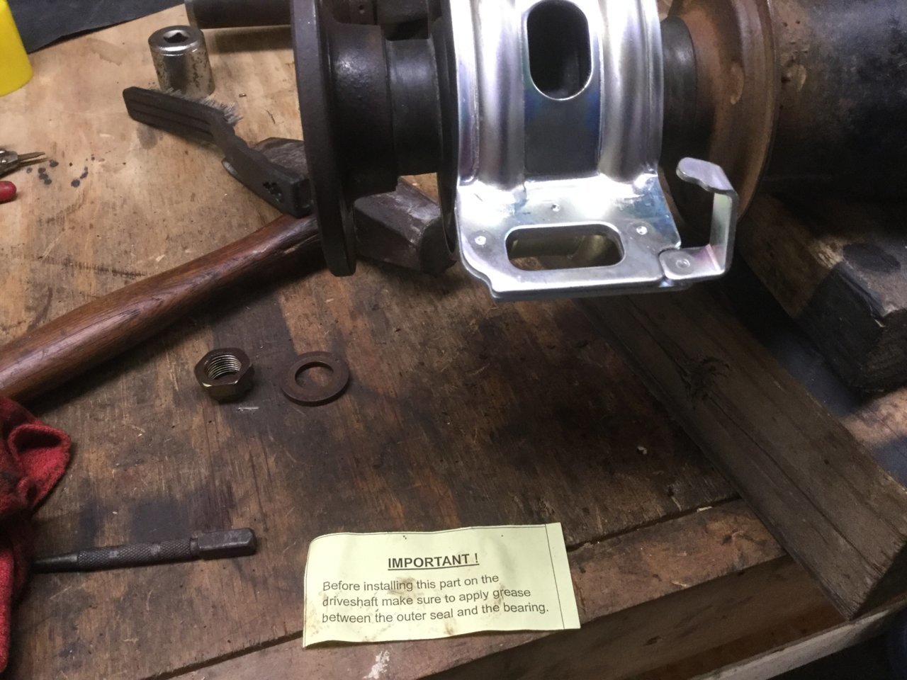

    Hi everyone, long time reader, first time poster...
    One thing I have always done when replacing this bearing, that I don't see mentioned anywhere in the thread, is to pack the bearing and surrounding void with grease when/before installing. This has definitely added longevity to the bearing for me over the years. The one time I had a shop do this job for me, it failed the next summer, and when I uninstalled it, it was dry. Here in MN the salt and sand in winter will trash these bearings. I also fill the metal bearing housing with hi-temp silicone, as I have seen mentioned, to beef up the surrounding rubber insulation. Just wanted to get this in there for people's installs! Cheers

    The first replacement bearing I bought came in a box that had a sticker over the opening that said "Pack bearing surround with grease before installation". That was a no-name brand bearing, but I think it is a good idea. No other replacement I've gotten has said anything about it, but it is definitely not going to hurt anything. The real problem is that you have to have the driveshaft in two to make it happen. I've read some interesting posts where people have retrofitted a "pillow block" style bearing, that is greasable. It ends up vibrating too much through the body. SoS on the stock one, the rubber bushing is actually doing a big job, isolating the driveshaft from the frame, essentially. Super simple, complicated as hell!

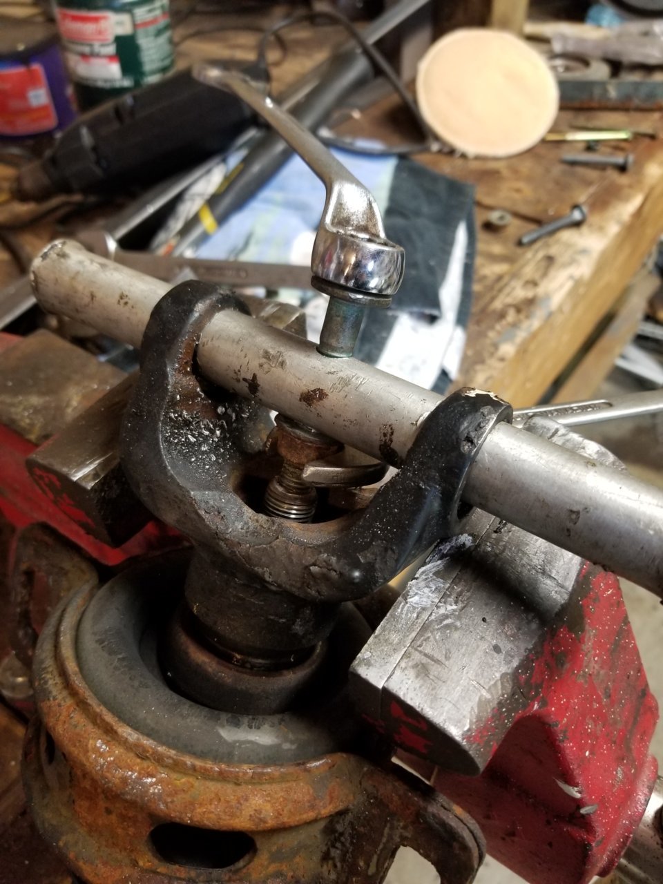

    Did this today. The yoke was really stuck on there. BFH and torch wouldn't budge it. Came up with this little tool with some scrap aluminum stock. Worked great.
    Edit : this is for 2nd gen

    ^^ Nice puller (reverse press??) you made!
