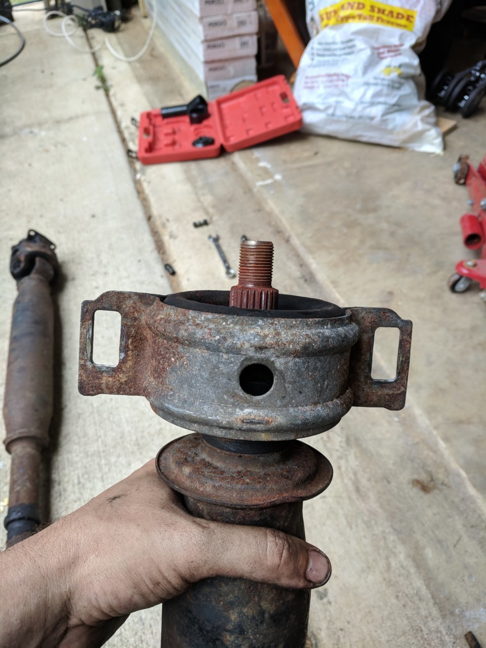

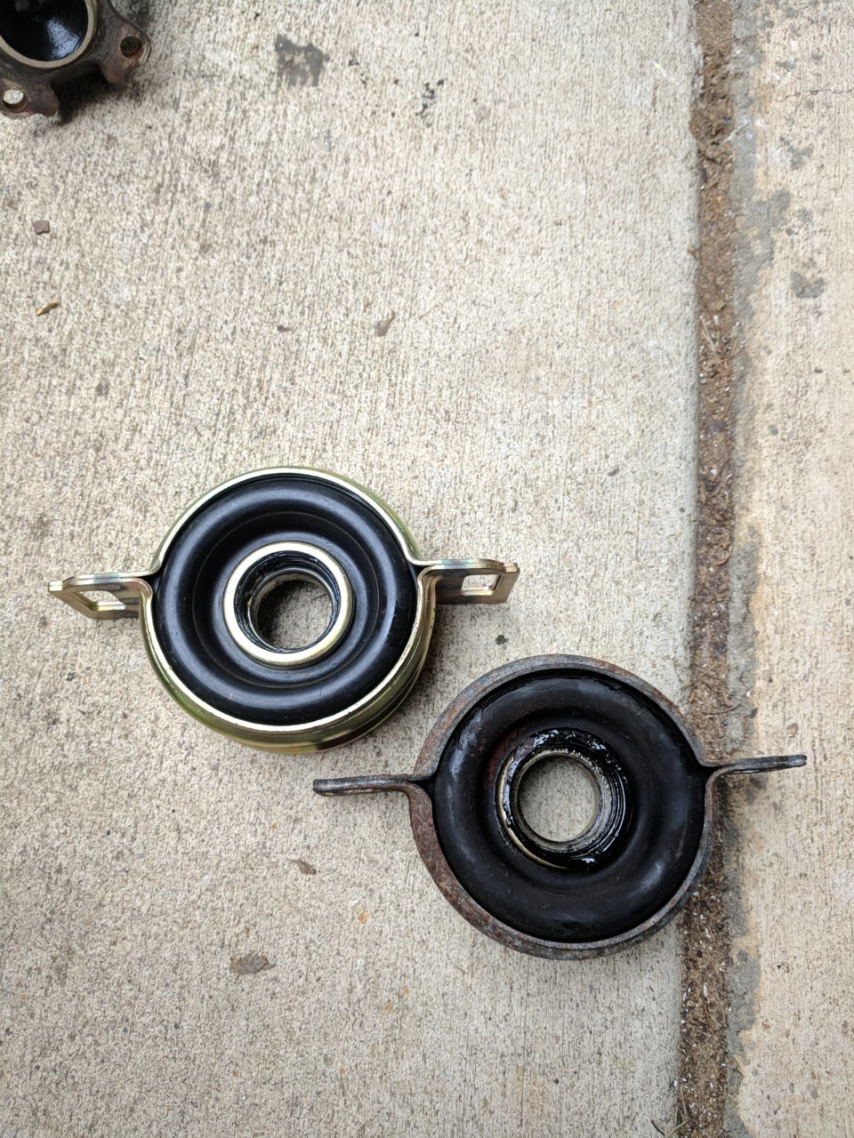

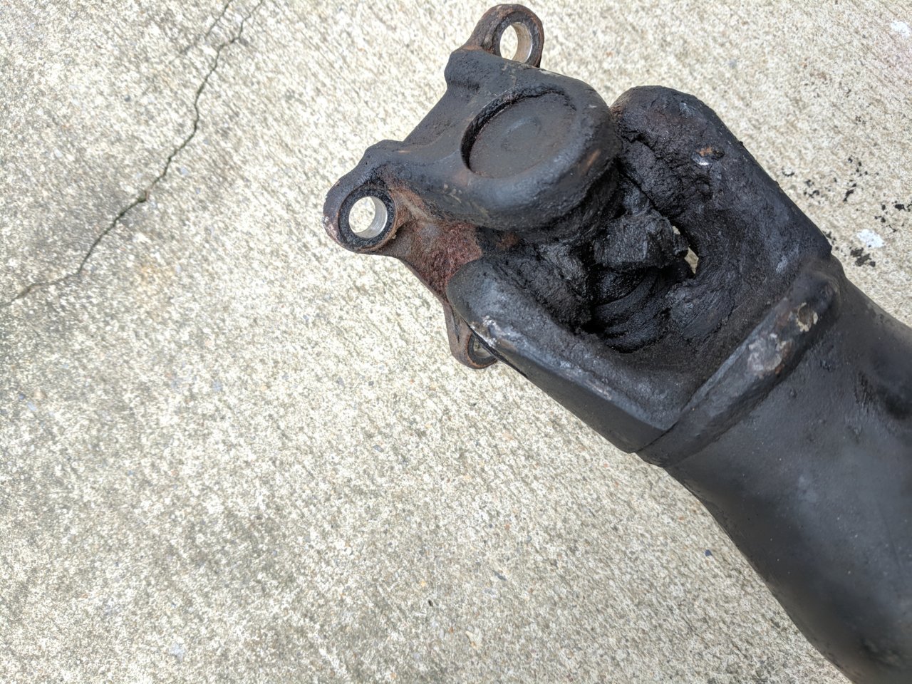

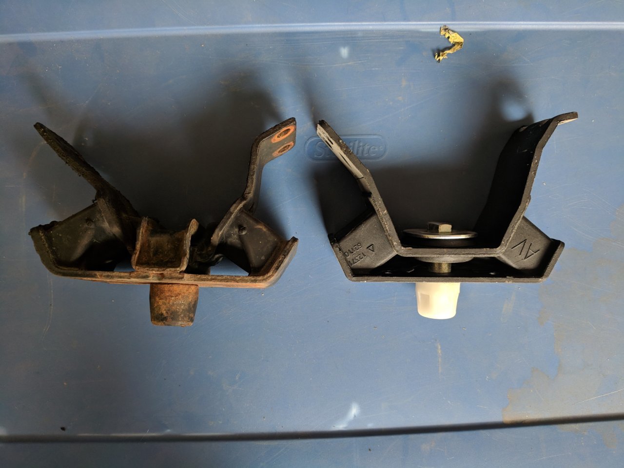

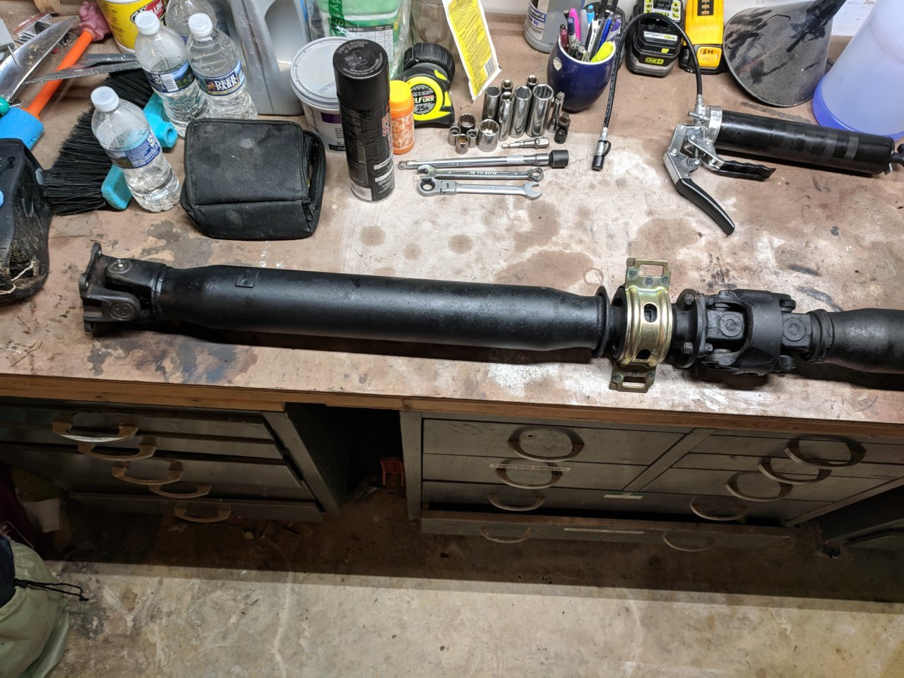

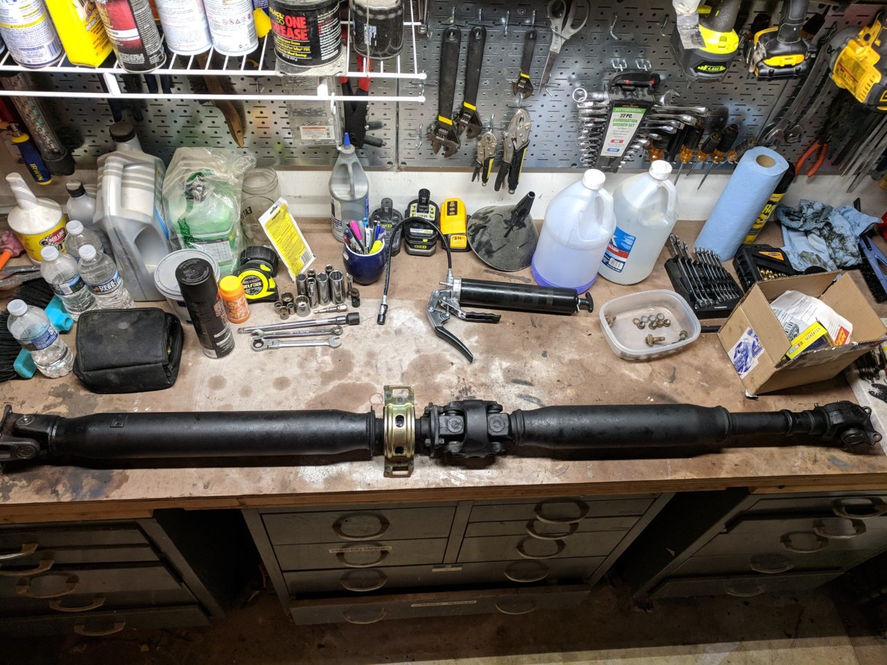

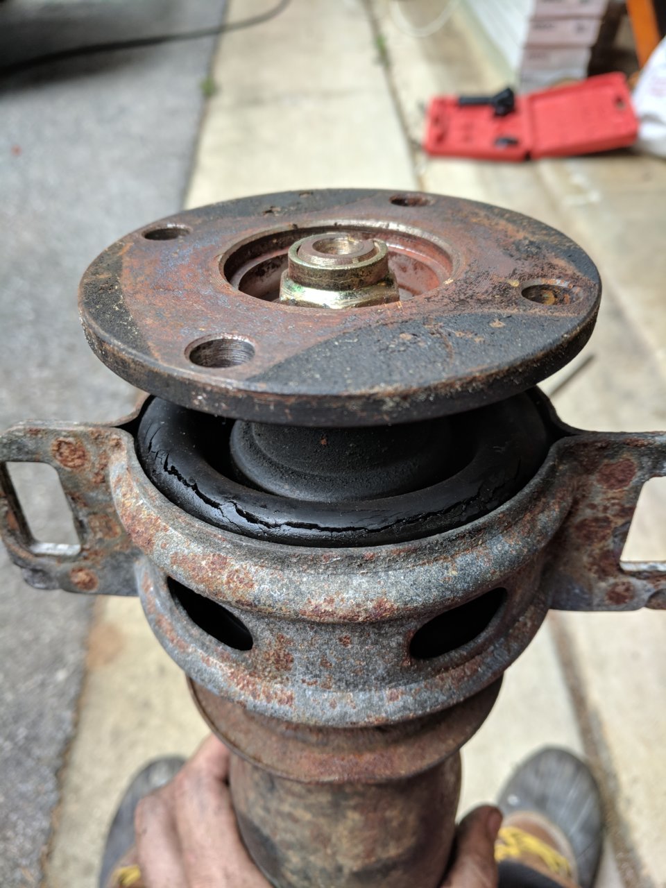

    Alright, got this job done last weekend. Replaced CB and U-joints at th e transfer case and rear differential. Cleaned up everything real good with a pressure washer and cleaner. greased up everything (6 total zerks) and got it back together. Also replaced the transmission mount while I was under there. It is much smoother now! Drives like a new truck. Although the U-joints were dirty as hell, they actually seemed to still be in pretty good shape. Now, the CB and Transmission mounts on the other hand were both shot! Which brings me to my main issue:
    I replaced the CB in the same orientation as I took it out. Problem is, looks like it was replaced before and incorrectly. So therefore MY CB IS BACKWARDS!! I realized all this afterwards when I finally decided to pull out the FSM and take a look for torque values. I looked at the old CB and IMHO I do not think it matters that it is backwards. But looking for other opinions. It's an old truck and not my daily so I guess I will be a real life test lol. Here are some picture:

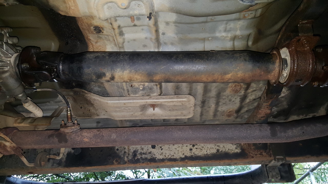

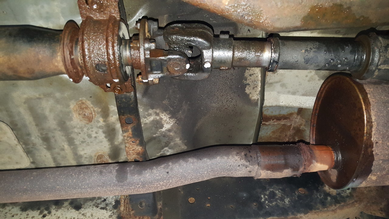

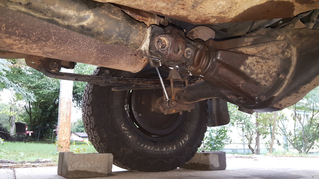

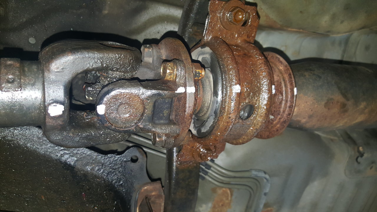

    I've been reading this writeup while preparing to swap my u-joints as well as my CB and I've run into a question.
    In all the pictures I've seen here and in my Haynes book the rear driveshaft(front to back) has a u-joint at the transfer case, then the CB, then the double cardan, then a u-joint at the rear axle but on my truck it is different.
    My truck has a u-joint at the transfer case, then the CB, then a u-joint, then the double cardan at the rear axle. Can anyone tell me why this is? I have a 1997 extracab 4x4

    On first look, the drive shaft segment between the rear axle and CB looks backwards.

  9. Oct 13, 2018 at 1:58 PM
    #309
    Dhearic
    Dhearic Member
    Aug 27, 2016
    #195713
    11
    NW Arkansas
    97 4X4 3.4L Auto
    I had considered that but was hoping that wasn't the case. I bought the truck in September of 16 so it's been like that for at least 2 years and there's no telling what the previous owners did :confused:
    If it is indeed backwards should I switch it back? How do I get the orientation right if I do? This u-joint job just got more interesting

    I believe it is backwards, unless they changed something between the years, doubtful. Slip yolk should by by your third member, double cardon by the cb
