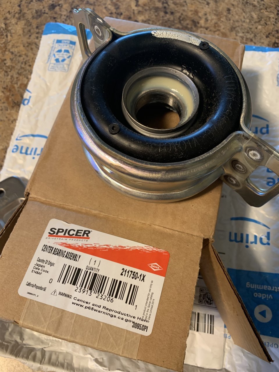

    Arrived today and is Toyota stamped, along Japan origination. 73$

    I forgot to mention mine came in couple days ago and is 100 percent Toyota OEM original and looks just like J Lee's above.

    Just had mine replaced. The original one looked alright for 212k, but needed changed. Shop charged me $135 for the labor. $80 for the Spicer
