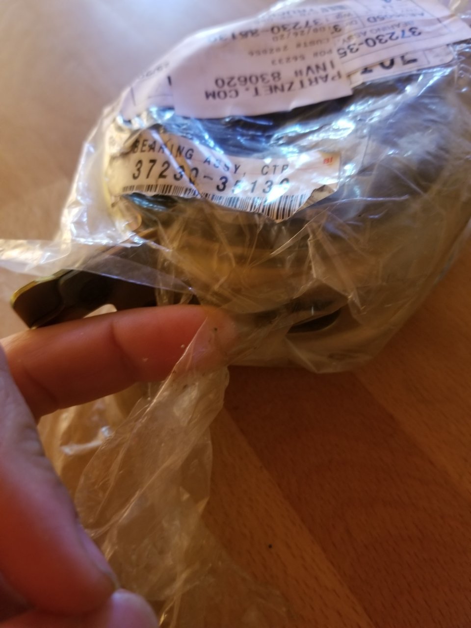

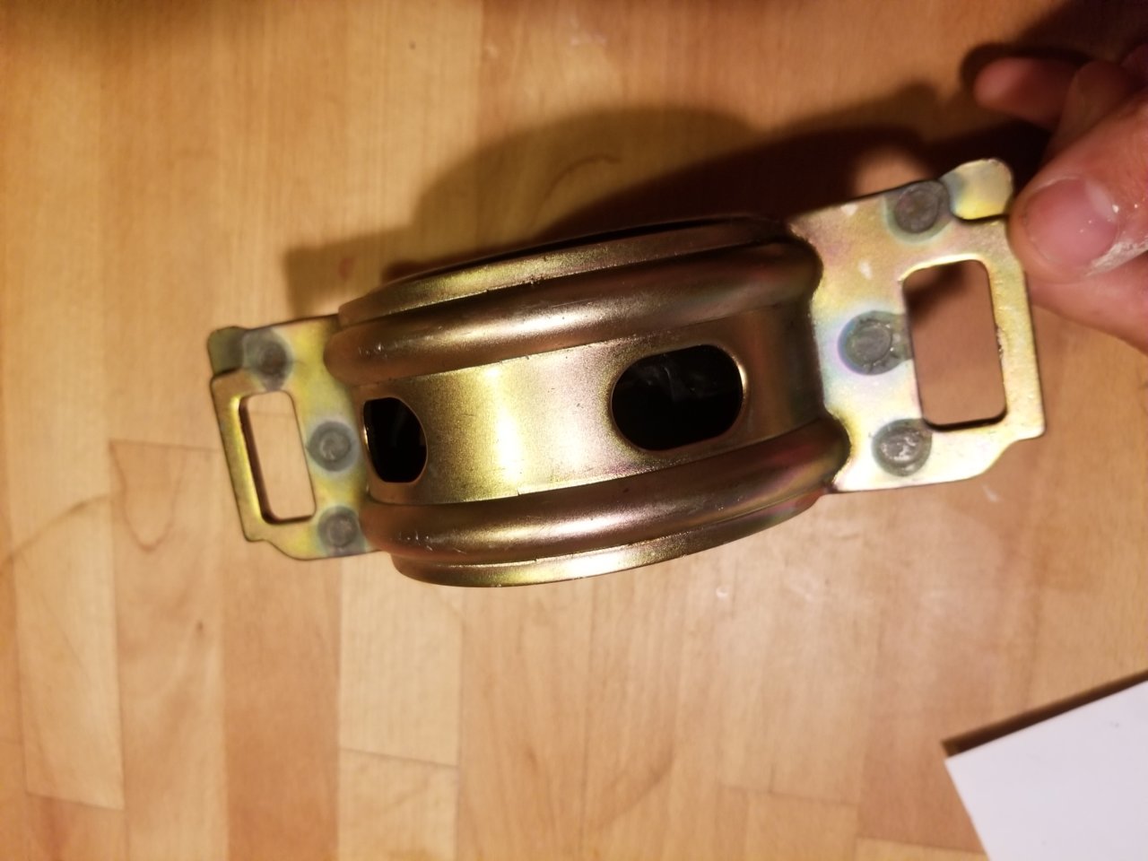

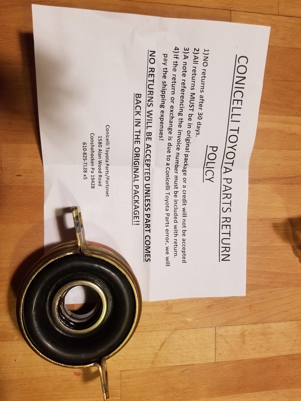

    Is there any way to tell if your carrier bearing is genuine OEM? I just ordered one and it came in a tampered with package with a nice little note stating that I cant return it unless it is in its original packaging. No part number or toyota stamp or anything to distinguish this from a knock off. Im not very impressed and it just feels wrong....
