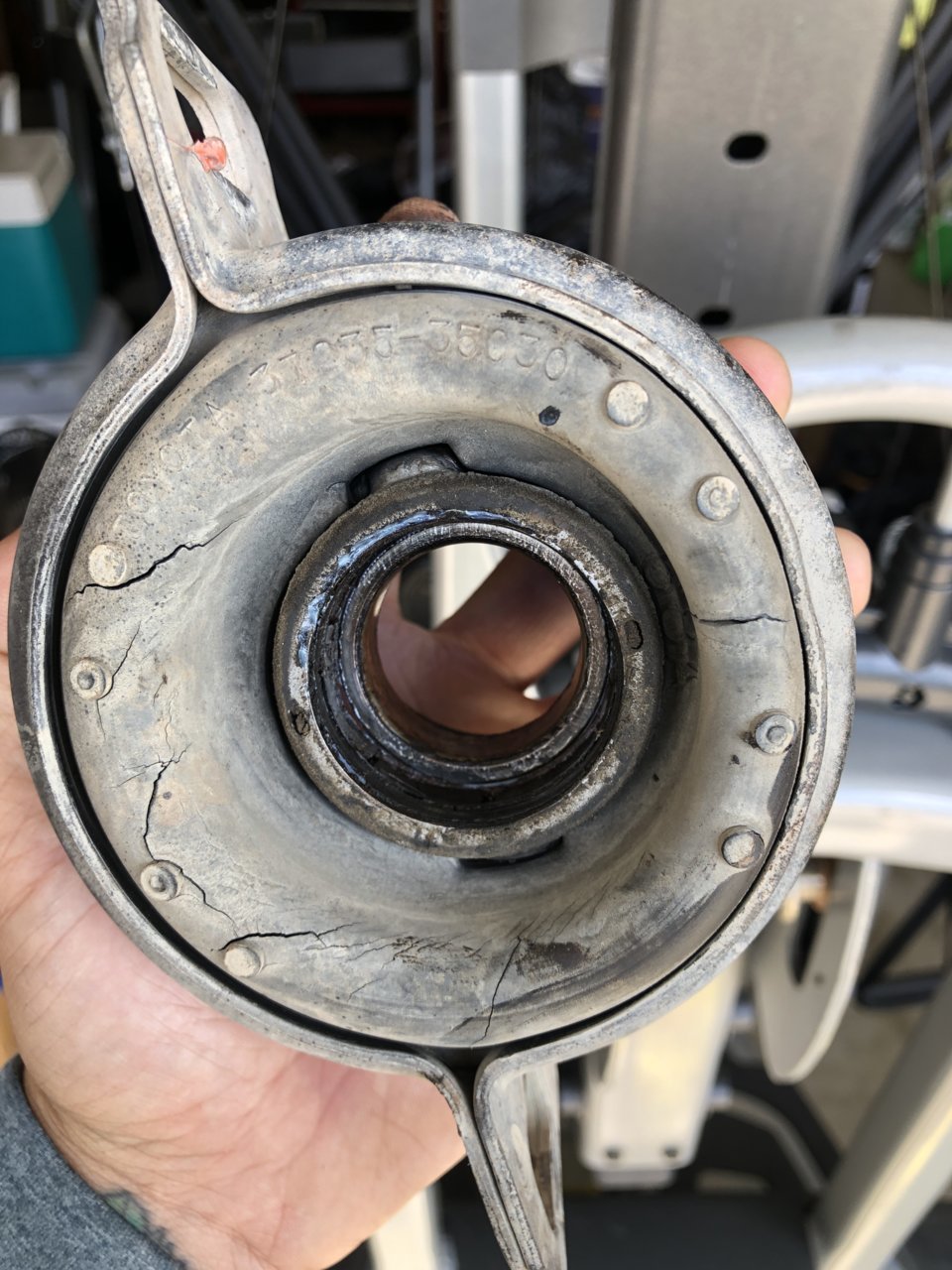

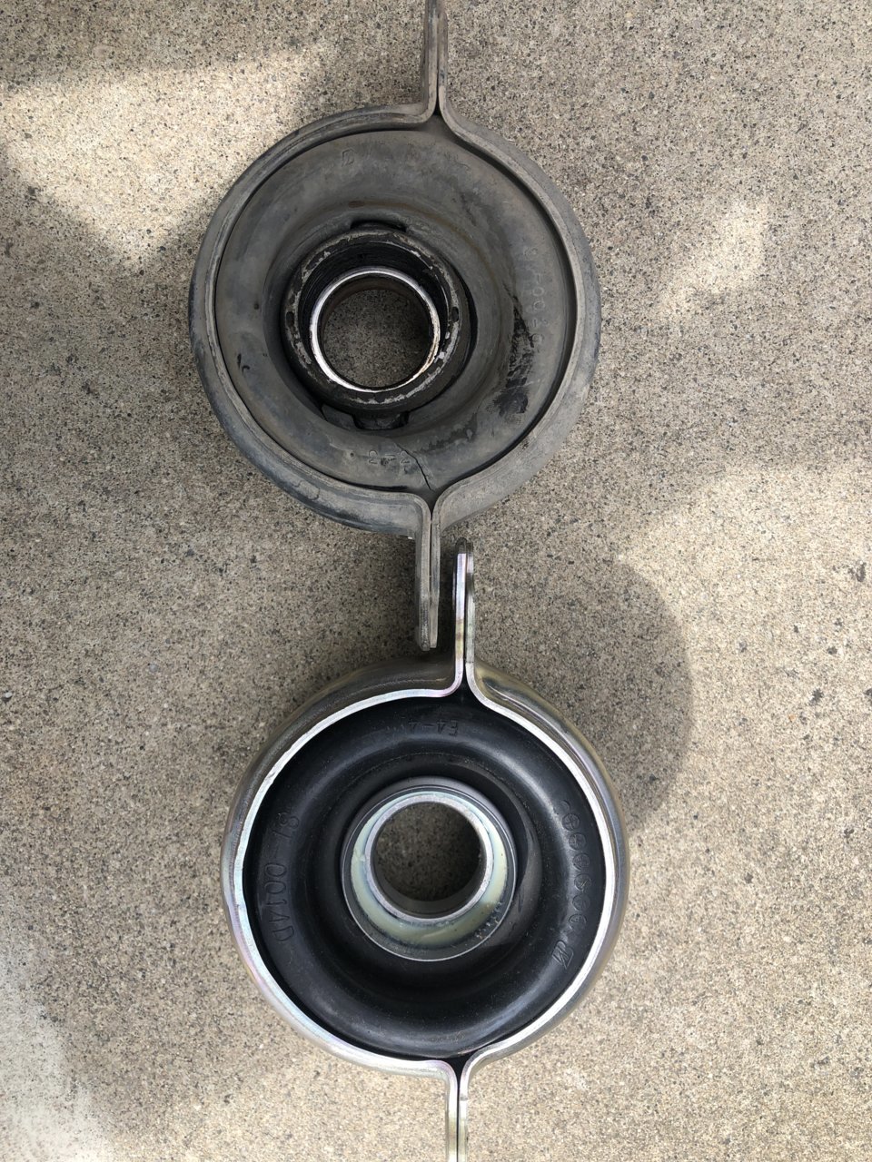

    Great write up Made me want to check my center bearing and sure enough it had a lot of play. Donut was cracked in several places.
    Ordered my Spicer bearing off Amazon.
    My flange came off without a puller.

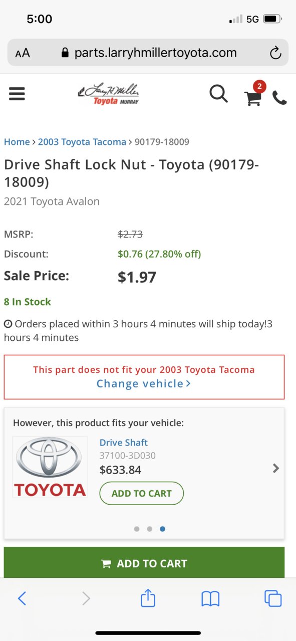

    Reviving a old thread here but can Anyone confirm this is the correct part number? I have an 03 double cab 4 x 4 automatic and when I use this part number on my local Toyota dealership parts website it says does not fit your vehicle. Says it’s for a Toyota Avalon getting ready to do this job wanted to replace with a new nut.

    Anyone that can confirm this is the correct part number? 03 Dbl cab auto 4x4 . When using this part number on my local Toyota dealership parts website it says Does not fit your vehicle says it’s for a 2021 Avalon.

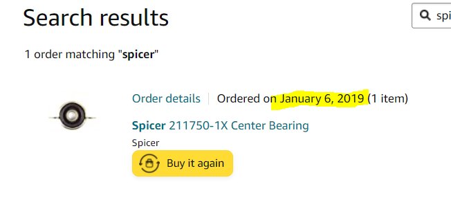

    Northern California, Bay Area
    02 3.4 DC TRD PreRunner 4WD SWAP
    I wonder if the damn thing is still good after sitting on the shelf for 3 years... :facepalm:

    I ordered mine about the same time and had just installed it about a year ago lol. I'm sure it's fine.
