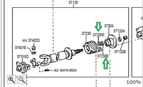

    Not sure if it matters now @Fatal_Paradox but it seems like you misunderstood the order and put the 2 small washers on before putting the CB on. But mine was like listed above and show in the pic in the other post I quoted:
    carrier bearing>spacer>spacer>drive flange>thick washer>nut. Just like this scan below.

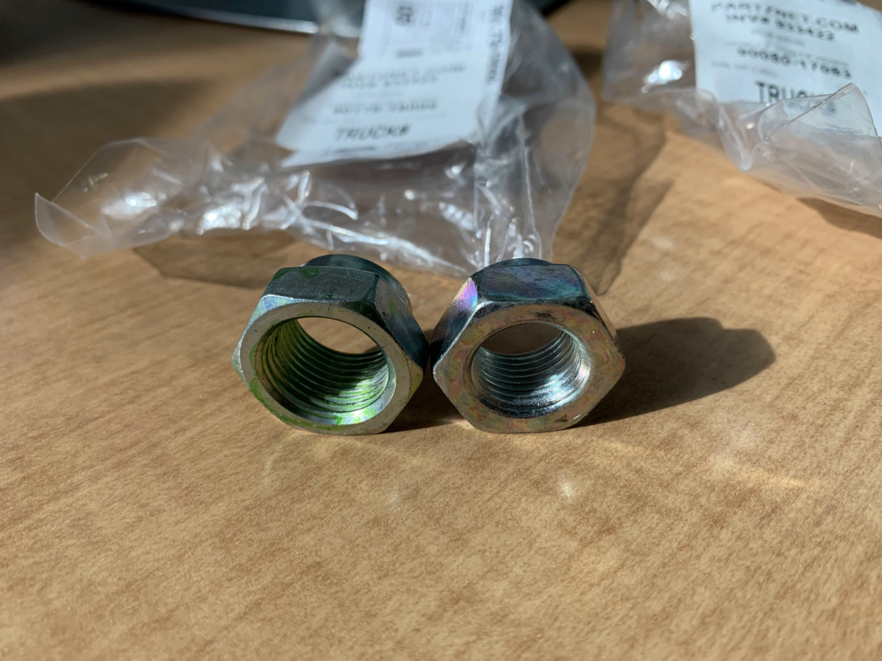

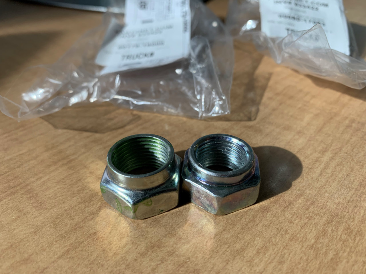

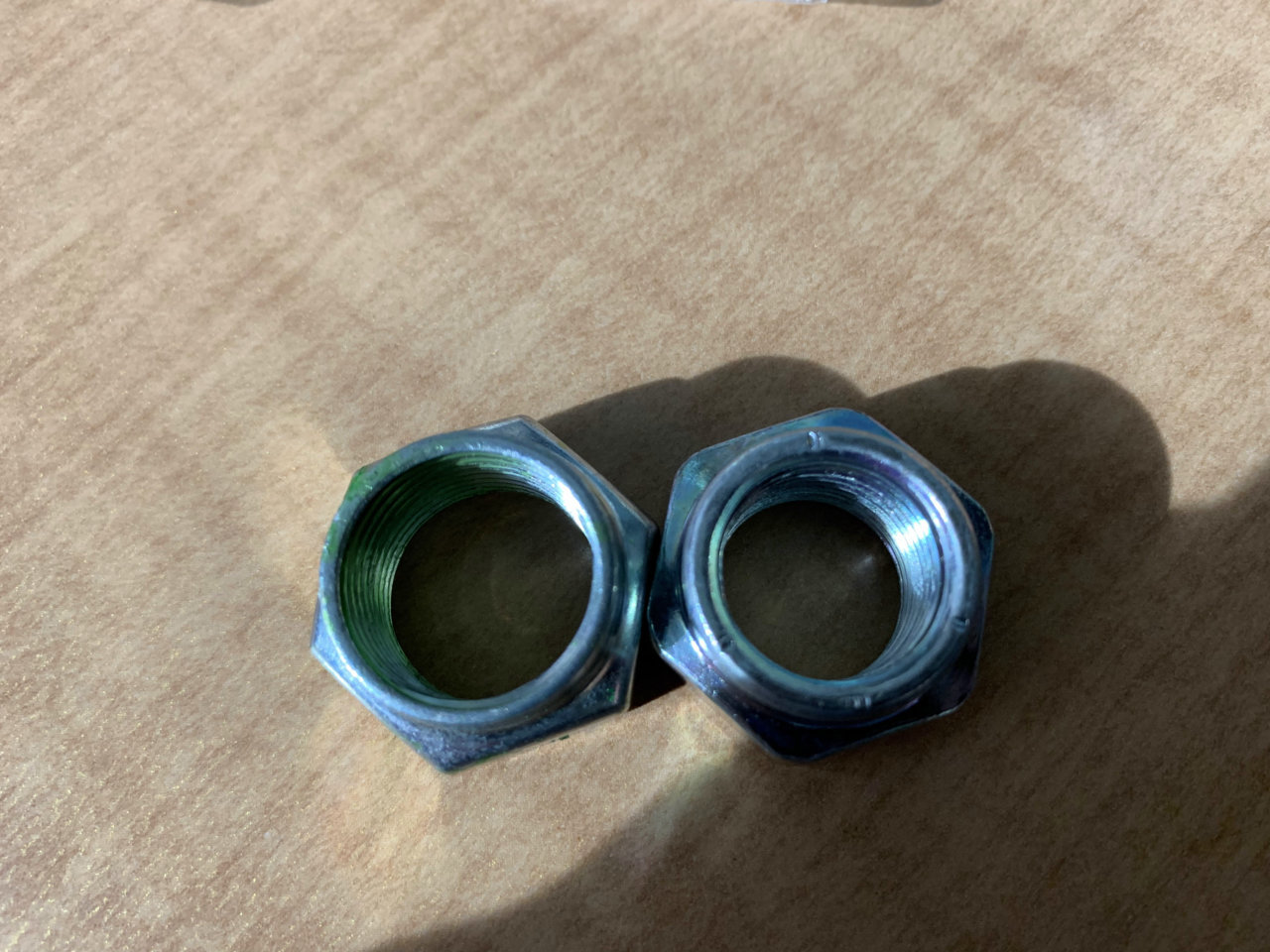

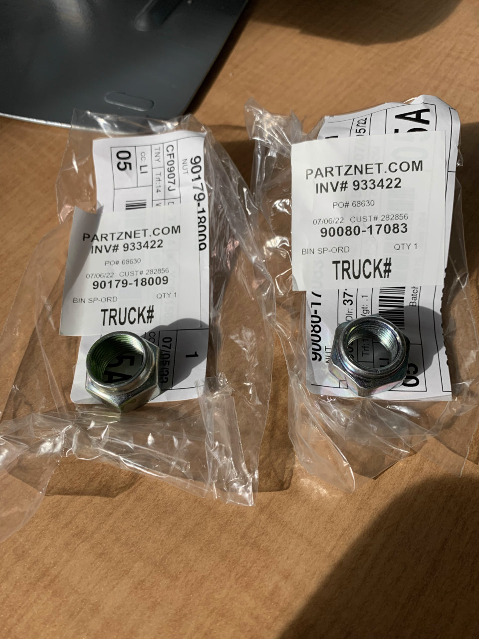

    So the part numbers I was given above did not come up as a fit for my truck, but it seems many of you have used that part number before. I looked up the part number in the schematic and got 90080-17083 listed for my truck instead. I figure they are cheap enough, why not get both for a side by side comparison?
    The part number that is actually listed for my truck looks like it is going to be much more difficult to stake. And the part I took off the truck looks much more like the part number everyone else provided, at least by memory.

    A quick look on Beaver Toyota's site shows the 9017918009 is for a 1st gen and 9008017083 is for a 2nd gen.
    I have not compared the two nuts, only reporting what I read on their site.
