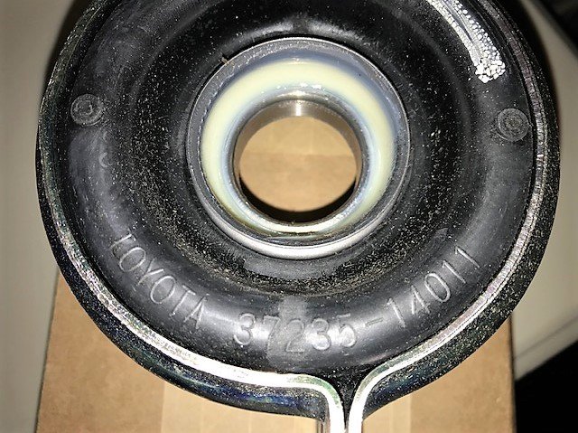

    The SPICER 25-211750-1X center bearing (CB) you show is a slightly different design than the SPICER 211750-1X CB sold on Amazon and at Summit. The SPICER 211750-1X bearing I received from Summit a couple months back is marked "TOYOTA 37235-14011", the plain brown box is marked "JAPAN" on the label, and the CB does not have the hangers on it like yours. Neither did the original OEM CB that I replaced on my '97 V6 Taco 4x4 X-Cab LB which was marked "TOYOTA 37235-35030".
    SPICER 211750-1X Center Bearing purchased from Summit in Aug-Sept/2022:

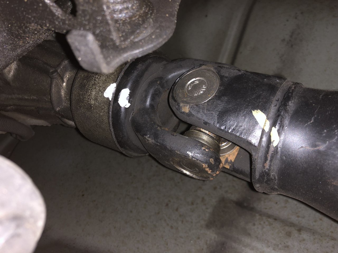

    The front end of my drive shaft does not have a flange and bolts. See pic. I'll continue tomorrow. Should this come free and reinstall easily? Or is it worth using any particular cleaner or lube on it when it's free? I saw reference that this is a spline.
    The paint mark on the right was already there and looks useless to me. The spackle marks on the left are mine.
    The connection by the carrier bearing does have the 4 bolts and flanges, and I got the bolts loose and the flanges marked.

    Have a plug handy when you pull the shaft from the transmission. Might have some oil leakage. See attached for CB removal/install.
