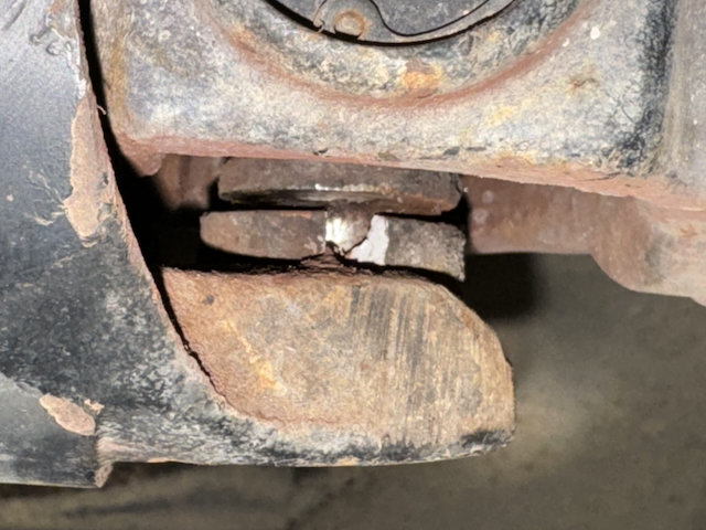

    Went back to grease the U-joints and Cardan joint. Did the front, did the rear. Wasn’t sure how much to add to rear yoke but stopped after I shoved so much grease in that the rear shaft started to be pushed forward. Hmm.
    I skipped the Cardan joint, because what had not realized earlier is that it’s TOAST. Even without being disconnected it flops around and makes a little sound very reminiscent of what we hear when driving. Gotta be where the vibration is coming from.

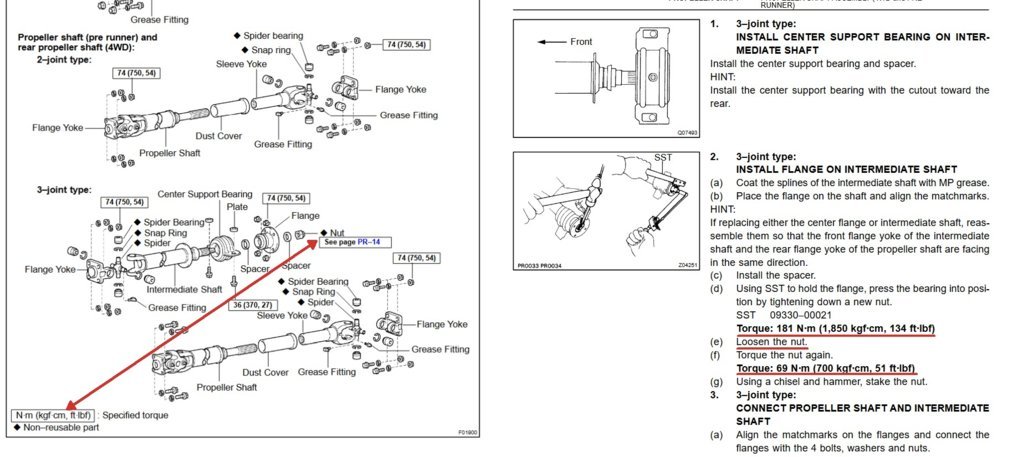

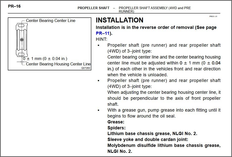

    Great write up. This isn’t a difficult job to accomplish, but there’s a couple details that can get missed and you did a great job of detailing every step! I cross referenced this thread for torque specs and it made the job a bit quicker.

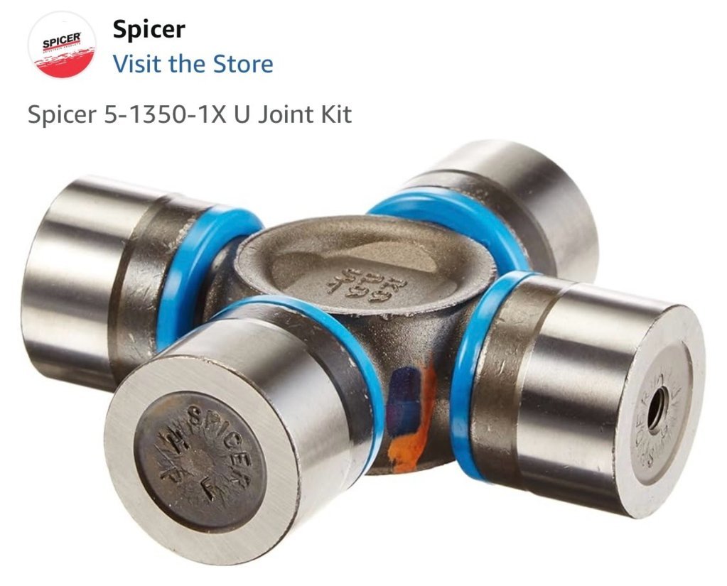

    This Spicer u joint is my preferred because the zerk fitting is on a cap making it a lot easier to lube.
    Spicer 5-1350-1X U Joint Kit
