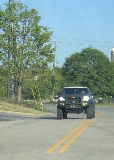

    I know my tires where /----\ pointed at each other direction of travel, my alignment was way out from off-roading then eyeballing it and having pretty severe toe in.
    You can see how my nose is picked up and my front's have negative camber from this picture another member took coming into a meet up.
    Surprisingly the VSC had no problems with that unless I was like I said before maintaining a moderate on ramp turn at speed, and more specifically when the road was at a small down grade/hill.
