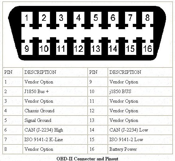

    No worries, have you tried the 4 and 12 pins? Do you currently have an error or just prepping? Here is your pinout

    I haven't tried it yet. Looking to do my suspension swap in a week or two. Don't want to try it now and accidentally make things worse until everything is swapped in and my alignment is done.
