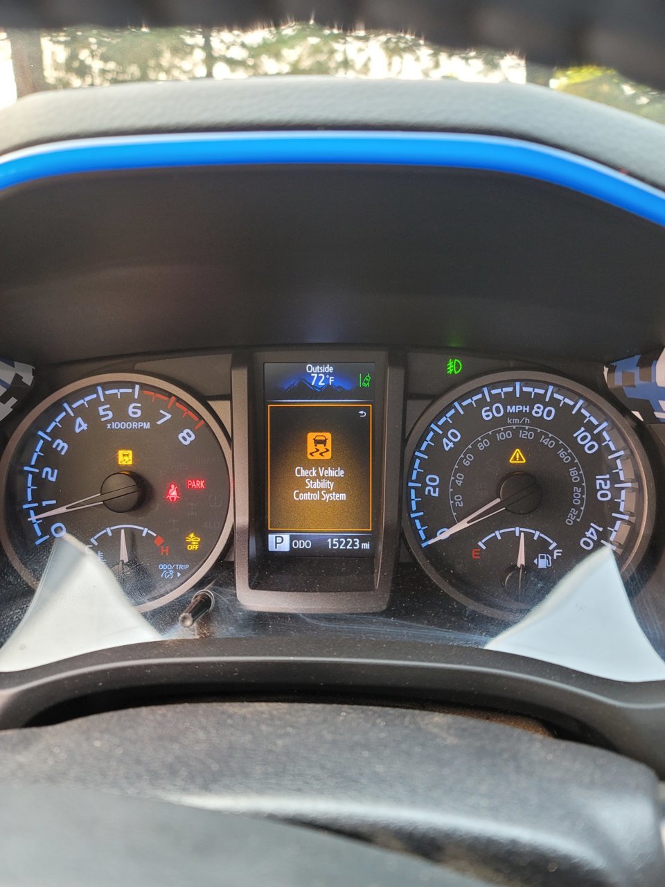

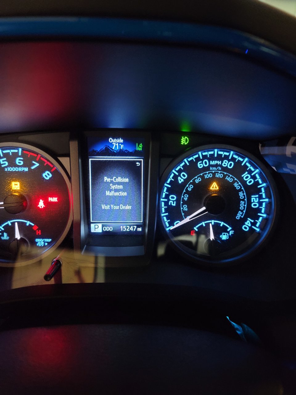

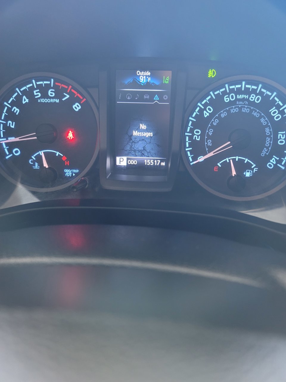

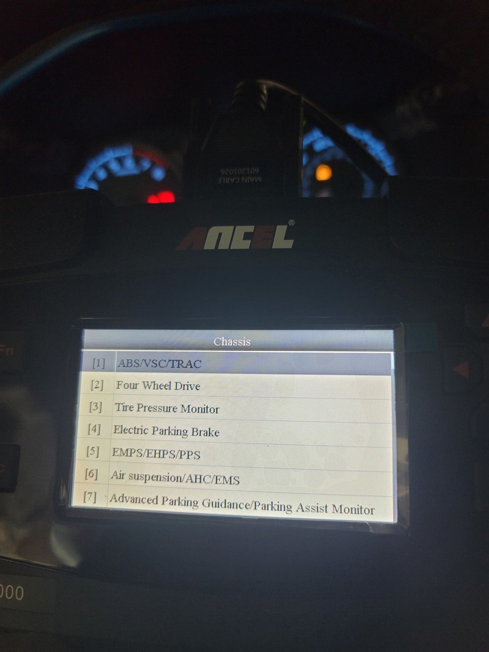

    I have tried The paperclip method and does not work for 2019 because of different configuration of the obd2 pins.
    Edit: Tried several times and no success. Went to auto repair shop and their asking for $140 for diagnose and zero calibration for the vcs and adjusting the pcs. Estimate $200-$400.. I went to 4 different shops all asking about the same price range. Even if I told them I just needed to clear the codes because the tire shop somehow activated and not able to clear it and doesn't have the scanner to clear it.
    Anyways, long story short. I got this scanner from Amazon and it worked. Cleared bot VCS and PCV (pre-collision system malfunction).. And all is well. It's a keeper incase other codes pops up. TPMS as well..
    Edit: after 200+ miles. No warning lights..
    Hope this helps!
    ANCEL FX4000 Plus All System OBD2 Scanner Car Diagnostic Scan Tool for Check Engine ABS SRS Transmission with ABS Bleeding EPB Oil Reset https://www.amazon.com/dp/B08ZHYK8PM?_encoding=UTF8

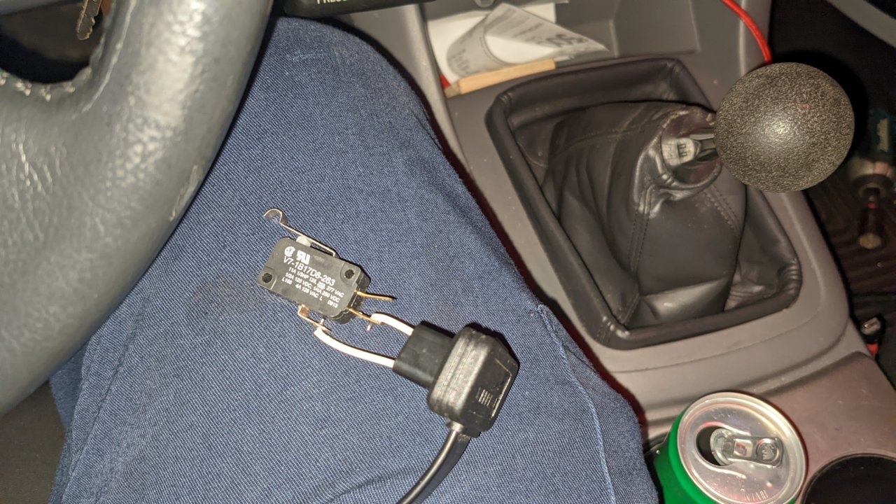

    The procedure described in the OP worked great for my 2013 DCLB. Driving for several miles on soft beach sand in 4H set off the slip warning light which totally disabled the VSC functions. Only the slip indicator light was on, not the ABS. The light remained illuminated for over 300 miles back on sold ground without resetting itself.
    I wonder if I should have turned TRAC OFF before hitting the sand, there's really no benefit to have the VSC cut the power to the wheels while sliding on the sand. That would only kill momentum and make it more likely that I get stuck in the deeper stuff. Does anyone know if turning TRAC OFF before spinning tires will prevent the slip system from throwing an error? I think the VSC automatically kicks back in above 40mph?
    I was able to reset and recalibrate the system back in my driveway in less than 5 minutes since I happen to keep a toggle switch in my glove box. Cheers and thanks for the great guide!

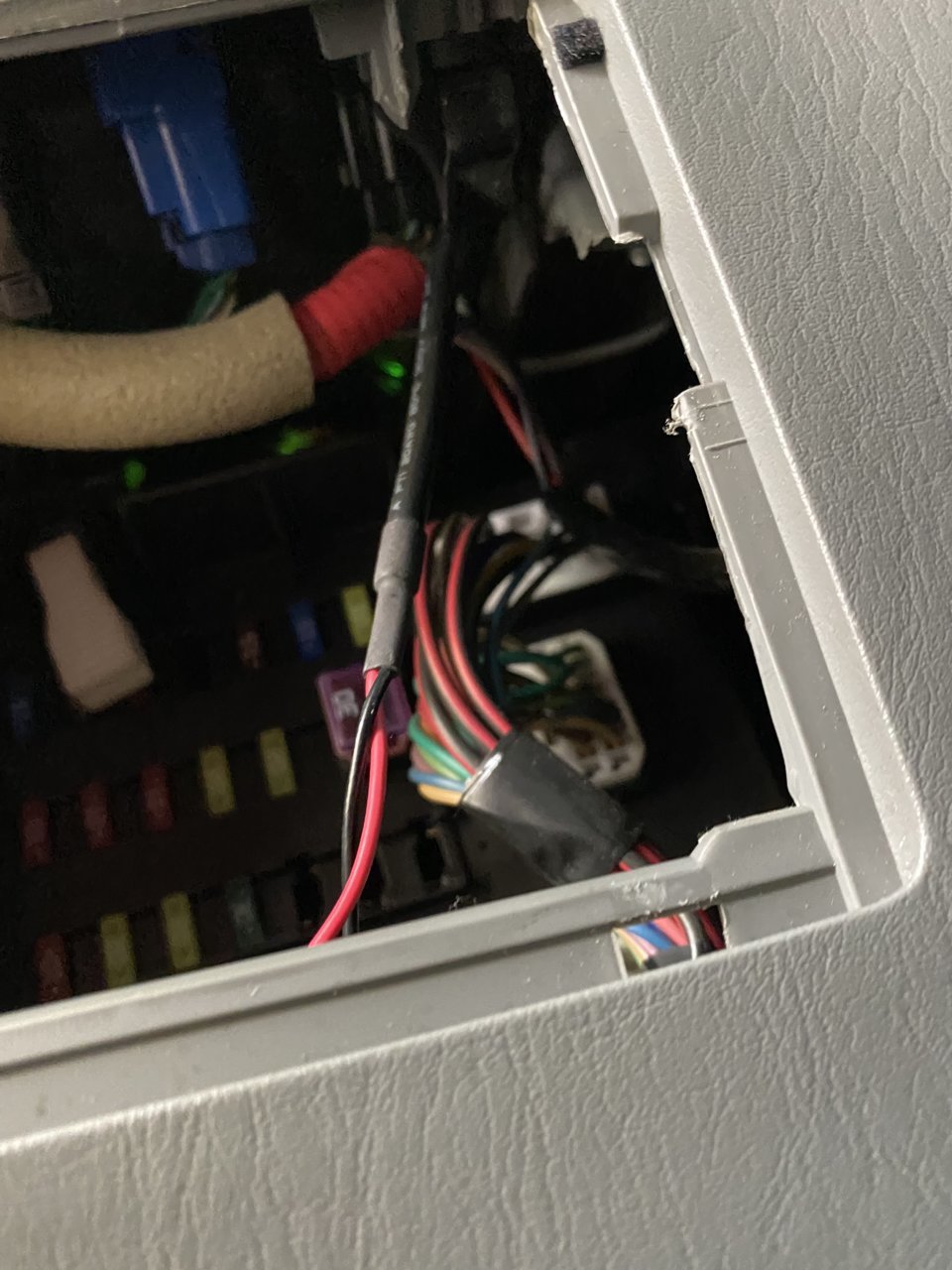

    is this what I’m looking at here?!
    002771EC-D9AE-47BC-A02B-955B0D973E65.jpg A6141C04-CE3E-4DB8-8C4D-C293261EA11A.jpg Came out to do the reset this morning and now, i am confused. I don’t think there is an aftermarket alarm on this vehicle, but i know nothing of electrical work.

    Oh wow. Yes that seems much more that what I experienced, but by the gauge of those wires you may have something else attached.
    If you happen to be the 2nd owner of the truck I would definitely reach out to the original owner. I doubt dealerships will install something like that, but you never know.
    Sorry I'm not of much help. I don't want to tell you to unplug the assembly and something else happens. Hopefully someone with more electrical experience can chime in.

    The white plug is OEM, whatever is attached to is is some kind of OBD reader, ECU changer type deal. Maybe Pedal Commander or an Ultragauge?

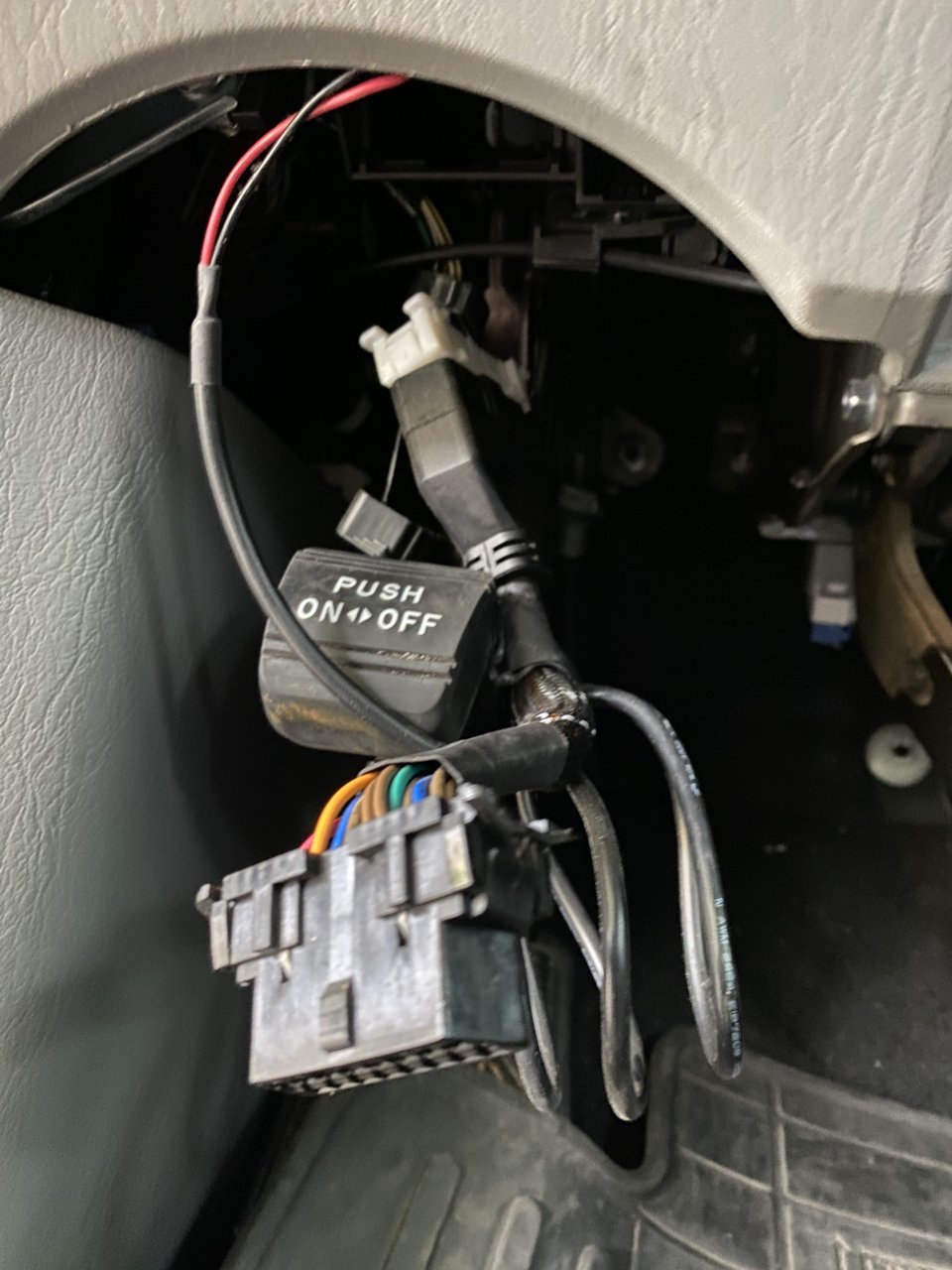

    Trying to use the paperclip/jumper/cheap "try me" button and tucking under the dash I could never seem to get things right so I finally caved and got an OBDII port extension cable and used a little micro switch which I soldered some solid copper leads to to make my jumper switch with little yellow match marks on pins 4 and 12.
    Figured I mess with my suspension and stuff enough that it's worth it.
    Forgot to reset after installing the Archive Garage Hammer Hangers so I'll have to see how the truck plays now after the reset/relearn.
    Switch works like a charm.
