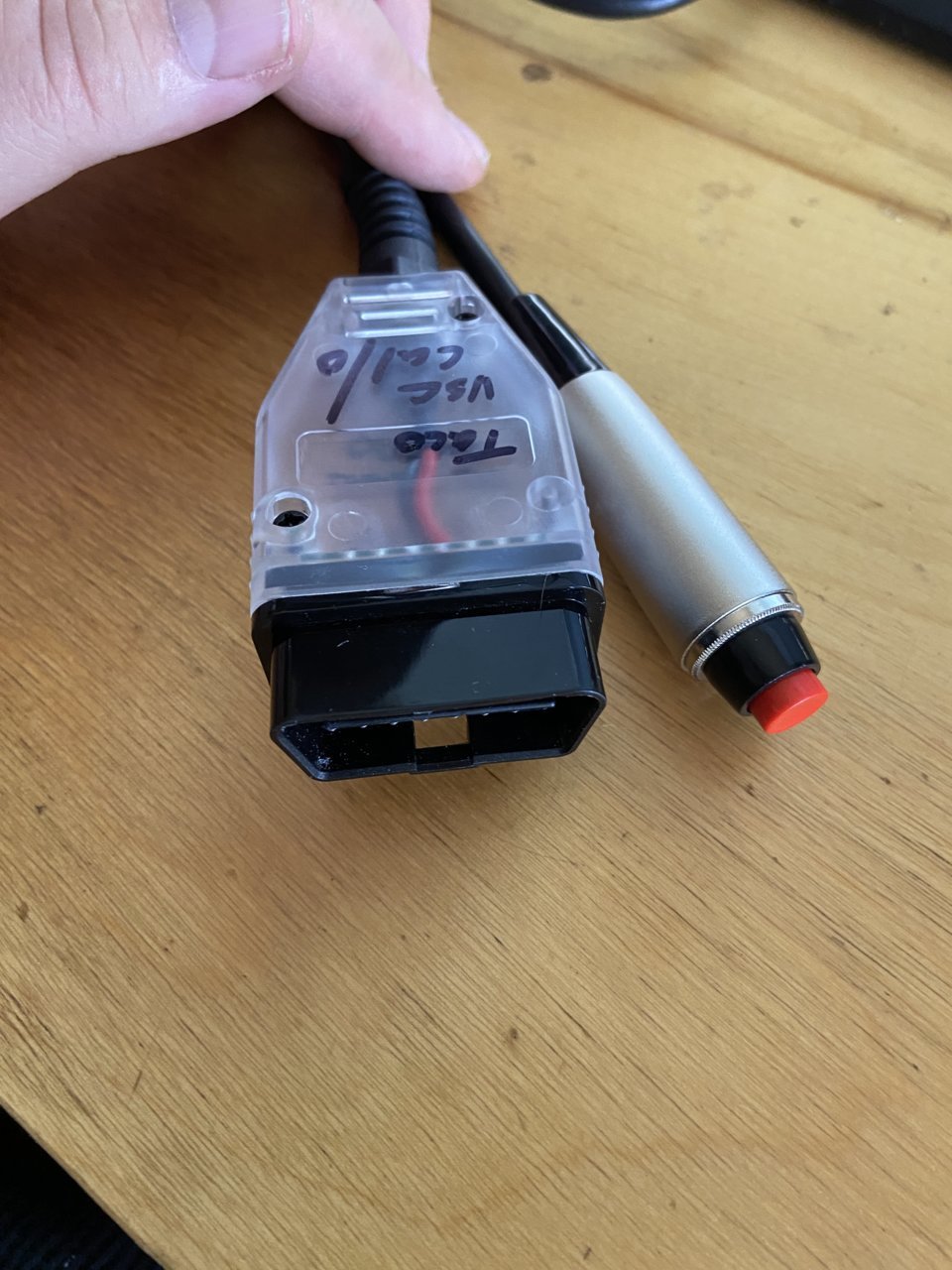

    Pretty easy to construct, just finished assembling and tested on my bench. I will be trying on my truck soon as I just got all new rear suspension and the alignment completely goofed the VSC cal.
    I may even do a video showing it working and the process.
