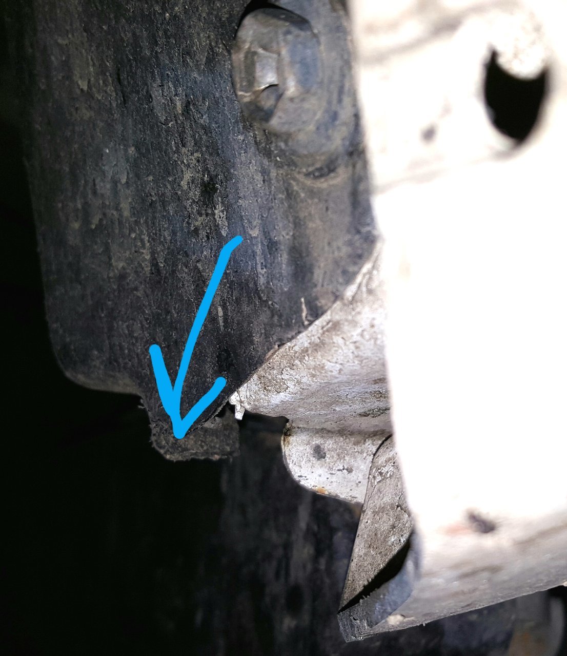

    So what I thought was my VSC kicking in was some minor rubbing. Sounded a little like ABS but quieter.[​IMG]
    Turns out I have NOT successfully reset the VSC after three tries. Turning onto 880 from 580 ramp yesterday scared the heck out of me. Much louder than ABS and jerked the wheel hard. Not scary but startling. No other cars around but I could see if it was a two lane road with oncoming traffic it could have been bad. Each time I reset I think I made an error , like the truck wasn't level, the dog jumped out of the truck when the 2 second reset happens, etc. Going to try again soon, and keep both hands high up on the wheel gripping hard on those sweeping turns. Should I turn off VSC manually til then?

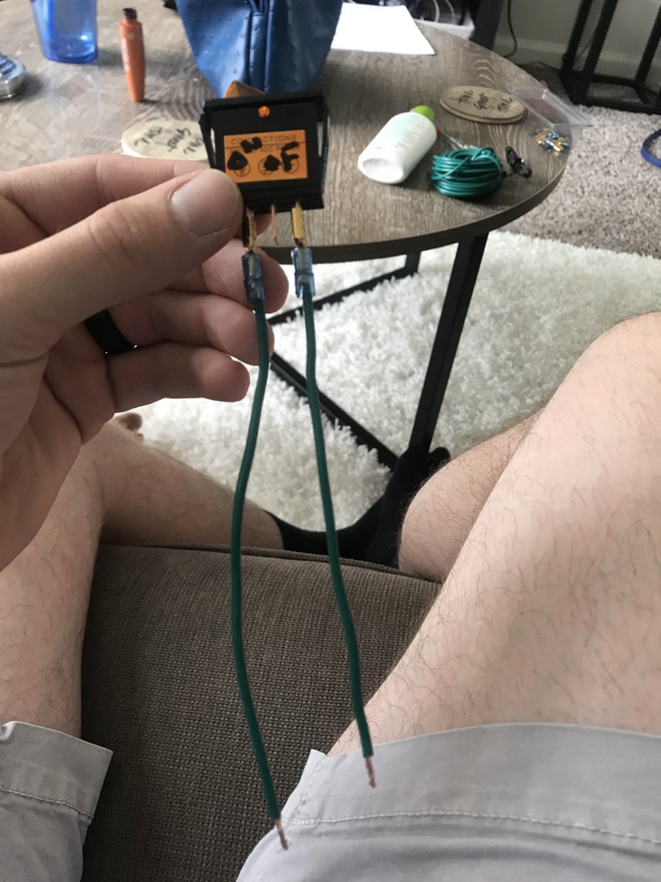

    i used hard wire (probably 14 guage)
    i can get the two lights to start blinking but when i turn the key off then back on, they just flicker twice and then remain illuminated
