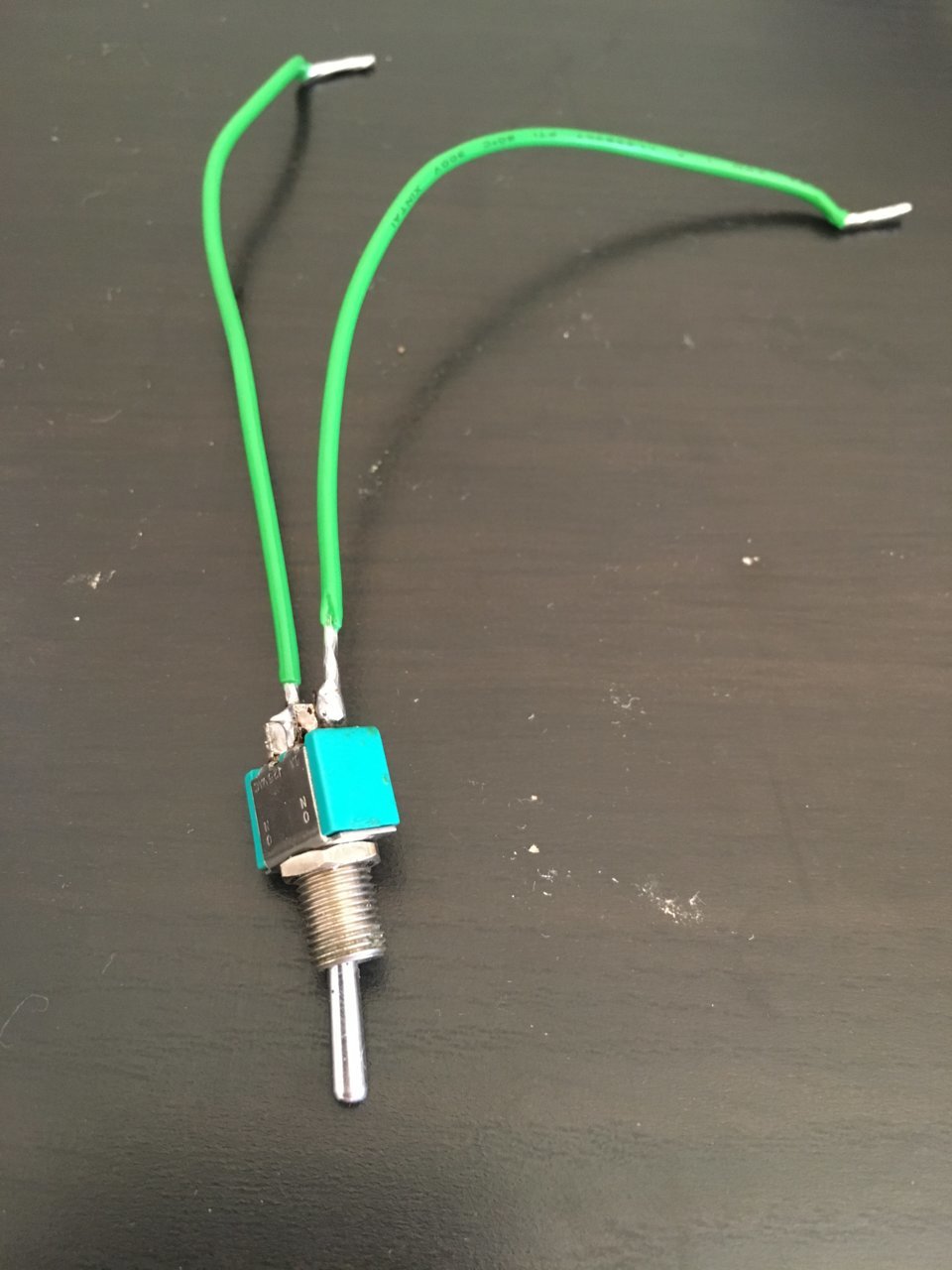

    Like others on this thread, the first time I tried the reset process I could only get the ABS light to flash. This was likely due to the fact I could not short out the pins fast enough because once my husband made me a switch, it worked like a charm and the calibration was complete after my first attempt.

    How, exactly, do you short those pins out 4 times in 8 seconds?

    It was pretty easy. I used a short piece of safety wire and bent it into a U shape. 8 seconds is a pretty long time to short the pins out 4 times. I pushed the wire or you can use a paper clip in and then I saw the lights flash. Make sure you follow the steps. I forgot to turn the key on the first time.
    This corrected my traction control issues. Before doing it, it was horrible to drive.

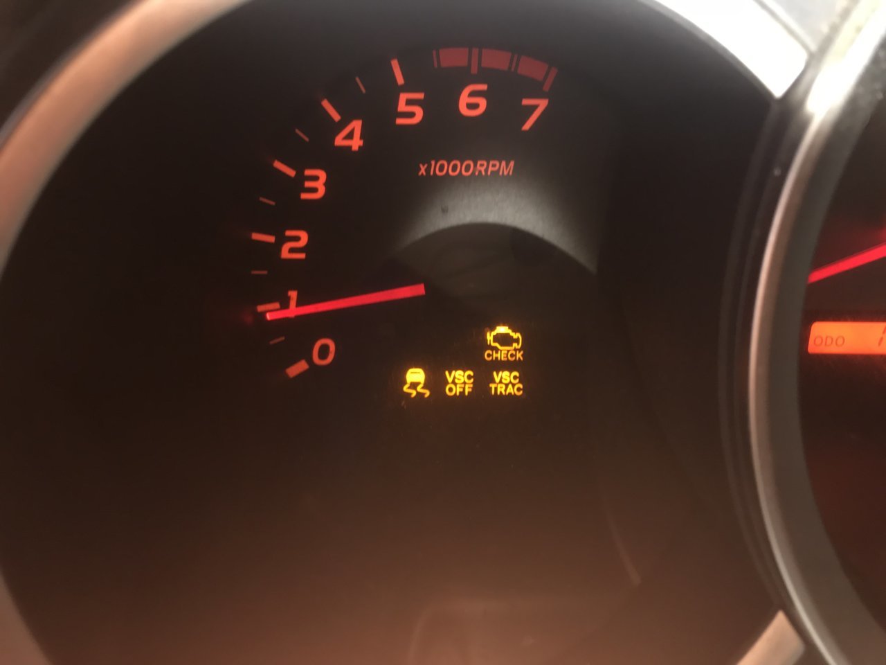

    I severely jacked my alignment wheeling back in August. Fiddled with it myself last weekend and made it slightly better. Noticed the VSC light came on Monday afternoon, don't remember the situation, it's just on and stayed on.
    Need to do some more tweaking of the front, get it back in the right numbers, and then try the wire jump again.
