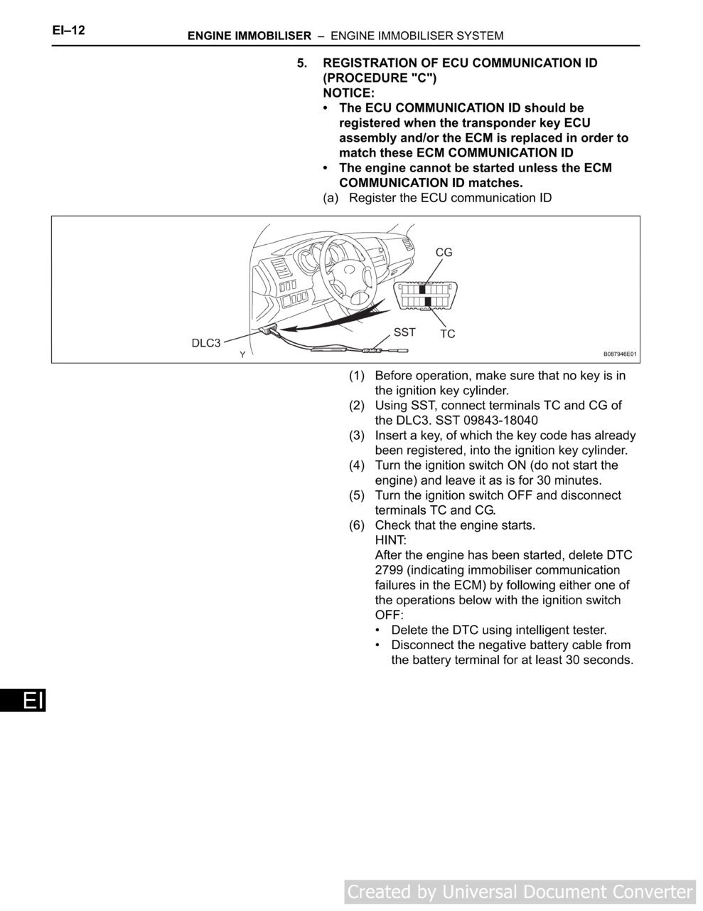

    Was told to use paper clip and sit for thirty min

    Your referring to the immobilizer resync on a replacement PCM?

    That's for synchronizing the Immobilizer ECU w/ the Engine ECU.
