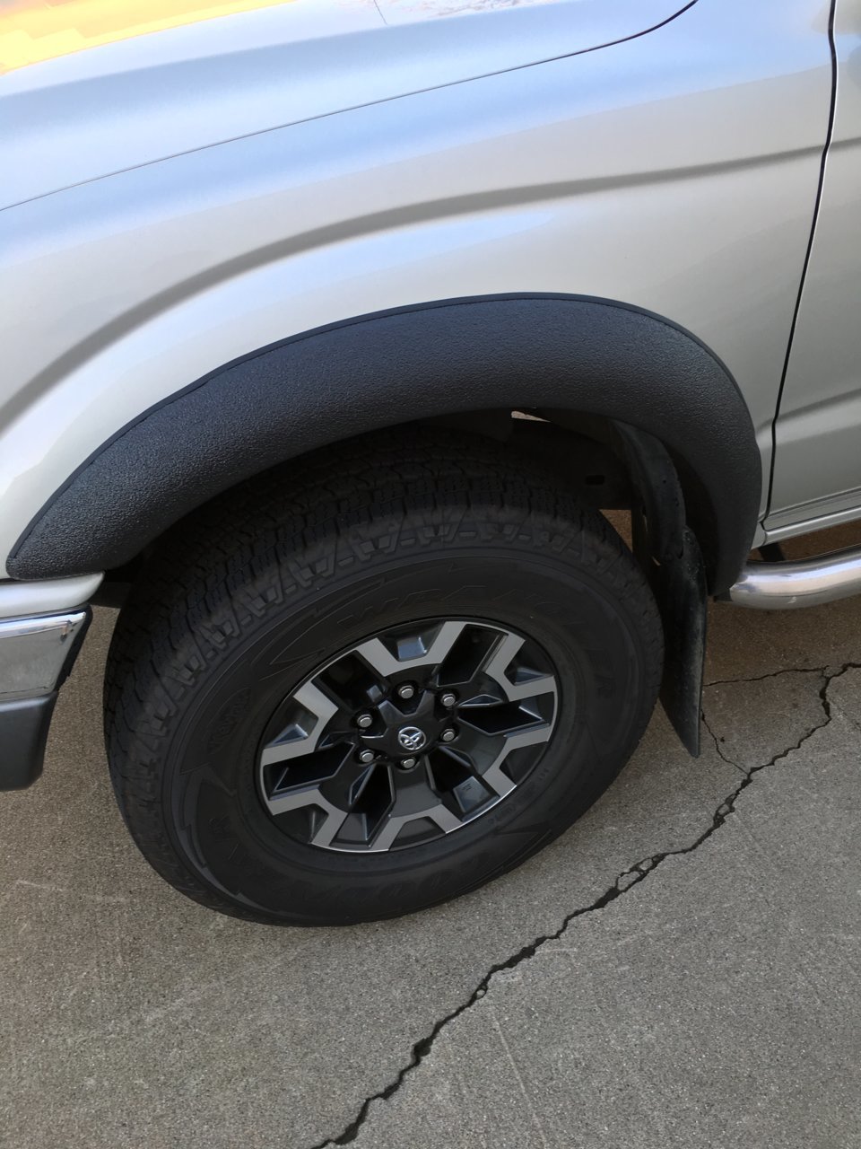

    Hey look I managed to forget again. Sorry. Lol but here’s what the came out like with the duplicolor bed liner. The plastic on top of the front bumper is new.. everything’s just dusty so it looks a little light...
    The texture is pretty decent too.

    Where did you purchase that bed liner to spray on your fender flares. I just got the Plastidip, hopefully it comes out good like yours.
