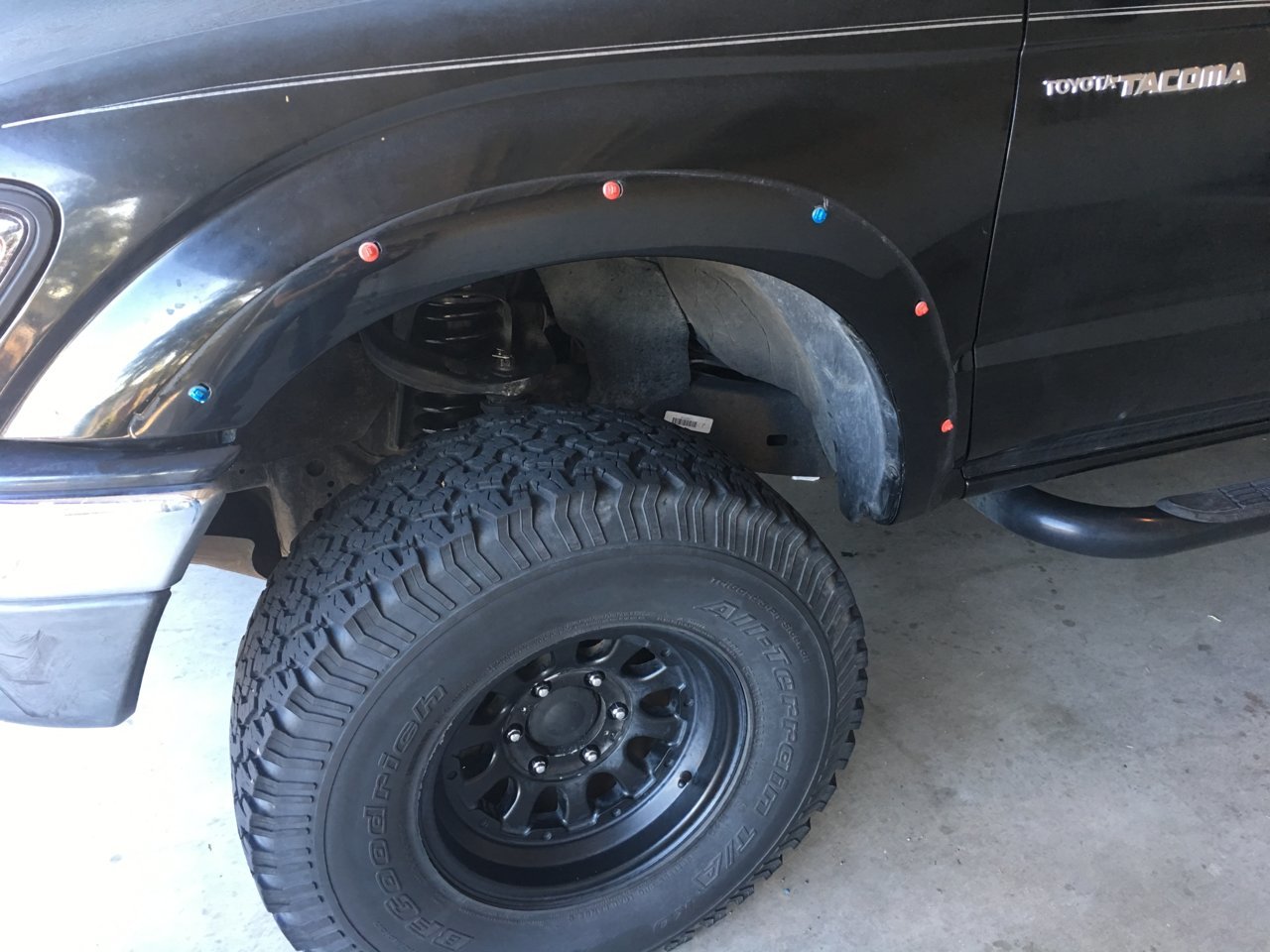

    Hopefully you kept track of where the red and blue ones went when you took the flairs off originally, those do go in specific locations, but I couldn't tell you off the top of my head where...
    I think I ended up popping the clips in the flairs first. The holes on the sheet metal are bigger so you don't have to be as precise when pushing them in.

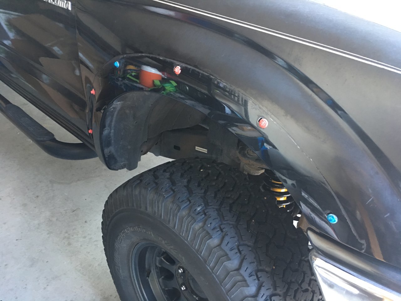

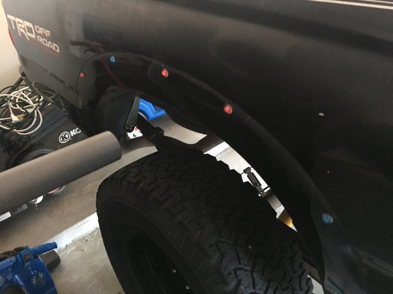

    Gotcha. Before removing the clips I took a quick picture of there placement.

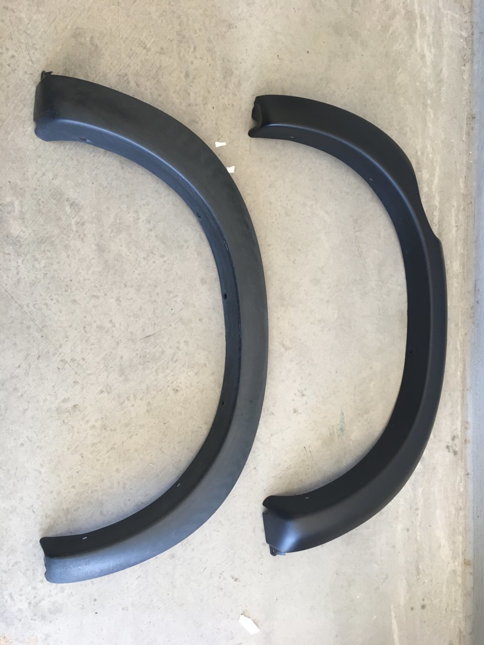

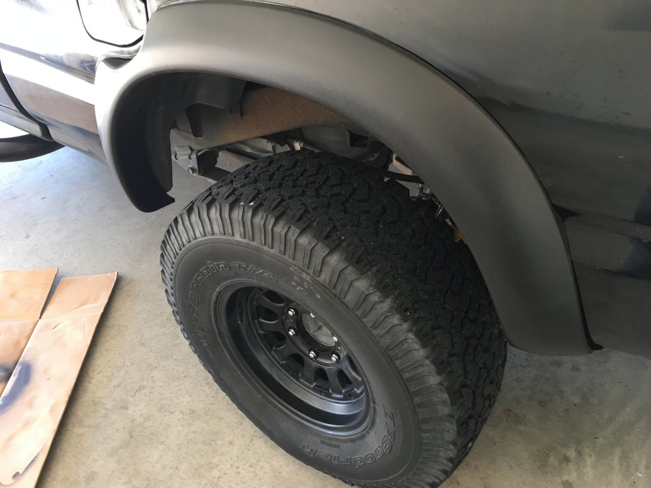

    Here are some pictures on how my fender flare s came out.

    What painting option did you go with? I like your results. I’m getting ready to do flares, bumpers, Morris, wipers and door handles all at once.

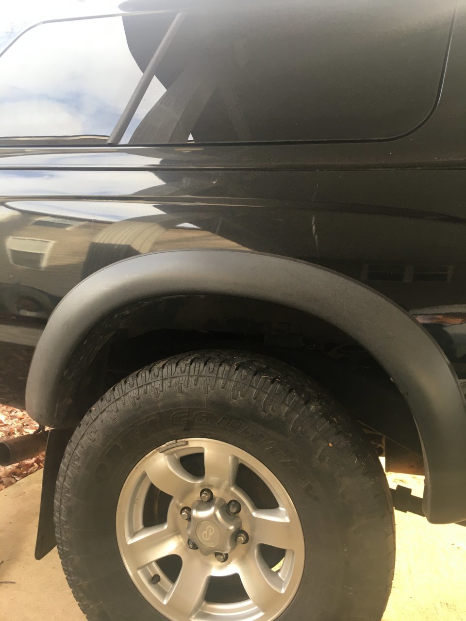

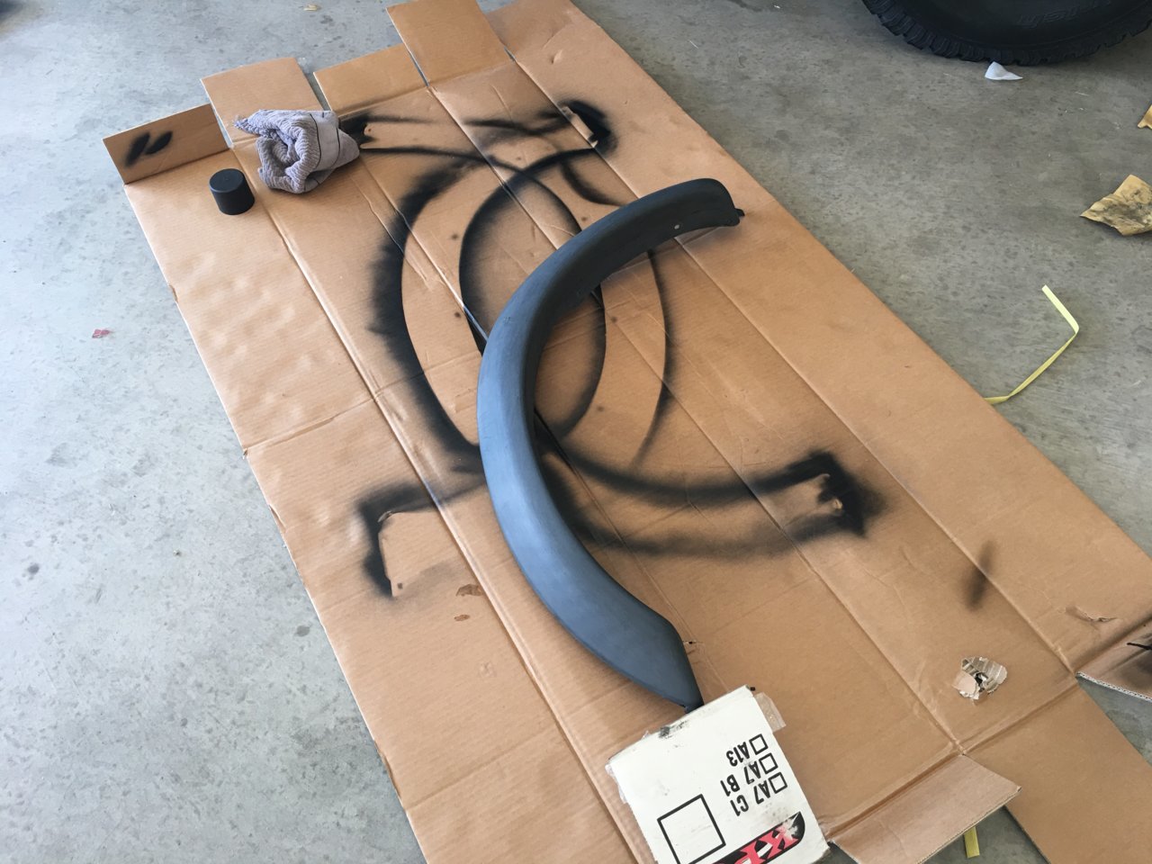

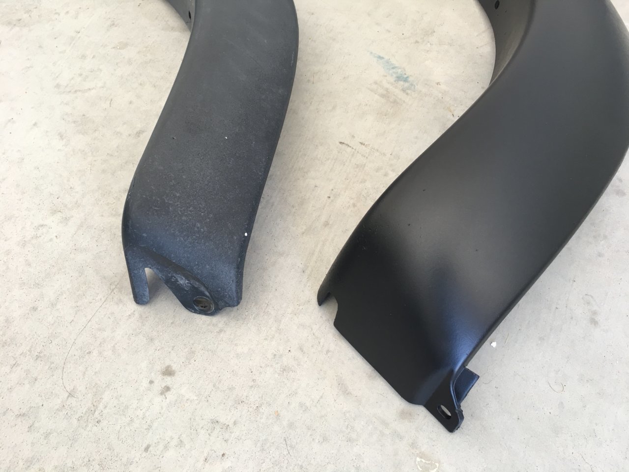

    Bumping this thread for anyone considering spending their money on a product by the name of “that black stuff”.
    I tried to use it on my black plastic flares and it did nothing but ruin a microfiber rag. Don’t waste your money.
    My friend recommended a plastic resurfacer by eastwood and gave me a can of it. I taped my flares off and sprayed them with four light coats about 10 minutes apart. I’m satisfied with the results and would recommend this product.

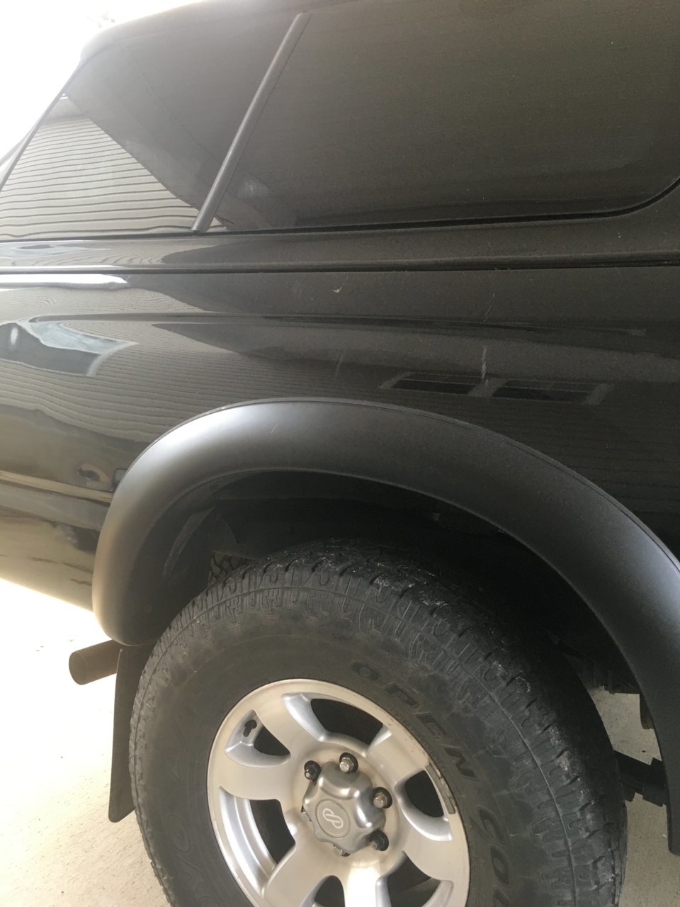

    Mine are the wide plastic ones. It’s a 2004 model. DE2FEEDD-8A5D-4664-AE1F-09854E50DFBB.jpg D0D4BA95-1154-426B-AABF-1B84636C4DFD.jpg Here’s some before and after pictures.

    It looks great! Nice job! :thumbsup:
