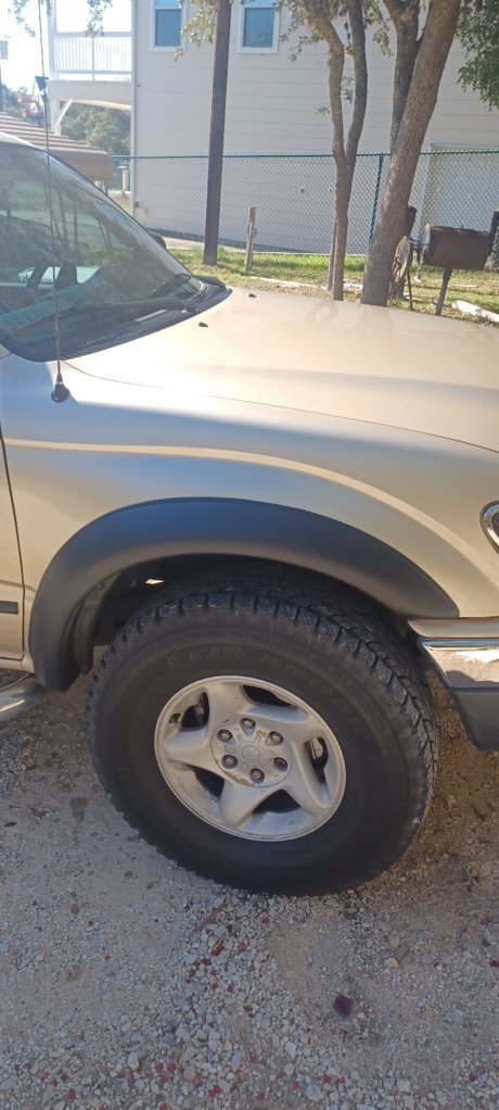

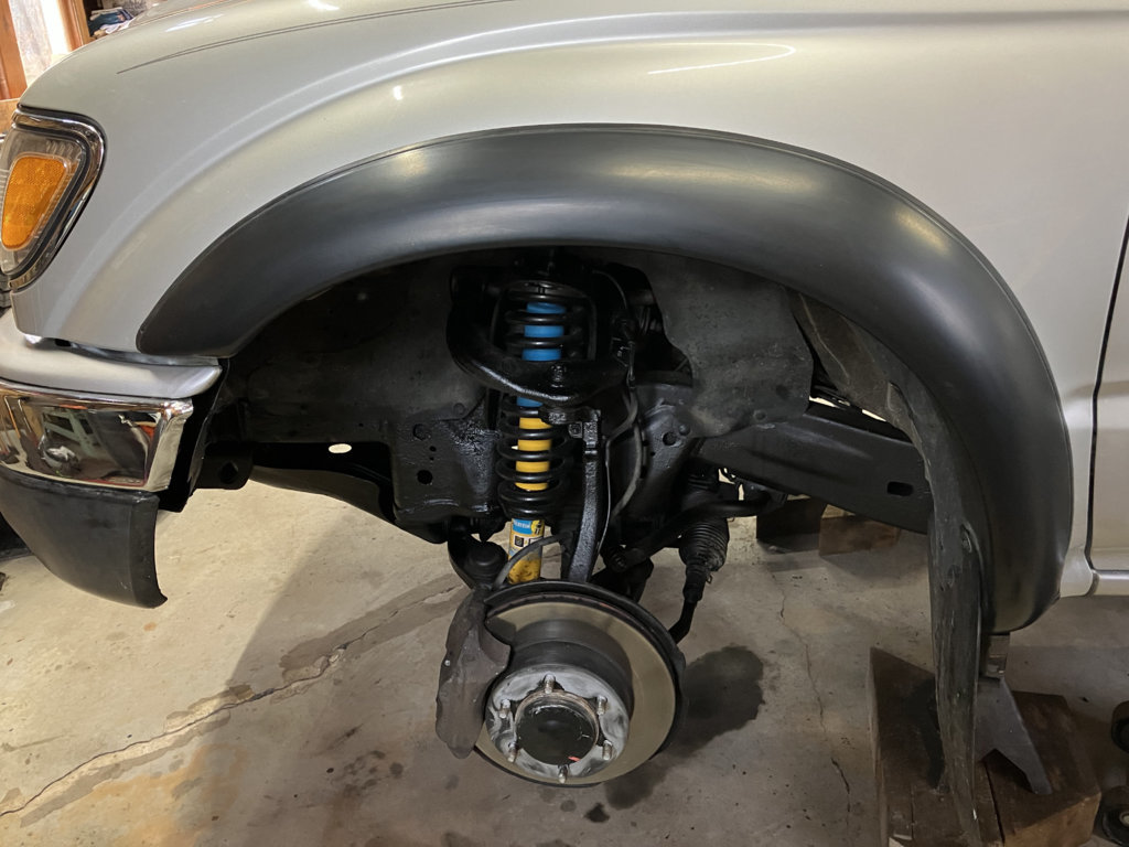

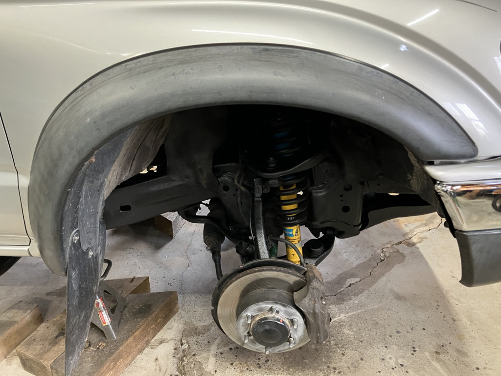

    I used Meguires black trim restore for years and it looks good for a week, but seemingly overtime turned to a gray haze. I was searching this thread this week and almost bought parts to remove and paint the flares. But then...
    Santa got me an early gift... dewalt rotary buffer. So today I thought, what the hell -- can't make them worse! I used Meguires 205 and 105 on a heavy cut buffer pad at 600 rpm. Very happy with results. Photos are left and right but the restored one was the same rubbish gray as the faded pass side in the images.
    I may paint them at some point, but this looks good for 15 minutes effort.
    Buffed
    PAss not buffed

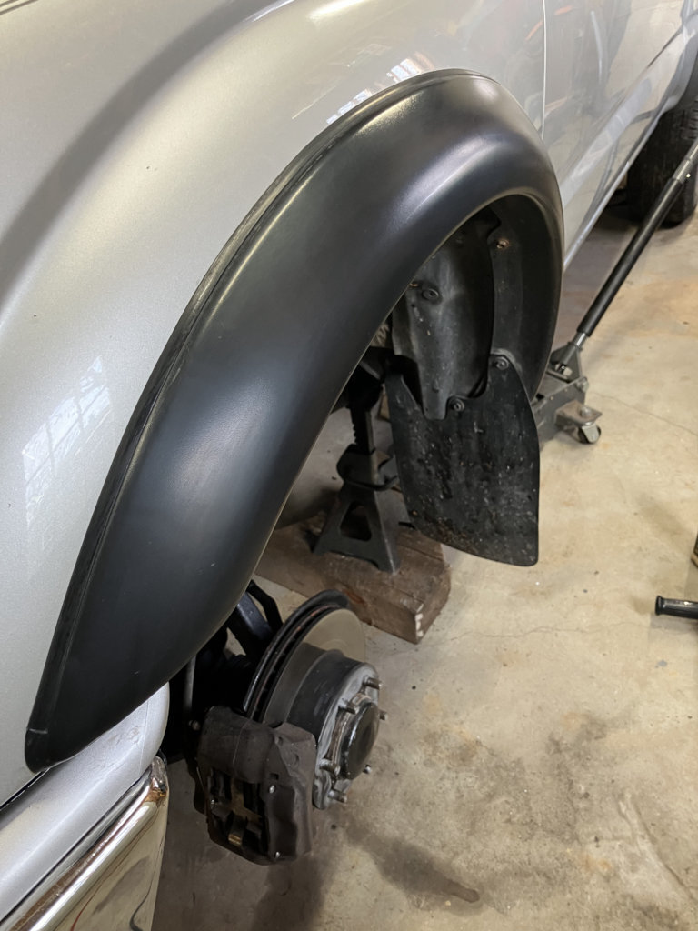

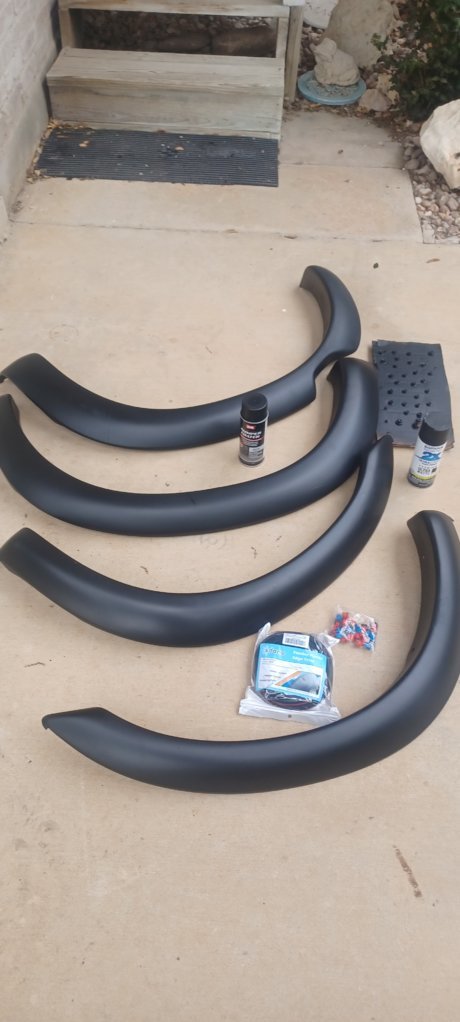

    Refurbished fender flares today. $65 (1) 12oz can SEM #39103 flexible black bumper coater, 30 ft Sdano fender edge trim, 30 pack fender clips -Amazon. Comet, green scouring pads, dawn soap had already. Power washed, removed, scrubbed w/comet alot and finished with dawn and heavy rinse. Dried, did 3 light coats. They look new. We will see about durability they were really really anemic looking. Gonna buff out truck paint while off. Might as well way less hassle. Posted this in what have done to your tacoma today thread last saturday.

    65 bucks ain't bad for proper refurb, that's $16.25 a wheel. I wasted that on shots at the bar with friends in 1 day. Lol

    Just outta curiosity how do you torch up to the rubber fender edging without roasting it or messing it up. I torched alot but it's all been stuff I removed or stuff I could get to, like a dirt bike plastic part.

    I got mine back on today

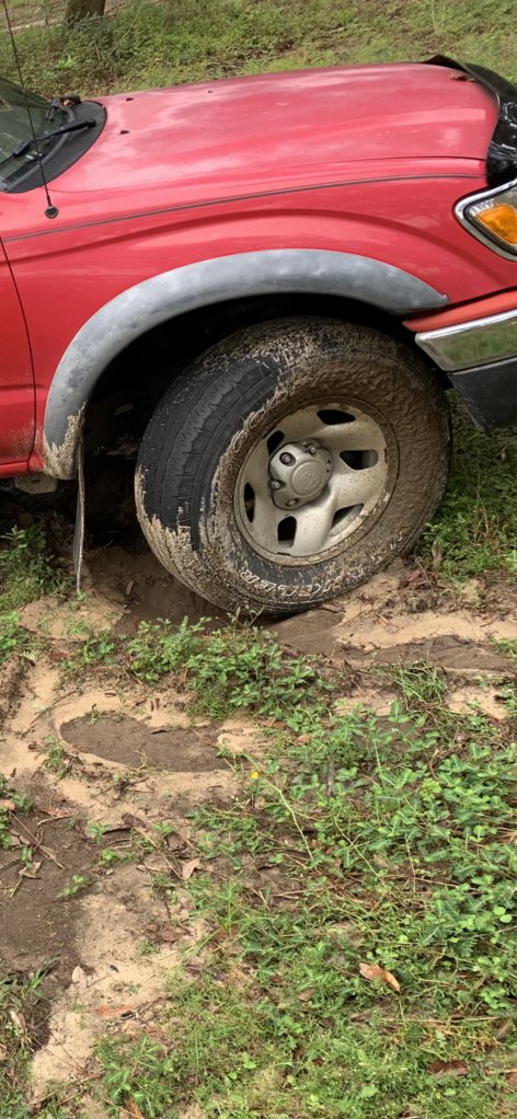

    4637F560-A0B7-4698-A770-6A3139215E2B.png E482AFEE-5B3E-4E56-ADCD-FE99944443F8.jpg Before and after (little over 4 weeks)
