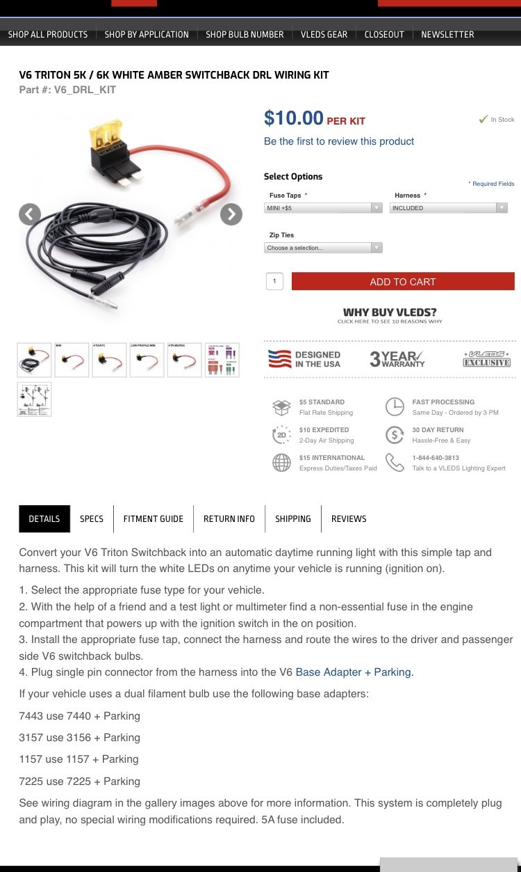

    Can get the same results with some Triton switchback bulbs 7443 or 7440 paired with a DRL wiring kit from VLEDS for $10 bucks it’s all plug n play no need for resistors or chopping connectors.

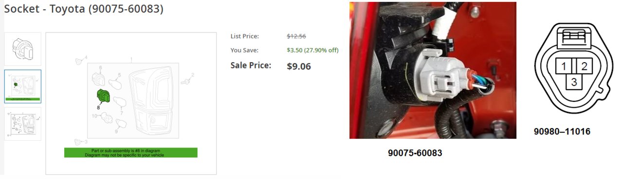

    So I found out that the rear Stop/Tail bulb socket (center one)
    fits into the Headlamp 2 pin Turn Signal socket.
    So one could de-pin the terminals from the Turn Signal connector and add the missing wire to a fused IGN source.
    Add a Switchback bulb ($35.00) and have the TURN signal white with DRL 's and Amber when turn selected.
