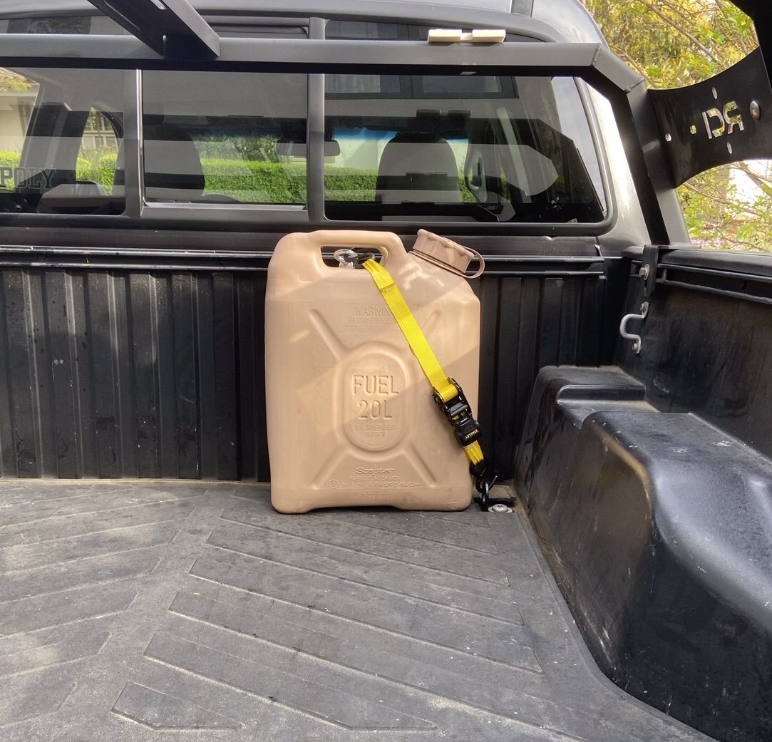

    This setup has been problem free for me for years, although they are the non-consumer type (MFC type available on eBay). 0’ to 11,000’ & over 100 degrees without any leaking. I have witnessed rotopax leaking.
    I’ve installed the aluminum flanges with viton gaskets & tie down with ratchet strap to bed rail & bed tiedown hook.

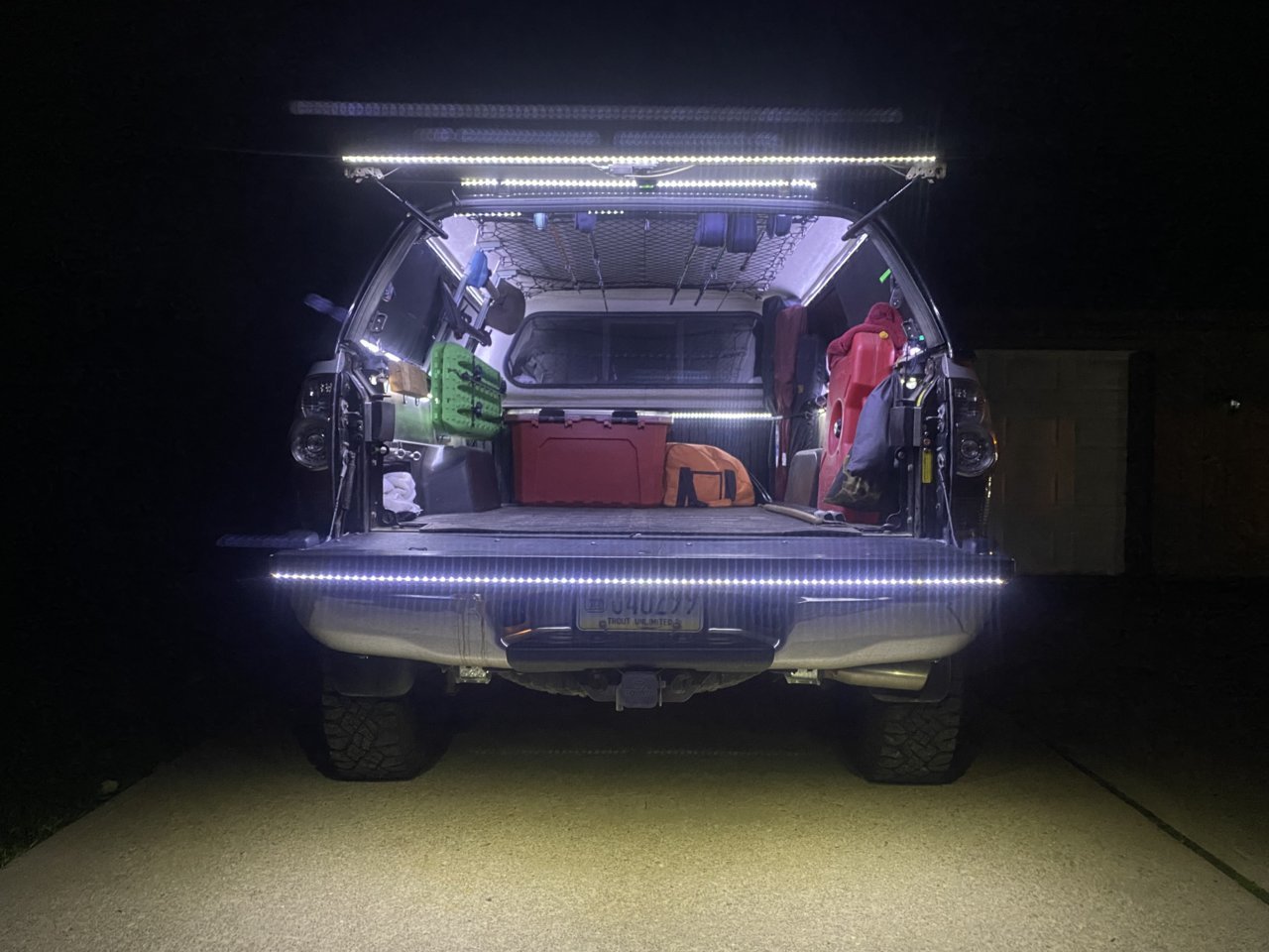

    i have a40 gallon fuel cell mounted in the rear of the bed easy to remove and tied into the fuel system.
    When not needed simple to remove easy access to fill with normal length Gas station hoses.
    I hate messing with cans since the spouts for the most suck.
