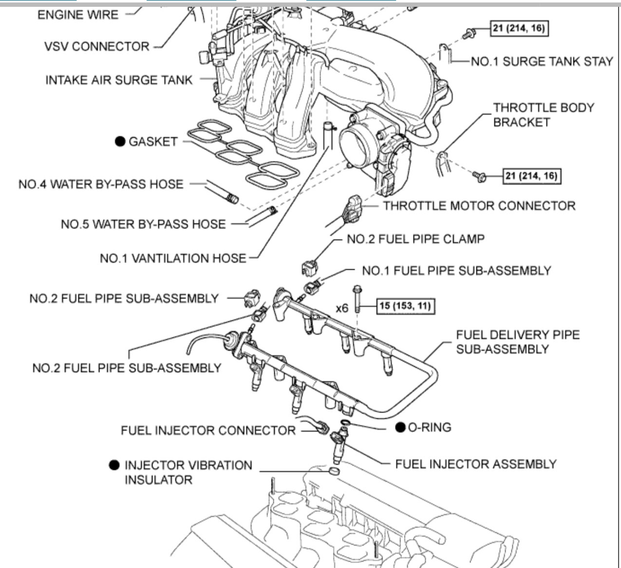

    Toyota says to use the No.1 Fuel pipe to check the pressure.
    I assume this would be fine to drain as well. Follow the line back in the diagram below.
    Drain from the most convenient location on No.1 fuel pipe?2C345EAD-FEC2-448E-8851-09838D2C700E.jpg

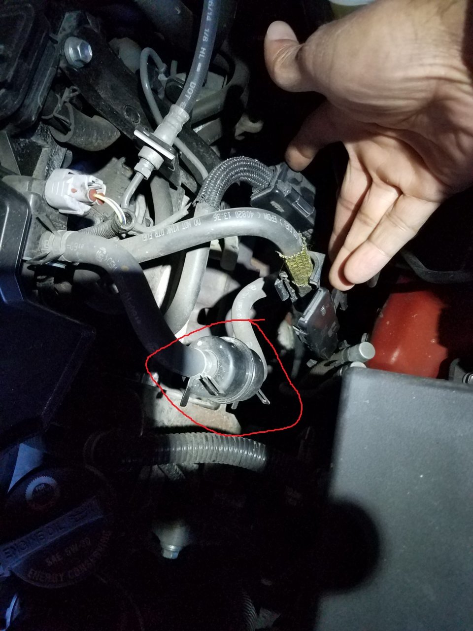

    '21 TRD OR 4x4 DCLB Super White
    Not enough bandwidth on the internet to list.
    I would think the hose with that secondary fuel filter inline would be your feed.

    If your referring to this that's the EVAP Purge line and muffler, 2nd gen Taco's don't have inline fuel filters.

    Thanks for the reply. I was particularly referring to boxes where my index and weirdly enough, where my middle finger is at ;) . Which one of those is my feed lines?

    I know I was replying to @GrizzledBastard He thought the part I circled was a fuel filter.

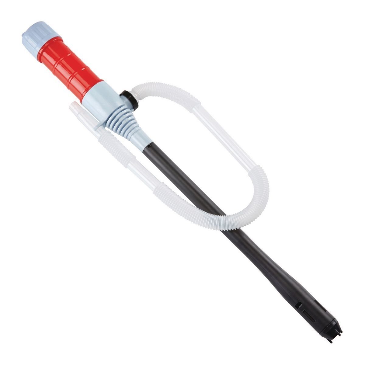

    Hmm . . . none as yet, that's why i'm here . . .
    upload_2022-2-22_20-23-7.jpg This from harbor freight
    Battery operated siphon
    Extend the end to reach bottom of tank
