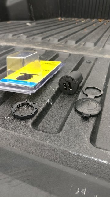

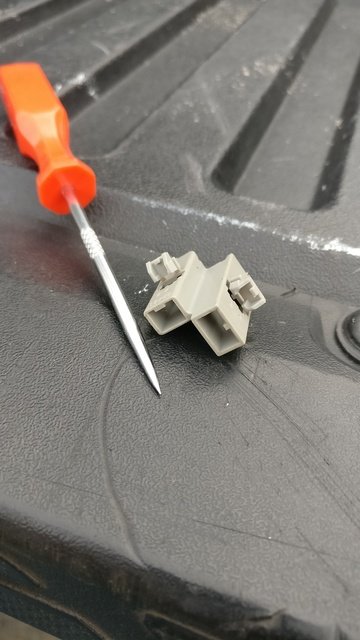

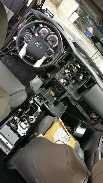

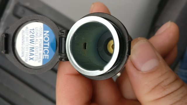

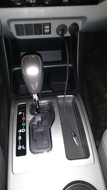

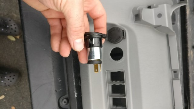

    I spent part of the day figuring out how to take my dash and panels off of my 15' Tacoma DCSB Sport. It's freaking ridiculous how difficult they made it just to get to the radio and those switches. Since it took me awhile to figure out how to pull everything apart I did not snap many pictures of the process and in turn decided not to mess with snapping pics of everything going back together. I'll do my best to explain the steps that are needed though, Enjoy!

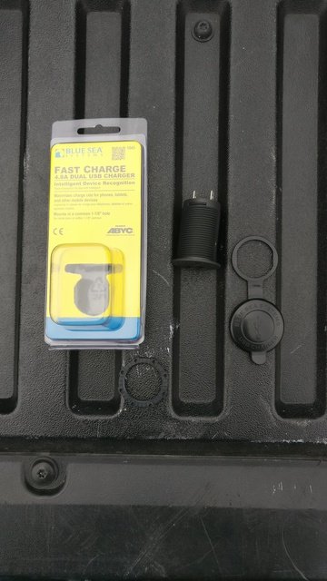

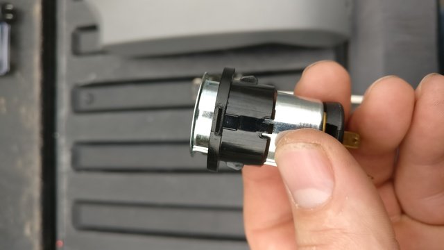

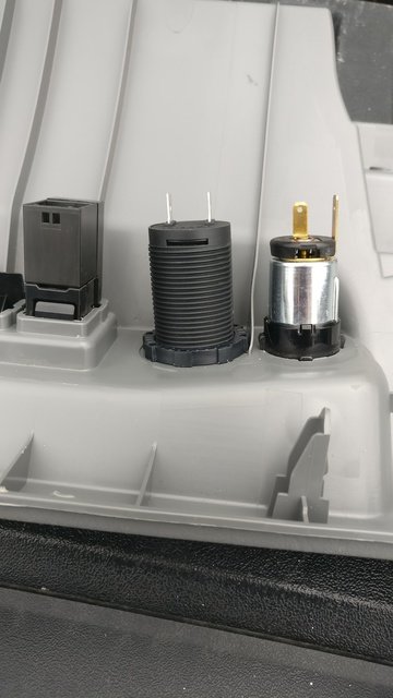

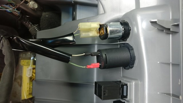

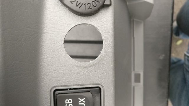

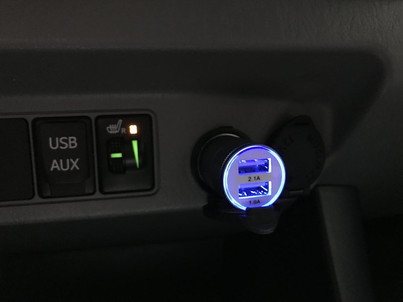

    I swapped out one of the 12v outlets for a Blue Sea dual USB flush mount outlet. It is designed strictly for charging and accepts 12/24v power. While I had everything pulled apart I went ahead and mounted up my Stream light and hard wired the charger to a switch so I can control when it is on or off.

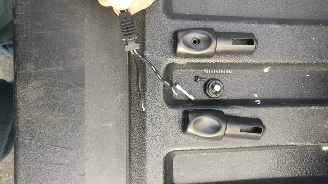

    You will need to remove, in close to this order - your left kick plate and kick panel, panel underneath your steering wheel, dash gauges bezel, shifter cover, cubby/center console compartment, climate controls, radio and bezel, glove compartment, lower panel below climate control (that houses the 12v and USB/Aux port). Once you have all of that removed you should be looking something like this. o_O

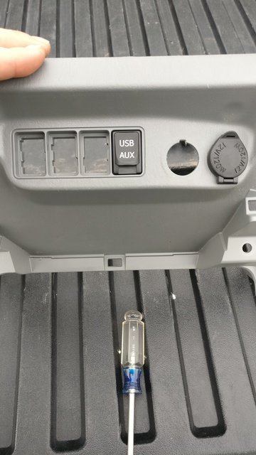

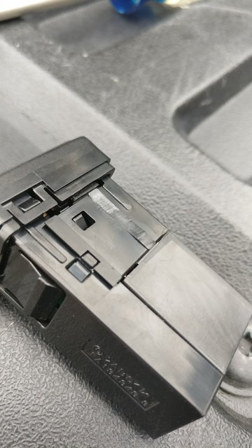

    Grab your panel with the 12v outlet, USB/Aux and whatever ports or switches you may already have. To remove the 12v you will see two small black tabs on the inside top and bottom, You will need to press one of them to get it started and then press the other one to finish separating the center tube from the outer housing. Once you have the center tube removed you will find two tabs on the back housing that need to be pressed to get it out of the panel.

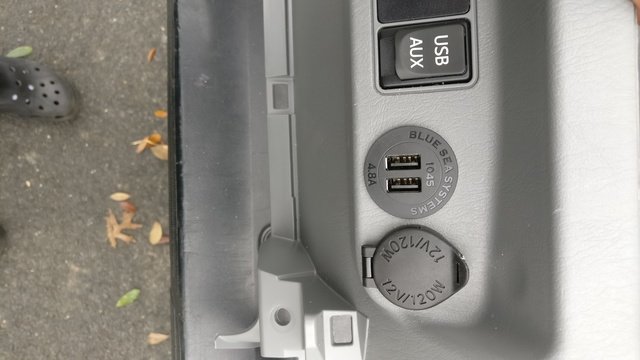

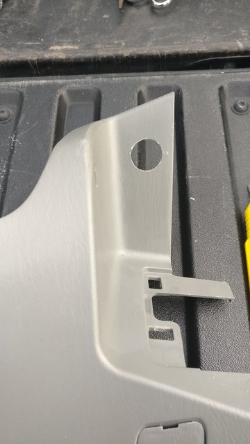

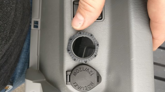

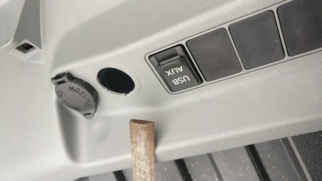

    The hole required for the Blue Seas part is 1 1/8", I simply used a 6" half round file and worked the hole as even as possible. You will basically need to take away enough material to remove the notch (all the way around). I test fit the part every few rounds I made with the file until it fit snugly all the way through the hole.
    I opted to leave the rubber cover off but it does work if you leave it on, I know I will always have something plugged in so no need for me to have it dangling down all the time.

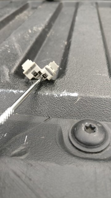

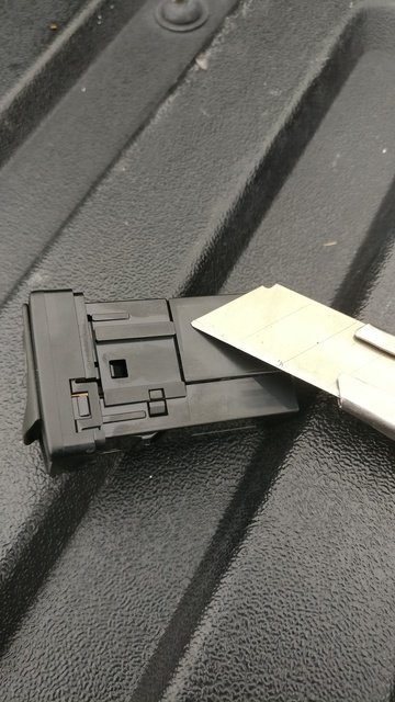

    You may have noticed my USB/Aux is now moved to the far right position as opposed to the OEM location. Toyota "keys" the holes and switches to only allow them to fit in one specific hole. If you want to move any of your OEM stuff around simply take a razor and slice off the groves or alter them so that they will fit in the other blanks.

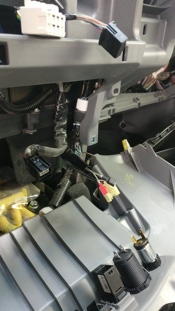

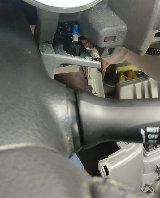

    Alright now that you have that all done and set aside let's move back into the truck. You will need a small pick or flat head screwdriver to pry the two covers up on the plug for the old 12v outlet. Once you have those pryed up you will see two clips that need to be pressed as you pull the wires out. Once you have this done test continuity and figure out which wire is ground (mine was the black w/ gold strip) then heat shrink them accordingly. You need not fear them working loose, the spades lock into place in the small holes on the blades of the Blue Sea outlet.

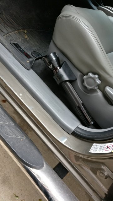

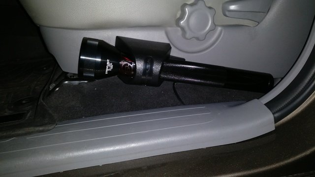

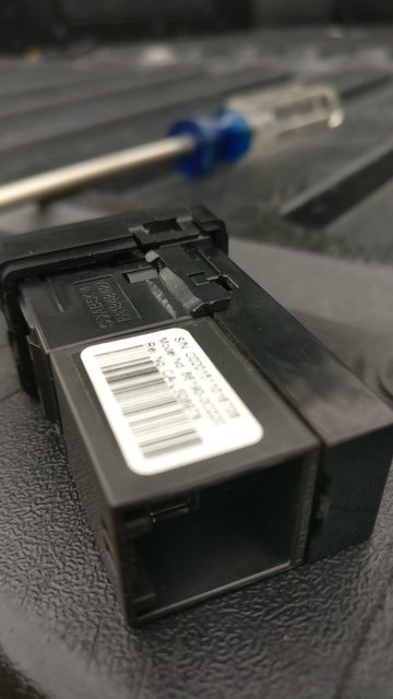

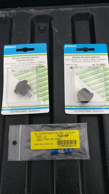

    That pretty well sums everything up, if you're interested in adding a switch for a flash light charger base then continue reading below. Otherwise, once you have tested to verify power, you may start putting your truck back together. :thumbsup:

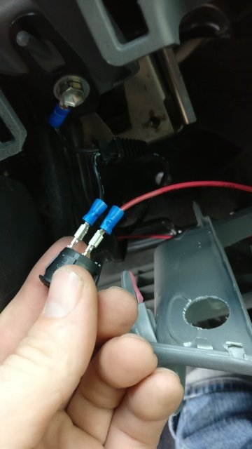

    I opted to go with a Stream Light SL-20L for my permanent on-board flashlight. It comes with a 12v charging adapter but I did not want the bulk and hassle of that taking up my now single 12v outlet. I opened up the adapter and de-soldered the wires so that I could run it to a SPST non-illuminated rocker switch, wired to an add-a-fuse off my stock power outlet fuse.

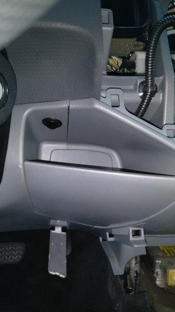

    I didn't want the switch to be in an obvious, open area as to keep a neat look when I do start adding switches to the OEM blanks down the road. After a bit of eyeballing things I went for under the dash where the middle "change" holder is at. I started out drilling a 1/2" hole (that's my biggest drill bit on hand) and used my dremel sanding drum to finish opening up the hole.

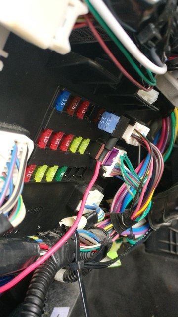

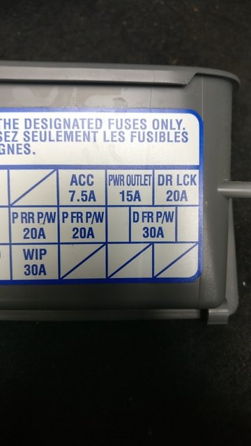

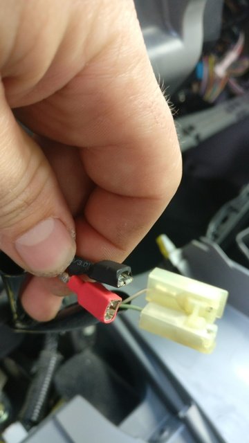

    I ran the charge wire down the length of the kick plate, zip-tied up the wiring behind the kick panel following a harness under the steering wheel to where the switch will be.
    I grounded directly to the bolt behind the switch, crimped on some spade connectors, checked voltage on the fuse panel and installed the add-a-fuse, crimped onto that and ran it to the switch. Tested everything out and began reassembly of my truck!
    Note: The space above where the switch connectors go is tight, if you drill your hole to far to the right you may not get your panel to snap back in correctly. Pay attention to this or you will end up having to make an oblong hole.

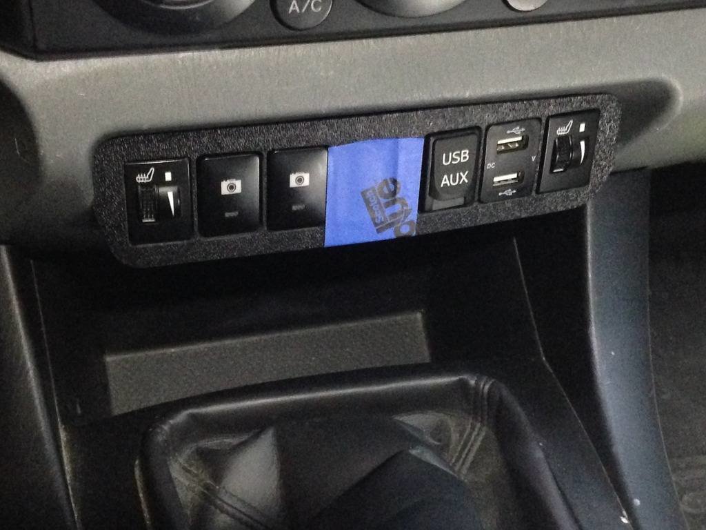

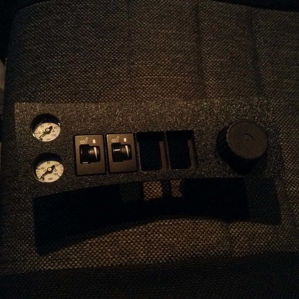

    I ended up making two panels, one for the cubby and one to replace the switches/sockets. The seat heater switches go in the upper panel and my oba controls in the cubby panel.
    7C1055F9-6DE0-46E8-92AA-77C060DE03C8_zps_86848dbbe635c8b2faab1f210ca78ef0882aa902.jpg
    C8D9FE54-7DFC-4E77-A45A-2BF565DC4477_zps_c585fb44e4bafa54a2a14d61137432f2b4afc72a.jpg
    Still haven't even ordered the rest of the oba switches, this is an old pic with the heater switches as placeholders.

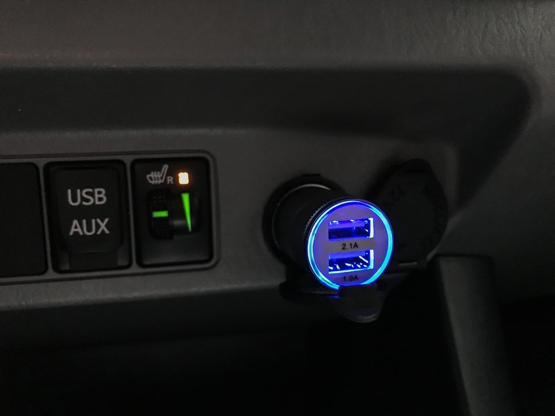

    I love the blue sea smart USB adapters. I installed one exactly as you did in an older land cruiser we have. Disassembled the factory plug and everything just like you did. Works great!
    Can I ask about why the switched power source for the light? Toyota’s from the factory don’t usually have any constant on switched accessory locations. And isn’t the Streamlight charger a “smart” version that will not abuse the battery?
    I ask because I have an old work light too, the same as you but with a great LED conversion in it. I have an extra 12V car adapter I could salvage and run to an ignition “hot” source and just wire it and forget it.
    Has the light ever come lose and shot forward?
    Your giving me ideas man! I love it!
