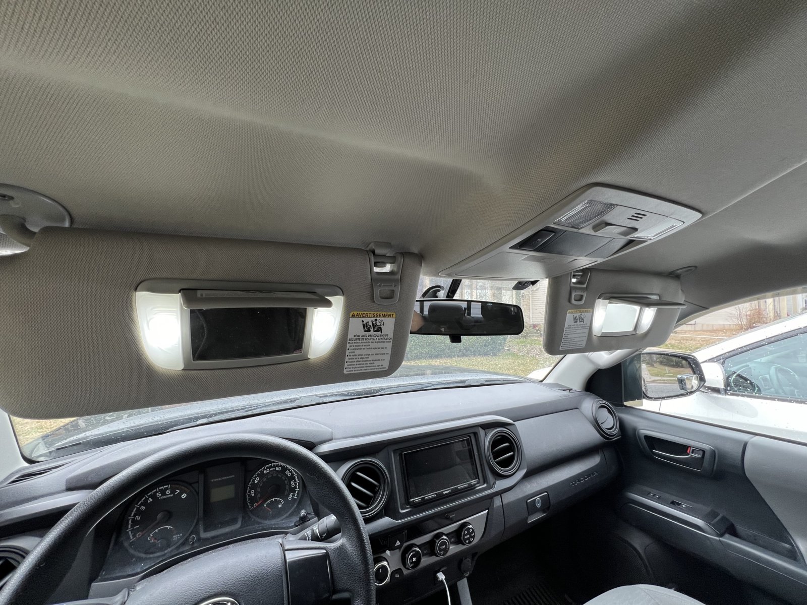

    What gauge wire did you use?
    How much did the visors deflate the wallet?
  4. Nov 29, 2021 at 7:08 PM
    #24
    ironicallyjesus
    ironicallyjesus Well-Known Member
    Apr 27, 2021
    #364106
    158
    Jesus
    Atlanta, GA
    2021 Silver SR SX 3.5L ACLB
    I used 22 gauge TXL wire. Both visors were sourced from a junk yard across the country and were $160 shipped. I wasn't too happy with the condition so I reupholstered them for an extra $33.
    Total I would say each one came out to be ~$110 which I am very happy about, considering a one new is ~$170 depending where you get them and that doesn't include the parts for the harness.

    I just purchased a 2022 Tacoma SR. My wife wanted a vanity mirror added on the passenger side. I found this How To and bought a visor with mirror and lights. The wire colors and pin locations are still good ! Worked like a champ! My wife is happy ! Great write up!

    Hello, i purchased the 2023 Tacoma SR. I really want to replace that sun visor but, can't find the parts on the internet.
    Can I ask you where you purchase it? If someone know the link please share it! My wife really expecting of these! and my girlfriend....too....kidding:)

    Search these part numbers on ebay, or other auto parts store. There are some online junkyards that may have them as well (LKQ, for example), but you'll likely need to go through selection menus, not just part numbers. You could also order from a toyota dealer, but usually pretty expensive ($150+).
    • 74320-04370-B0 (left)
    • 74310-04140-B0 (right)
    BEFORE ORDERING, CONFIRM THE CONFIGURATION VERBAGE, not just the part #. There are many sun visor options on the tacomas (with/without mirror, with/without lights, with/without sunroof) so make sure you get the one that matches your truck and needs.

    THANK YOU SO MUCH FOR THIS Roll_Terps! Made this account specifically to thank you.
    I did my wife’s side over the summer and just finished doing my side today after I couldn’t take the lack of symmetry anymore. Great instructions, super easy to follow. So dumb that Toyota didn’t put these stock in every model but oh well.
