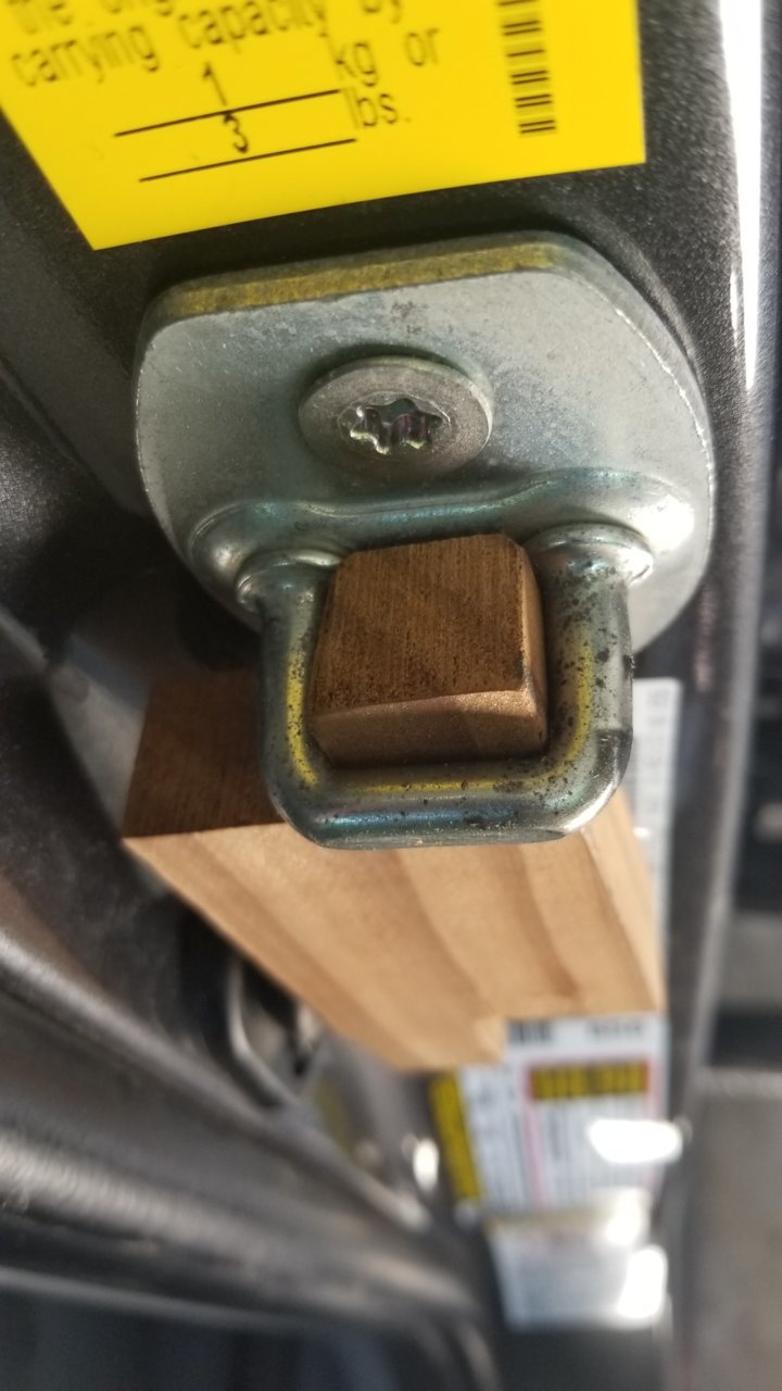

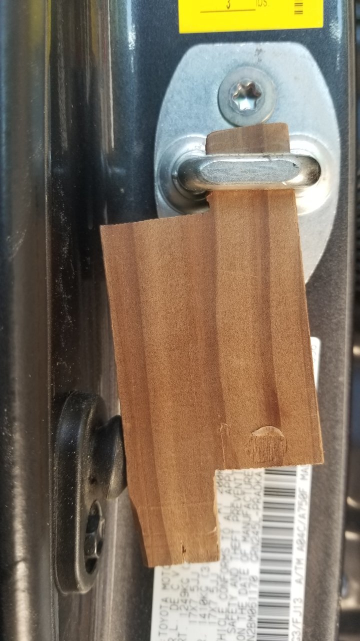

    I like to listen to music from my truck when working in the garage or out doors. The stupid alarm that never stops is pretty annoying. So, I cut a bit of wood and made up this little stfu block.
    It's a 1x2 piece of pine. I cut a small notch at both ends to match the inside diameter of the door clasp. A small amount of utility knife work to round out the corners and it works great.

    Hahaha, i use a multi-bit screwdriver that i keep in the door pocket, tried closing the door a few times, didnt close.

    If you unscrew the switch a little so it doesnt make ground or just unplug it ,it wont ding but you wont have domelight.

    Yea, I like the alarms purpose. I dont want to shut it down always. Just when I have a need to keep my door open for a while. I'll just keep this down by the seatbelt for quick access. I wish Toyota would program a session shut off request. Like a double press of the button or something to silence it.
