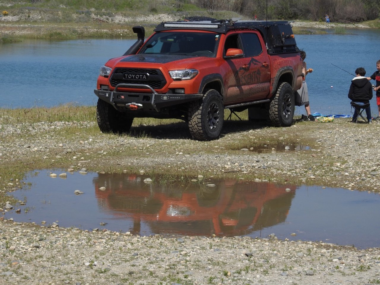

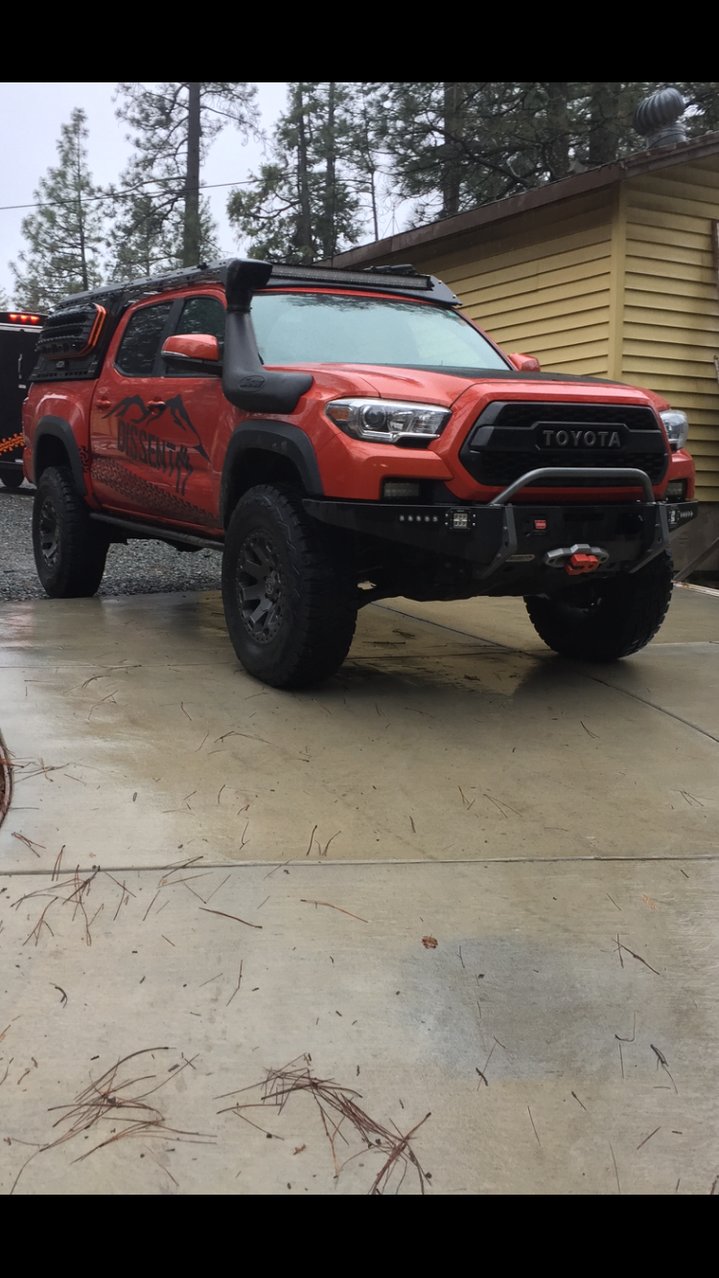

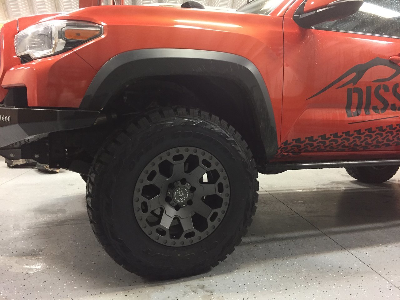

    I just went 35s on a 3" lift. Cab mount chop lower front fender trimming seamed to do the trick. A big part of fitting the 35s is getting the right wheels and tires.
    I went with a 285/75r18 with 18x9 -12 wheel. I have run this size on several of my vehicles and think it a great size for fitting 35s with minimal lift and trimming.

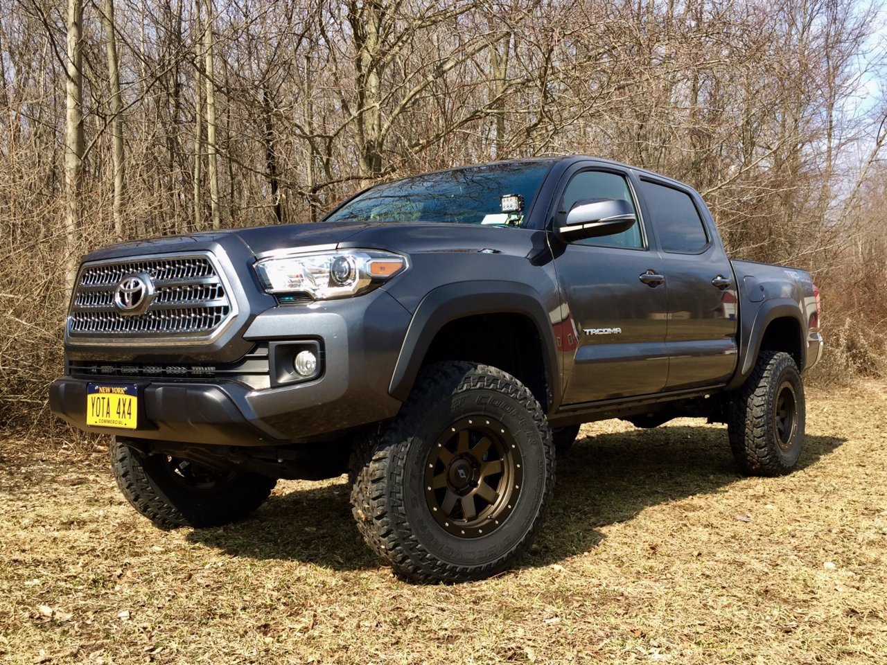

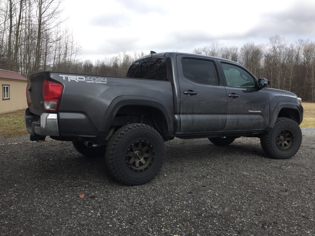

    Here’s mine on 33’s and a OME HD rear Dakar Pak and 886 front coils. Everything bolted on in a few hours drive great and they clear everything fine.
    I LOVE the look of 35’s but in the end 33’s are much more practical (for me)
    Plus i was able to get them aligned with no new UCA’s.... 33’s work just about as well and cost you much much much less.... but i do wheel with a guy with an FJ on 35’s.... they are cool.
    Just something to consider. If cost and driveability isn’t an option go big. For practicality 33’s (255 85 R16’s in my case) were a smart choice.

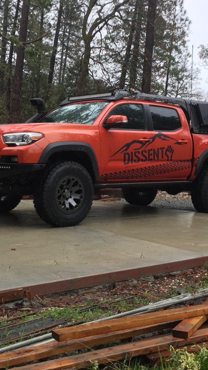

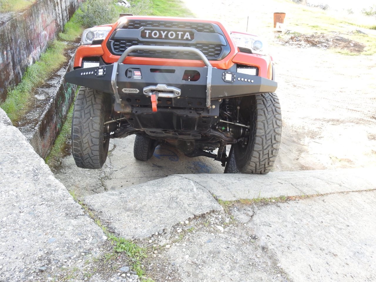

    Got to get out and test mine a bit on the 35s. I do have a bit of trimming that needs to be done in the rear and some pounding in the front. I'm not sure I will get it 100% rub free but I'm sure I can get close and at least get any contact area smooth so there is nothing for the tire to grab. I hit some flexy stuff and high speed stuff with minimal rubbing. IMG_0546.jpgIMG_0547.jpg
