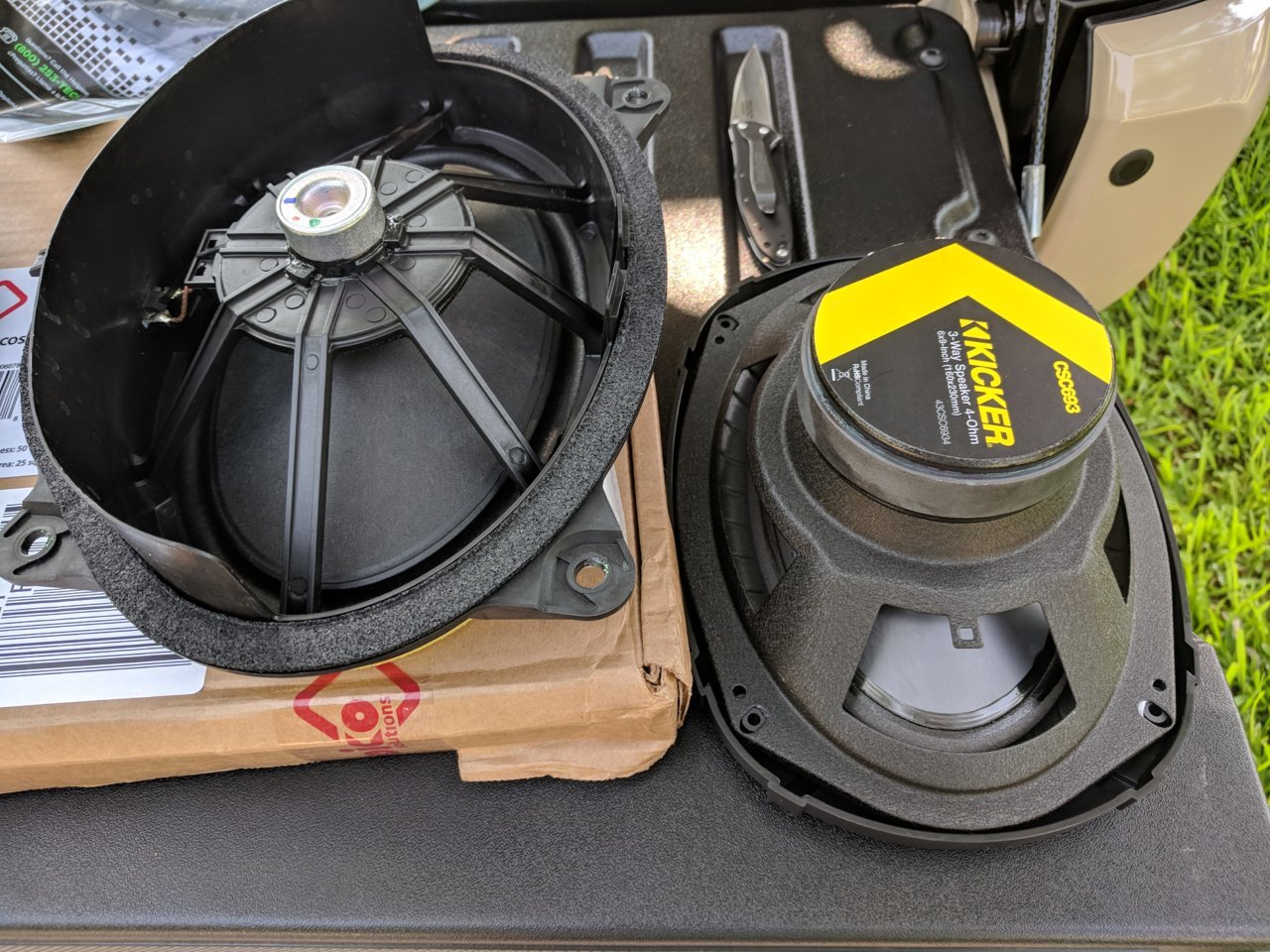

    I'm in the middle of changing the door speakers; I've finished the front. Toyota should be ashamed of the stock, non-Premium Package speakers... Look at the size of the magnet of the stock, front door speaker on the left versus the standard magnet on the right

    The stock speakers are pretty pathetic.
