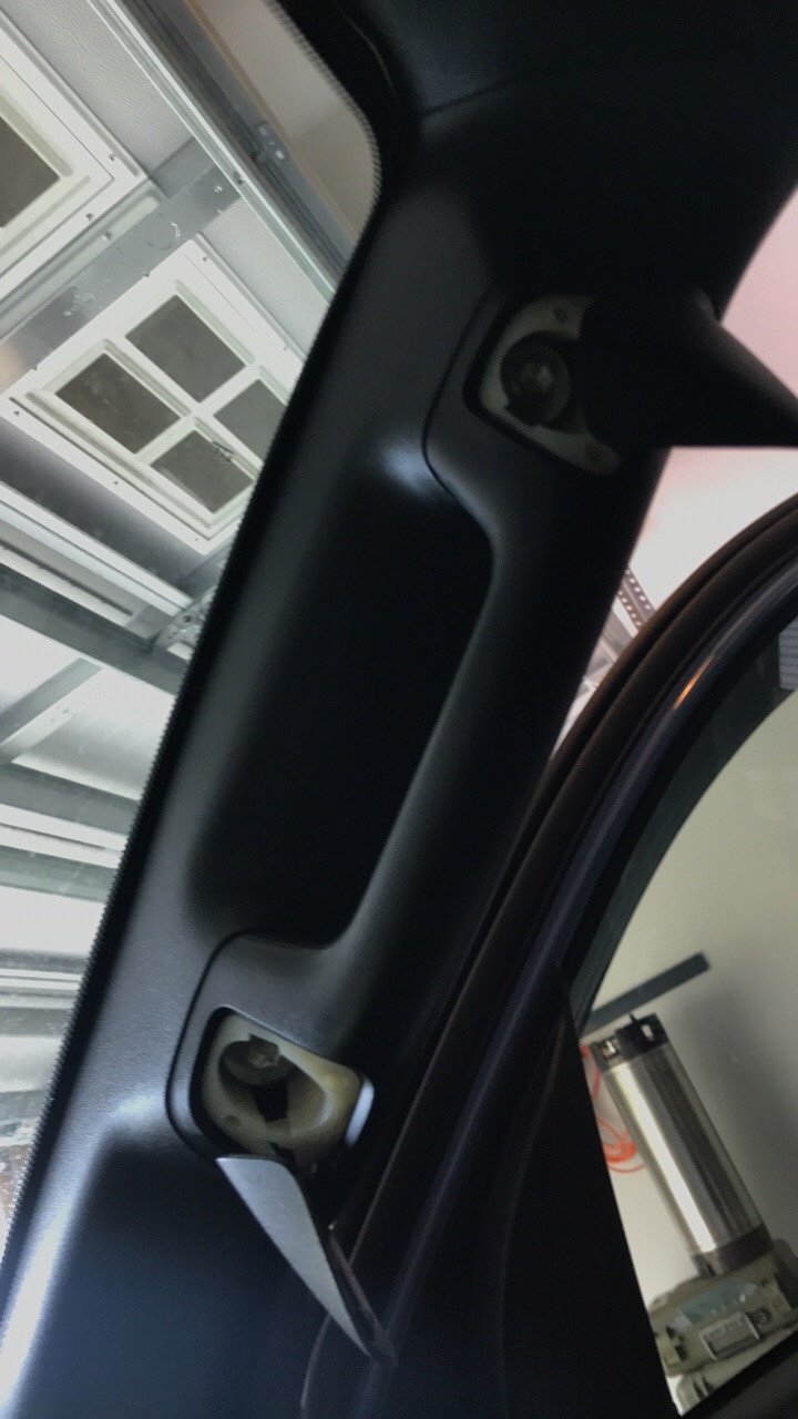

    Anyone know how to get these covers back on for the passenger pillar/handle?
    Mnmlod likes this.
  15. Jun 11, 2018 at 2:50 PM
    #235
    toyotatacomaTRD
    toyotatacomaTRD Senior Member
    Sep 16, 2010
    #43379
    4,356
    They'll go. Just be easy. Spin around and move to where they need to go. You might have to take several runs at it. At no point did I over apply pressure.
    dan_SD[QUOTED] and shakerhood like this.
  16. Jun 11, 2018 at 2:55 PM
    #236
    shakerhood
    shakerhood Well-Known Member
    Aug 9, 2015
    #161370
    37,146
    Southern Ohio
    2017 MGM DCSB Off Road, 6 Speed MT, P&T
    Just keep trying and they will go in place. Definitely do not apply too much pressure as those little tabs can bend.
    toyotatacomaTRD and dan_SD like this.

    Seconded. I had to unbend one of the tabs on the lower cover. Gentle!

    Move them into position where the 3 tabs line up; you should be able to eye-up all 3 (IIRC); once lined up push the cover in slowly with your thumbs.

    Mine slid back in like a 3D puzzle.

    I bent one. The one near the tether. Once I straighten it out and carefully inserted it first, it all went together nicely. At one point I thought I'd need to put a drop of superglue where the offending tab was but I'm glad it didn't come to that.
