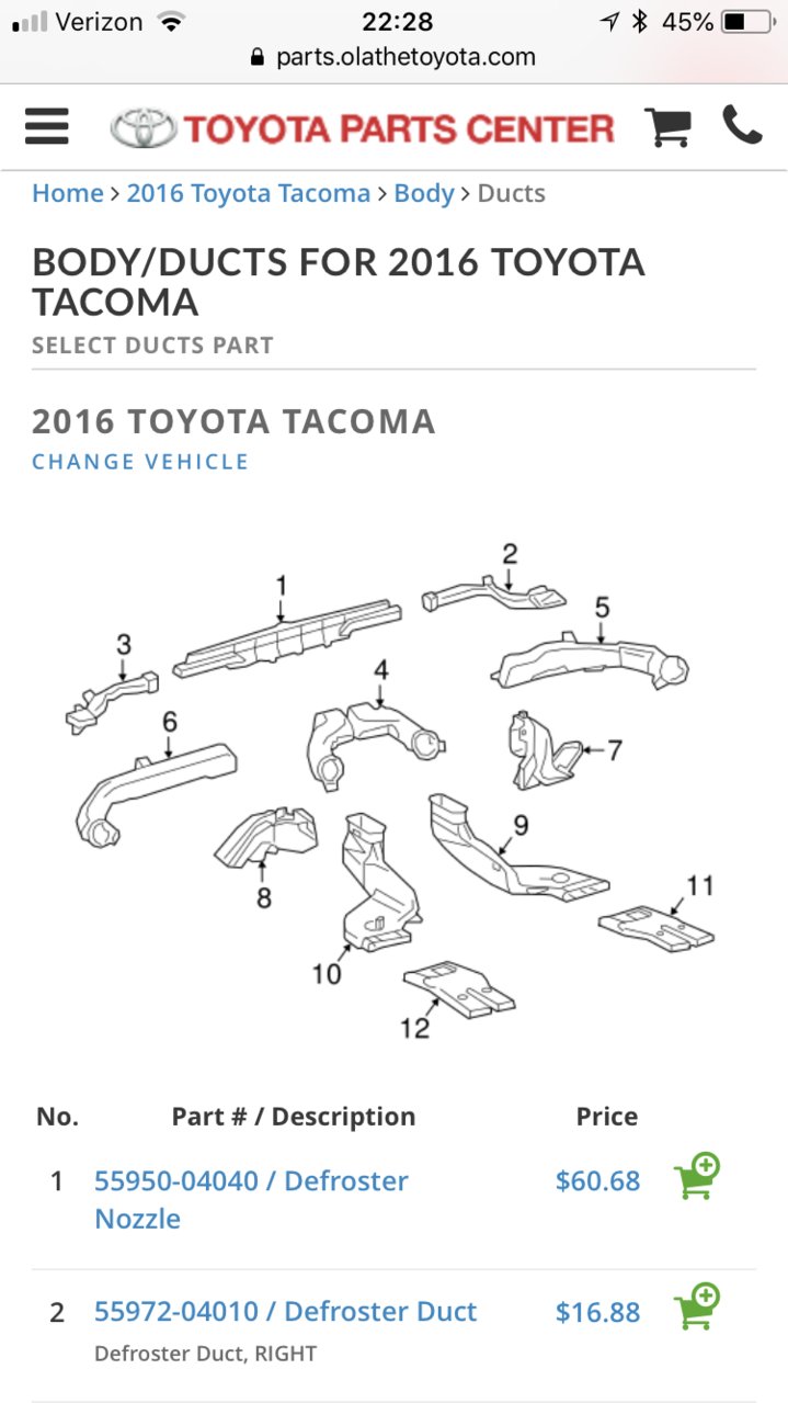

  5. Jul 25, 2018 at 8:07 PM
    #345
    trouttaco
    trouttaco Well-Known Member
    Feb 20, 2018
    #245106
    295
    Portland, Oregon
    So.... I did the tweeter upgrade. Thanks for the awesome instructions...
    I ended up fucking it up though... I dropped my panel puller down this vent... any idea where it goes or what to do?
    Gator352 likes this.
  6. Jul 25, 2018 at 8:30 PM
    #346
    OpelGT
    OpelGT hOPELess Power
    May 6, 2018
    #252678
    558
    Texas
    2018 TRD OR Tacoma MT, Magnuson Supercharged
    Looks like part #2 maybe. I bet you’ll be able to fish it out (hint use a vacuum with a small enough flexible hose attached to it) since the part appears pretty flat I doubt it escaped too far.
    rsimi72 and trouttaco[QUOTED] like this.

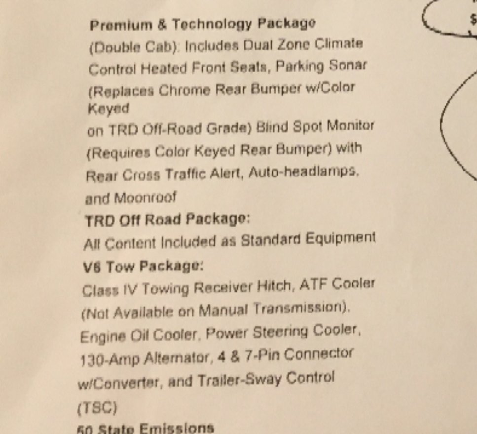

  18. Sep 3, 2018 at 2:03 AM
    #358
    bedouin2w
    bedouin2w Well-Known Member
    Jul 25, 2017
    #224955
    57
    NorAl
    '17 TRDOR DCSB 4WD
    So my Tacoma is currently in storage since I'm away for work right now. This is the options section of my sales sheet. I was wondering if anyone could tell me if I have the stock tweeters or the JBL tweeters.
  19. Sep 3, 2018 at 8:38 AM
    #359
    shakerhood
    shakerhood Well-Known Member
    Aug 9, 2015
    #161370
    37,146
    Southern Ohio
    2017 MGM DCSB Off Road, 6 Speed MT, P&T
    Is your truck Manual or Automatic? Manuals don't come with JBL but not sure if you could get P&T on an Auto without JBL.
