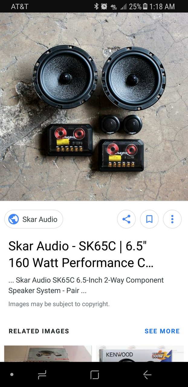

    The crossover has a positive and negative input from the wires coming from headunit/amp and then for a 2 way a positive and negative for the tweet and a positive and neg for the mid. The crossover box tunes out the freqs that the speaker isnt intended to play. Same with a 3 way. A coaxial is plug and play, but sounds like shit when compared to a component setup of equal cost/value

    Since most people arent gunna get an amp/and new radio, you can use the positive and negative leads that used to go to your factory speakers and the crossover will take what it wants and feed that signal to your speakers
