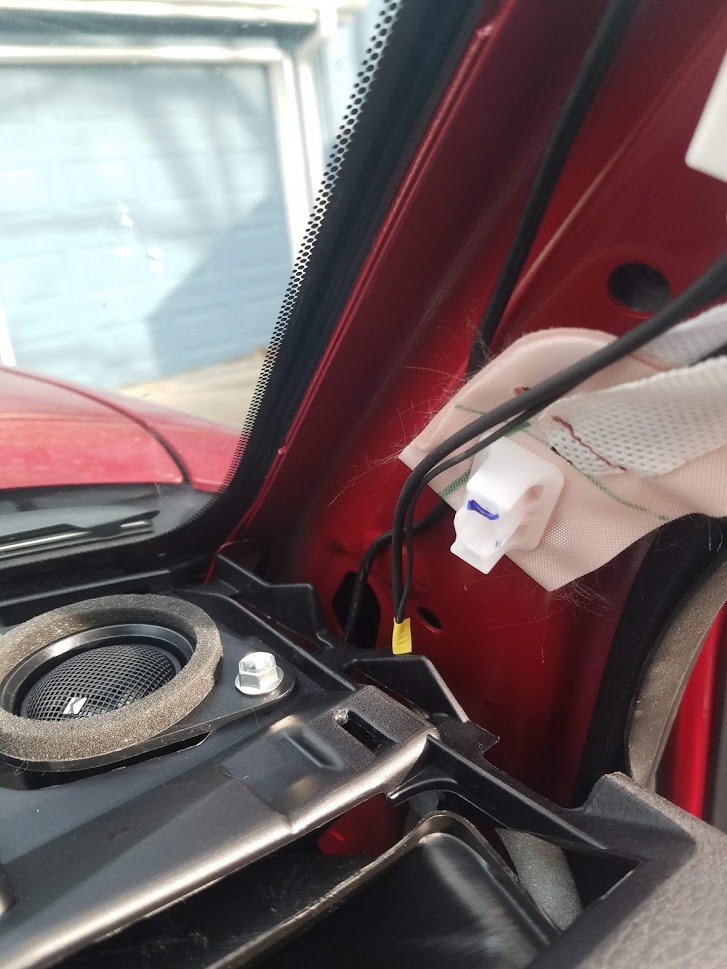

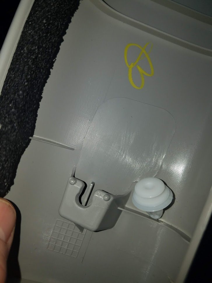

    Not to beat a dead horse, but these tweeters significantly changed the sound of my truck. Before, I always felt like all I could hear was the passenger-side kicker in my ear. And, now I don't mind a bit more bass since the sound from the tweeters is so much clearer and louder without having to turn up the treble/mid. Did the install last night, in a half-lit garage. Super easy. Be mindful of the metal insert on the driver-side pillar. It fell out, and I don't know if I put it back in facing the right way :confused:

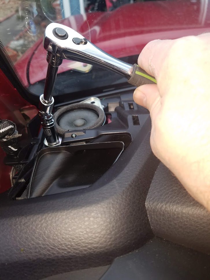

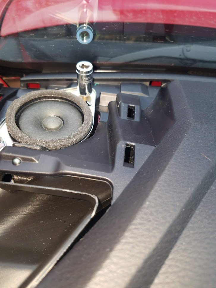

    It does make a good improvement. Be advised that the drivers side pillar cover has a little tab that can pop out just as you are getting it pushed back into place. I had to cram my hand in there to hold it in place as I was getting the plastic slid back in the bottom edge. Also it is best to use a wrench and not a socket on the front bolts.
    TUGmd7mDZt8cBbbJxfgxf5H62KINaXb3zlh9VwWA_0e29d3517544f37d3266f0ffc48cd03db2c2c368.jpg91R6a28BiClpvycaPgEm342kd-xlO-IOaB4Mfog4_6c8943e1de73fcff3462e26dd7f7278e21169de2.jpg

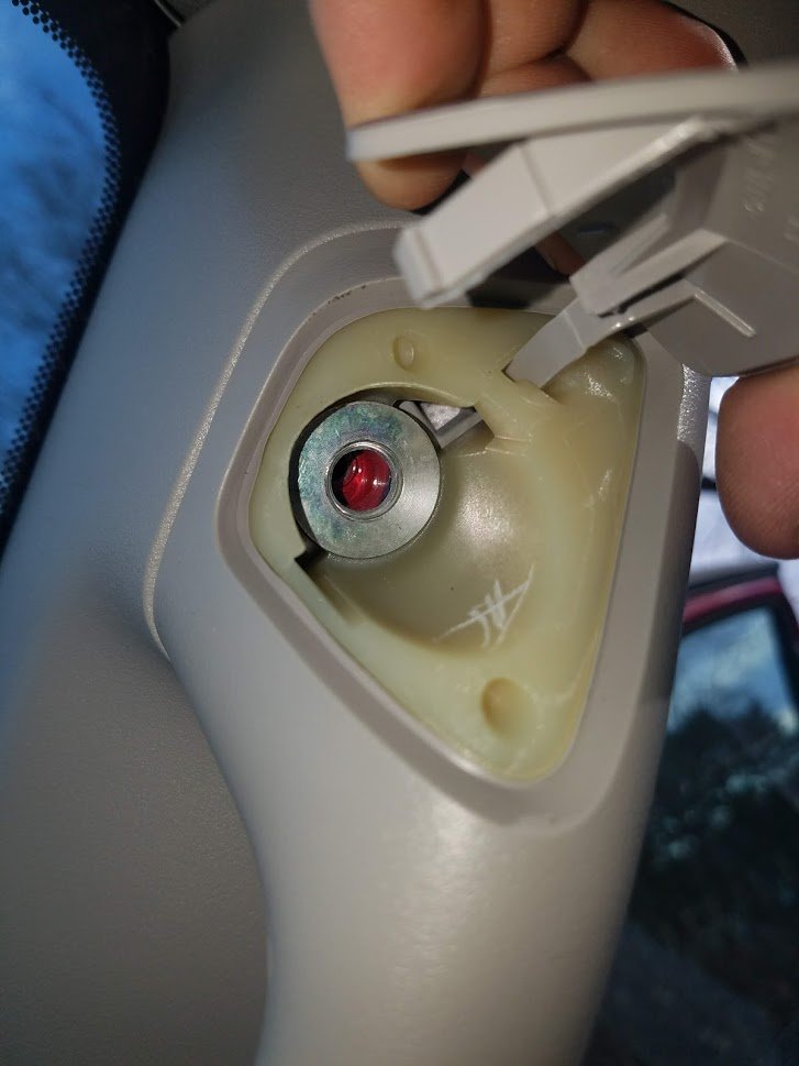

    Also a 1/4 socket set with a 10mm socket with an extension and an u-joint helps with the rest of it. The pillar bolt covers all removed easily just by prying my fingernail under them along with a plastic tooth pick to then lever them up. This left no tool marks.

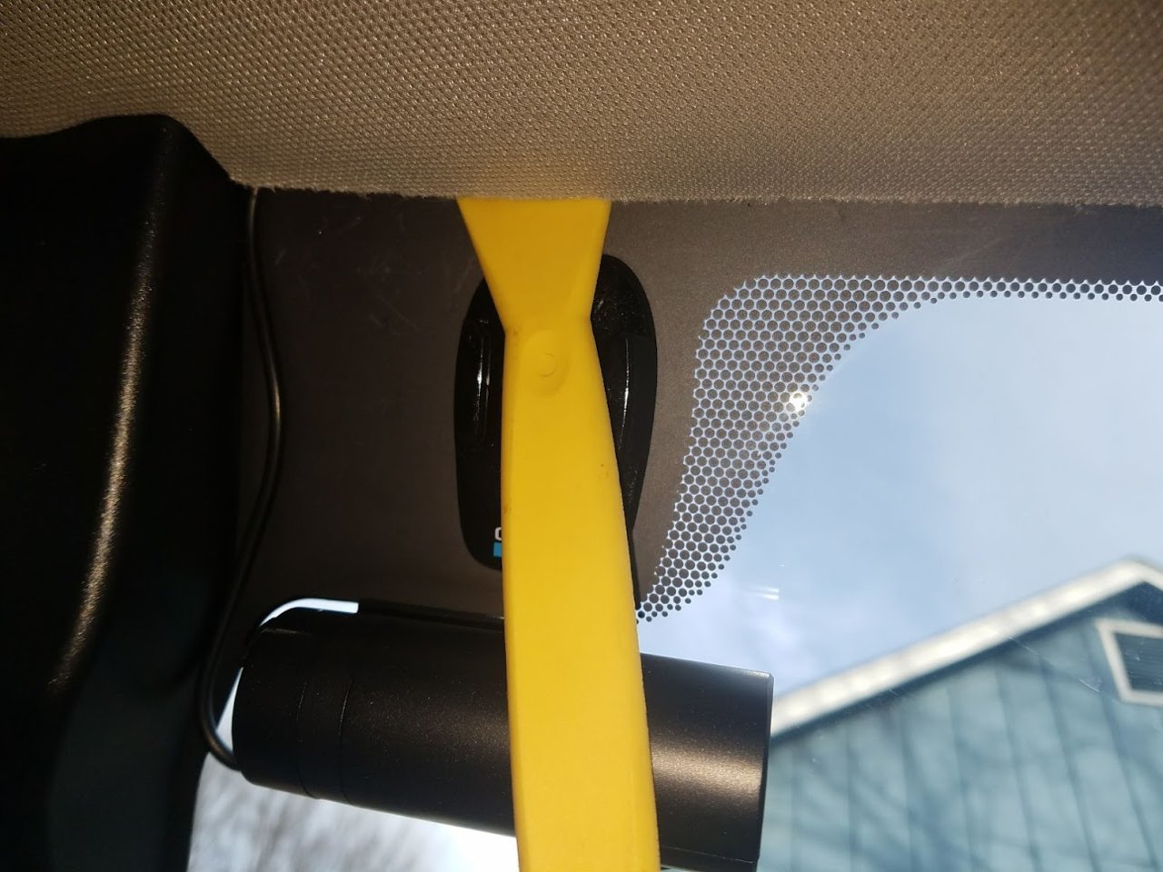

    When I installed the speakers I used the opportunity of having the passenger side A pillar cover off to wire in my dash cam.
    b8Gr-FOElUllGUpenlp9JC-Qty4kuXr7TipP6wyR_1104e5d6b4cd6aaece3417038ef57d33c45336dd.jpg

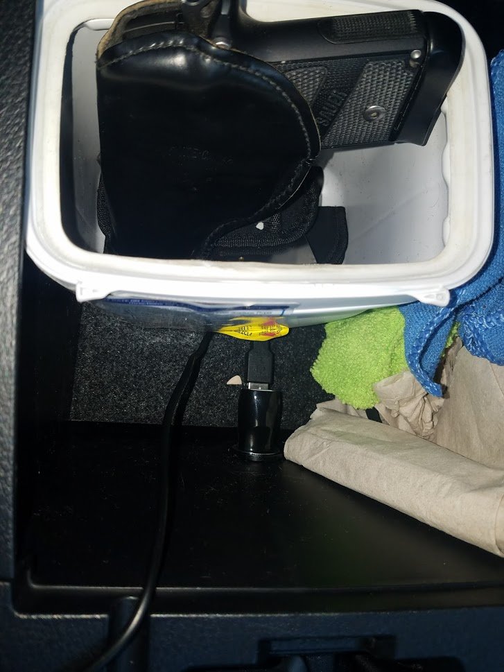

    The dash cam USB wire I was able to drop down the side of the dash without any effort. Then I threaded it under the dash then tucked it under the console plastic and plugged it in to the plug in the console storage. It comes on only when the ignition is on. Clean and simple.
