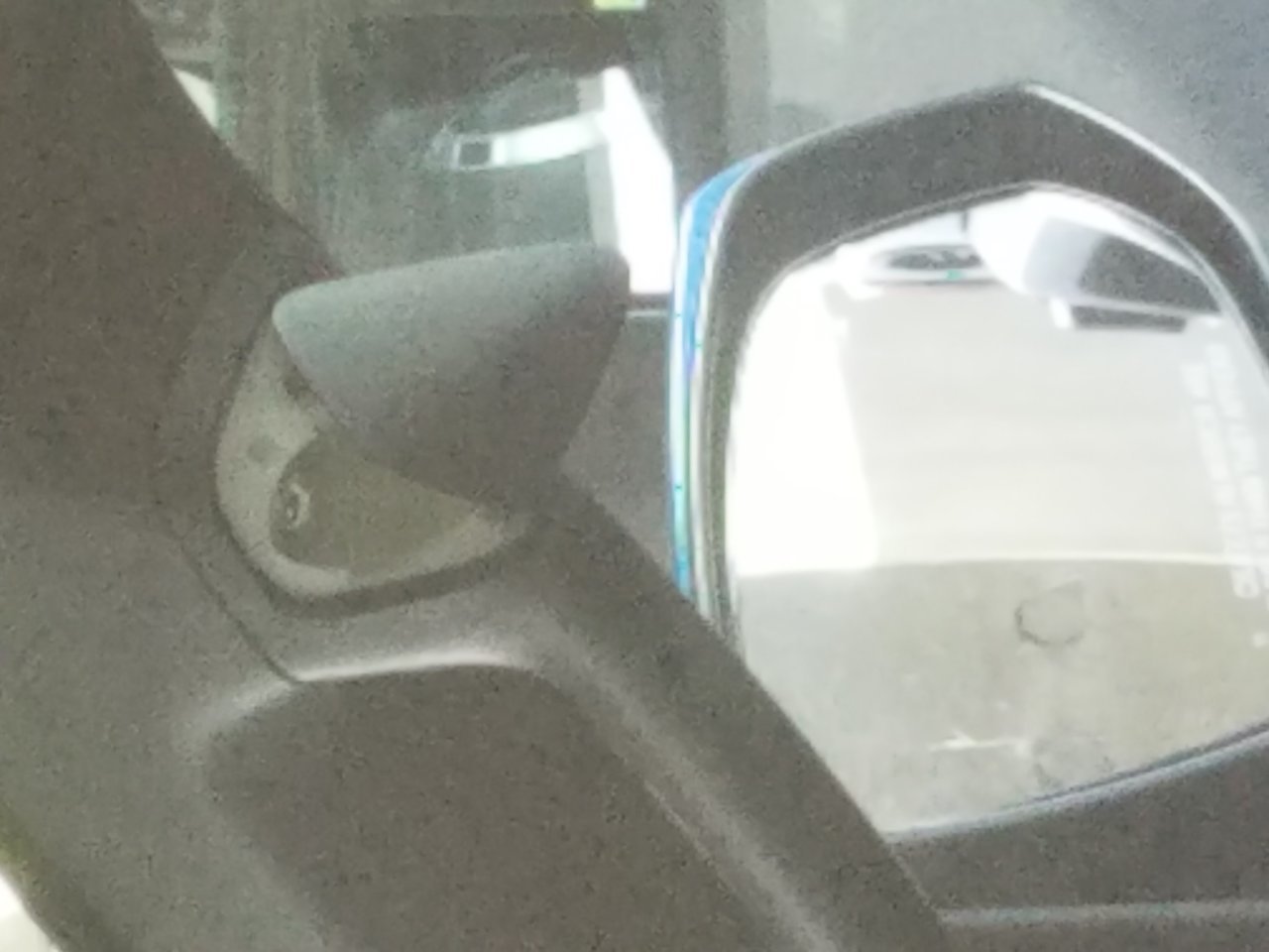

    Besides trading it in for a 2019. Any suggestions on how to get this cap back on? Passenger side. After the speaker install it not going back on. Sorry about the pic quality, walked out to my truck and forgot my keys. Thanks speaker plastic.jpg

    I struggled with mine a little bit but you have to just mess around with it until it aligns property.

    There are a couple small tabs on that cover that bend easily, straighten them back out and it will snap back in place.

    The cover thingy has a raised piece on it that fits into a slot on the pillar piece, for lack of a better description.

    Assume you got this by now. Just in case, I found the tabs needed to be pretty much perfectly aligned and it’ll slip right on. Try different angles.

    It worked, thanks all.
