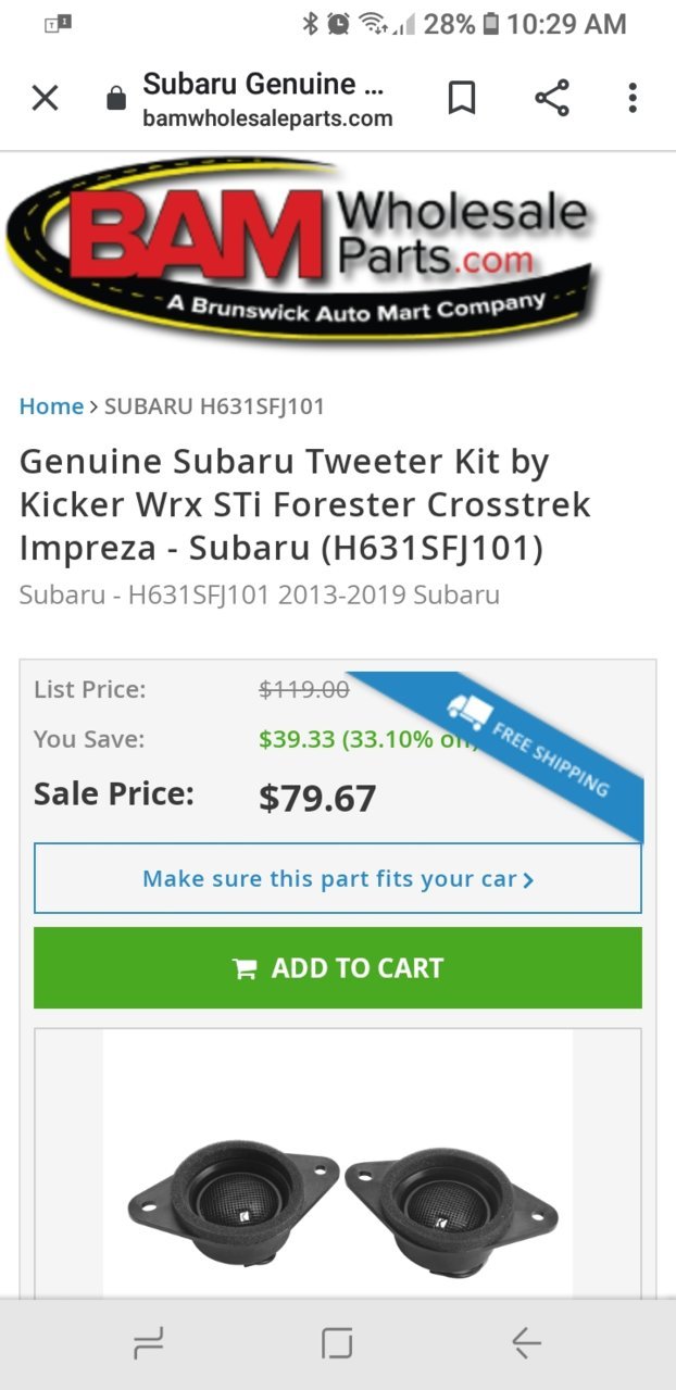

    Found the Subaru sti tweets for $80. Price was $102 on Amazon.

    Promo code "save10" still works for an extra 10% off

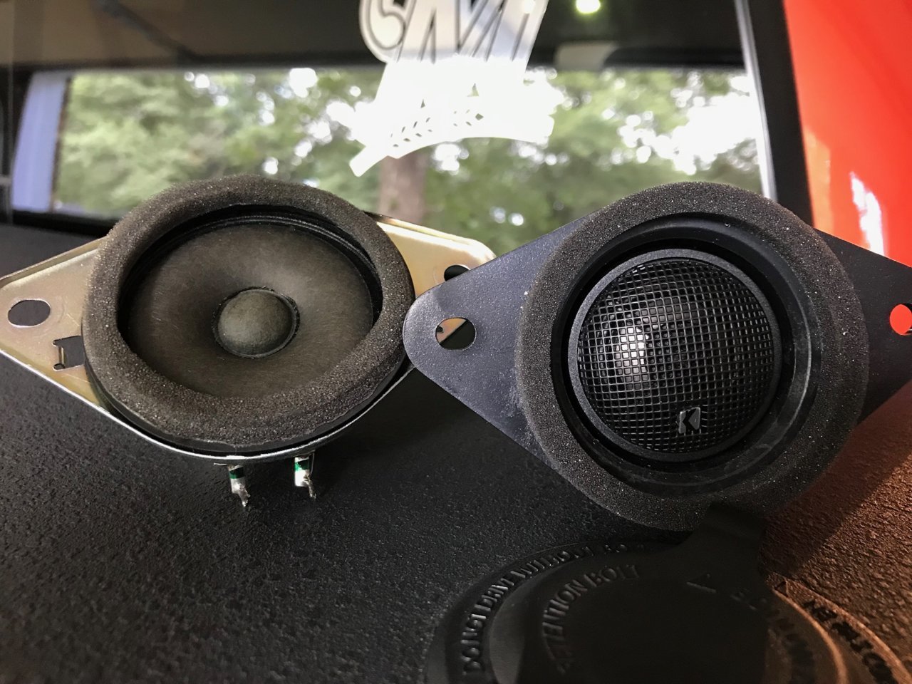

    Just did the Subaru tweeter swap this morning. The hardest part was disconnecting the harness from the OEM tweeter. Much better sound. I will be doing the 4 door Kicker speaker swap next week when my order from Crutchfield gets delivered. Great write up @SomethingNew71
    Original vs Subaru tweeter!
