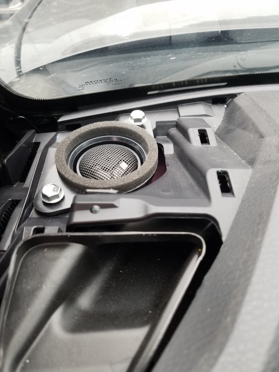

    I snapped the plastic clip on the right bracket and it fell into the hole in the dash where the tweeter sits. Any idea how I can get it out?

    I did something similar, I dropped a plastic clip down the hole on the drivers side. I pulled out the cubby above where the rear sliding door and outlet switch our are and I was able to fish it out from there. If you dropped it on the passenger side..hmm not sure what to say. Go hit some wash board dirt roads for a bit see if it falls out lol
    Coming from a different point of view..I installed these tweeters last (after installing both front and rear door speakers along with a 10" sub) and I didn't notice that much of a different after already having all new speakers. I do think I notice maybe the highs a tiny bit more but nothing crazy. After getting all new speakers, I could of probably stayed stock on the tweets and been good. If all you plan on doing is tweeters, then I'm sure this is a good investment.

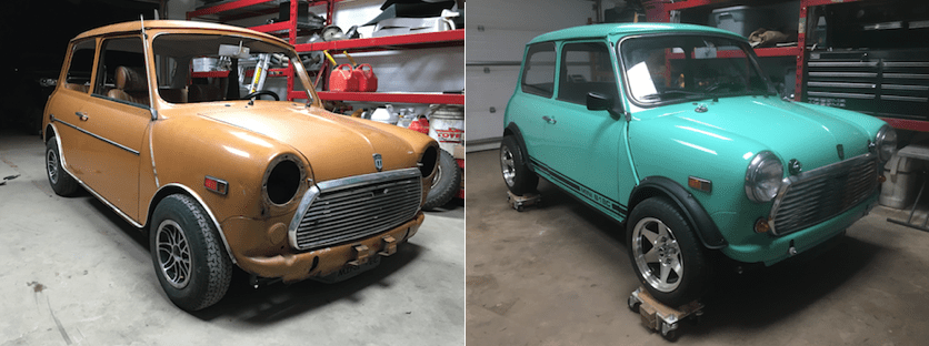

    Also shameless plug for the fact that my Mini project is finally done after 2 years.

    Dammmnnnnnnn look at that sexy thing. VTEC!!! You gonna be at the CMU event this April?

    pop off the cover that says SRS Airbag on driver side and unbolt the 10mm. pull that panel to the right a bit and out towards the seat.
    pop the front of the speaker panel as shown in OP's pic and work go the right side, then pull the panel up and out.
    for the passenger side, pop the panel cover on the handle, unbolt the 10mm bolts, same process. speaker panel, pop from the front and work to the left.
    hope that helps, take your time, it's not too bad.
