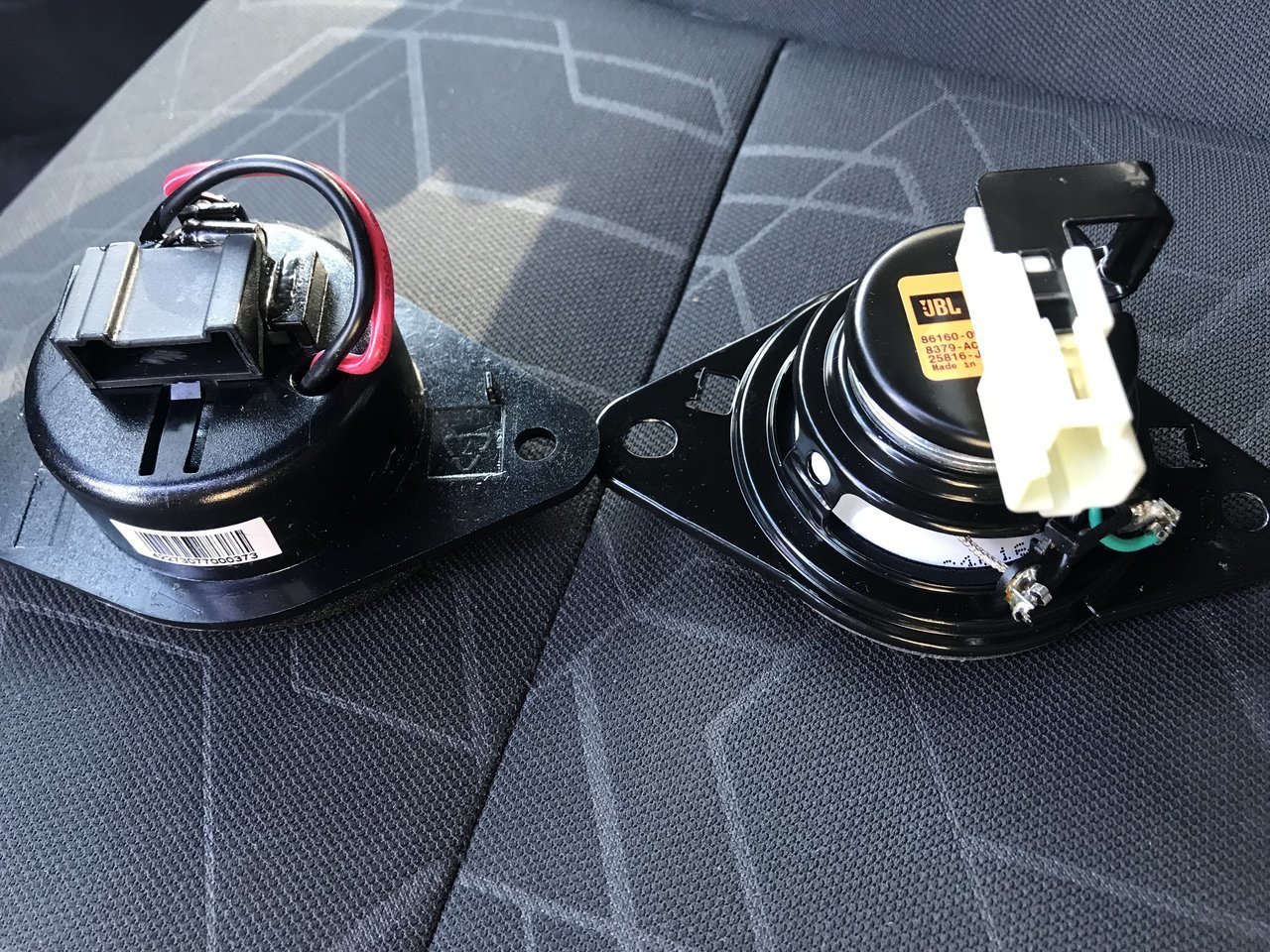

    Yep, pretty much. it's not a 100% plug-n-play but the tweeters fit the location and sound improved compared to the JBL. Just have to solder/crimp your own connection.

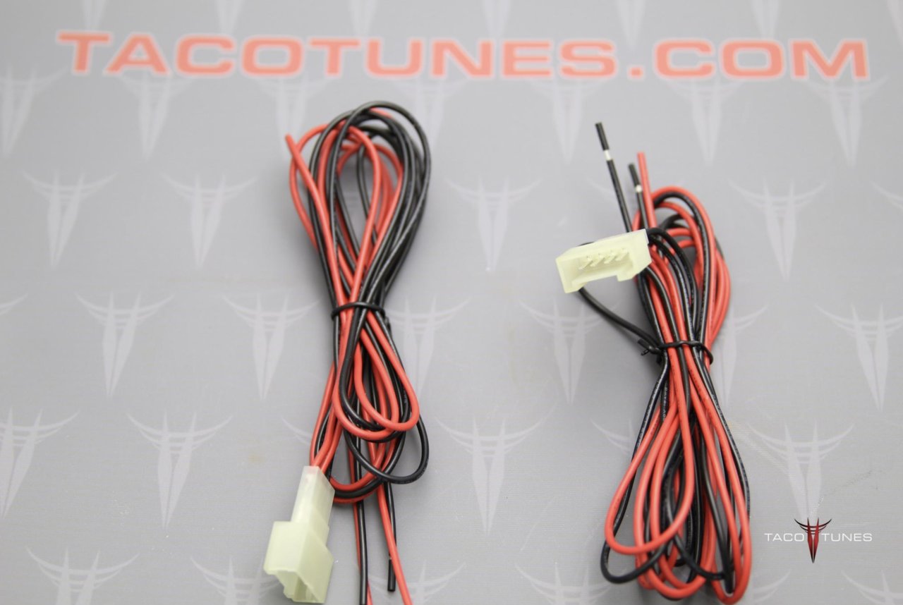

    Except I cannot because the JBL tweeter uses a different plug than the normal tweeter
    Taco Tunes wiring harness:
