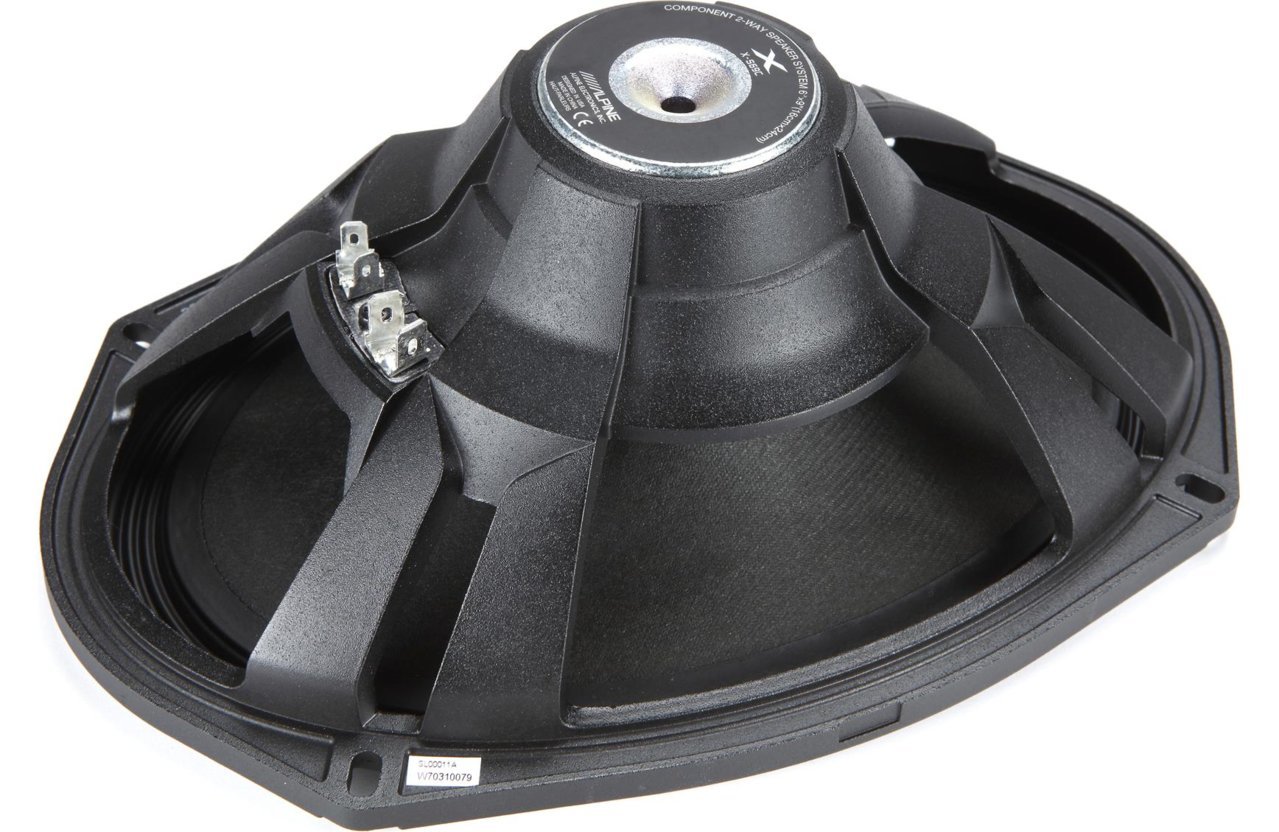

    I still cannot believe how light the factory speakers were and the sounds they were able to produce, the magnets were like the size of a quarter, lol.

    The other funny thing, that I can’t quite explain, is nothing ferrous really sticks to the magnets on the stock speakers. It is like they are not magnets at all (though science tells me they must be magnets, with only two wires to each speaker). I noticed this when I took them out. Everything in my workshop was sticking to the Kickers, but the OEM did not pick up nails or paperclips. Whatever magnetic field is in there, is somehow contained, or cancelled out within the structure.

    Interesting, never paid attention when I removed them, wonder what they are made of?

    Neodymium, just like these $500 Alpine speakers.
    The magnet is inside of the voice coil, rather than surrounding it.
    Stocklocker[QUOTED] likes this.
