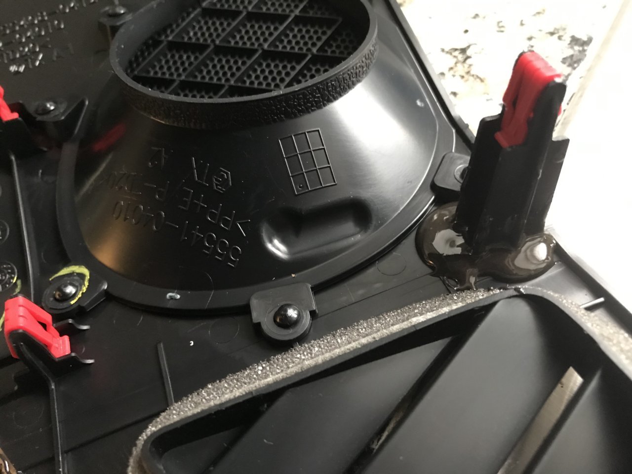

    So don’t do what I did .....make sure you actually remove the plastic surrounding your pillar/airbag PRIOR to trying to remove the speaker cover. If you don’t you will snap one of the mounting tabs on it .....luckily I have JB Weld and think it will be A-OK but we’ll see.
