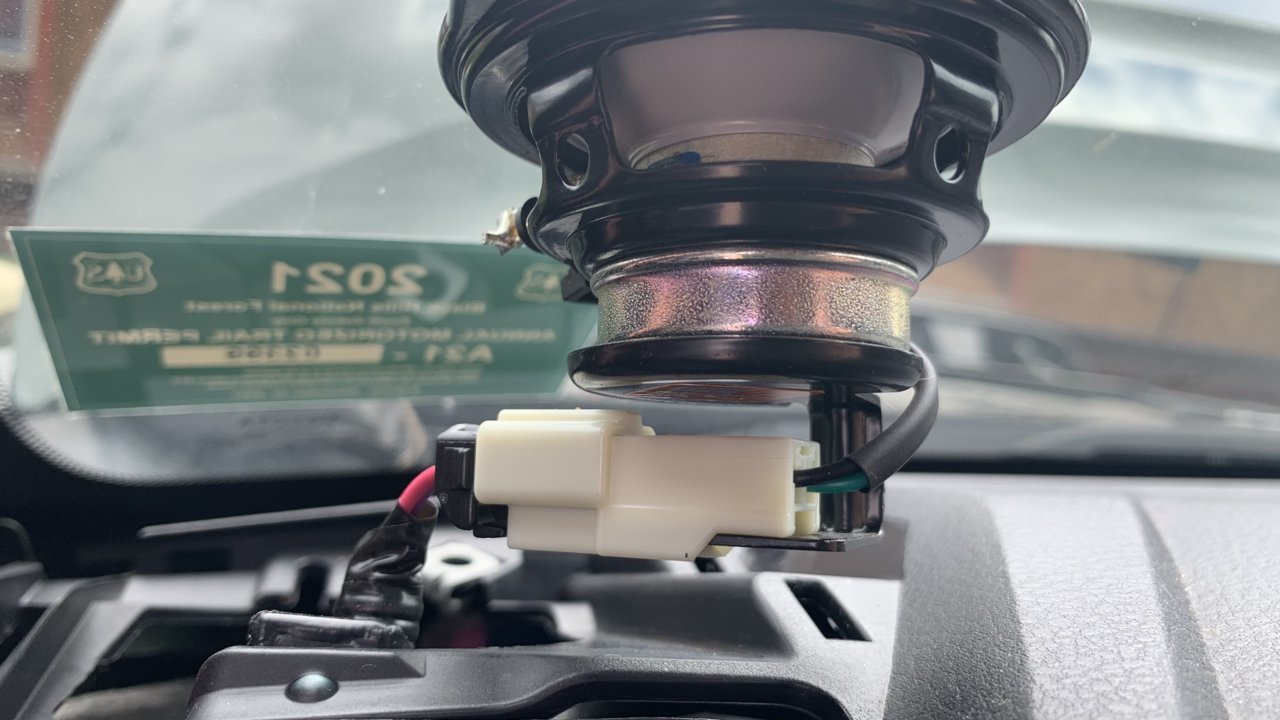

    anyone else have this issue? did the install today and my passenger side connection didn't click. seems to work fine though.

    Just installed these and they make a huge difference! My only concern is that the connectors didn’t “click” into place like the did with the stock tweeters. Anybody think this will be an issue later with all the vibrations the tweeters produce?
