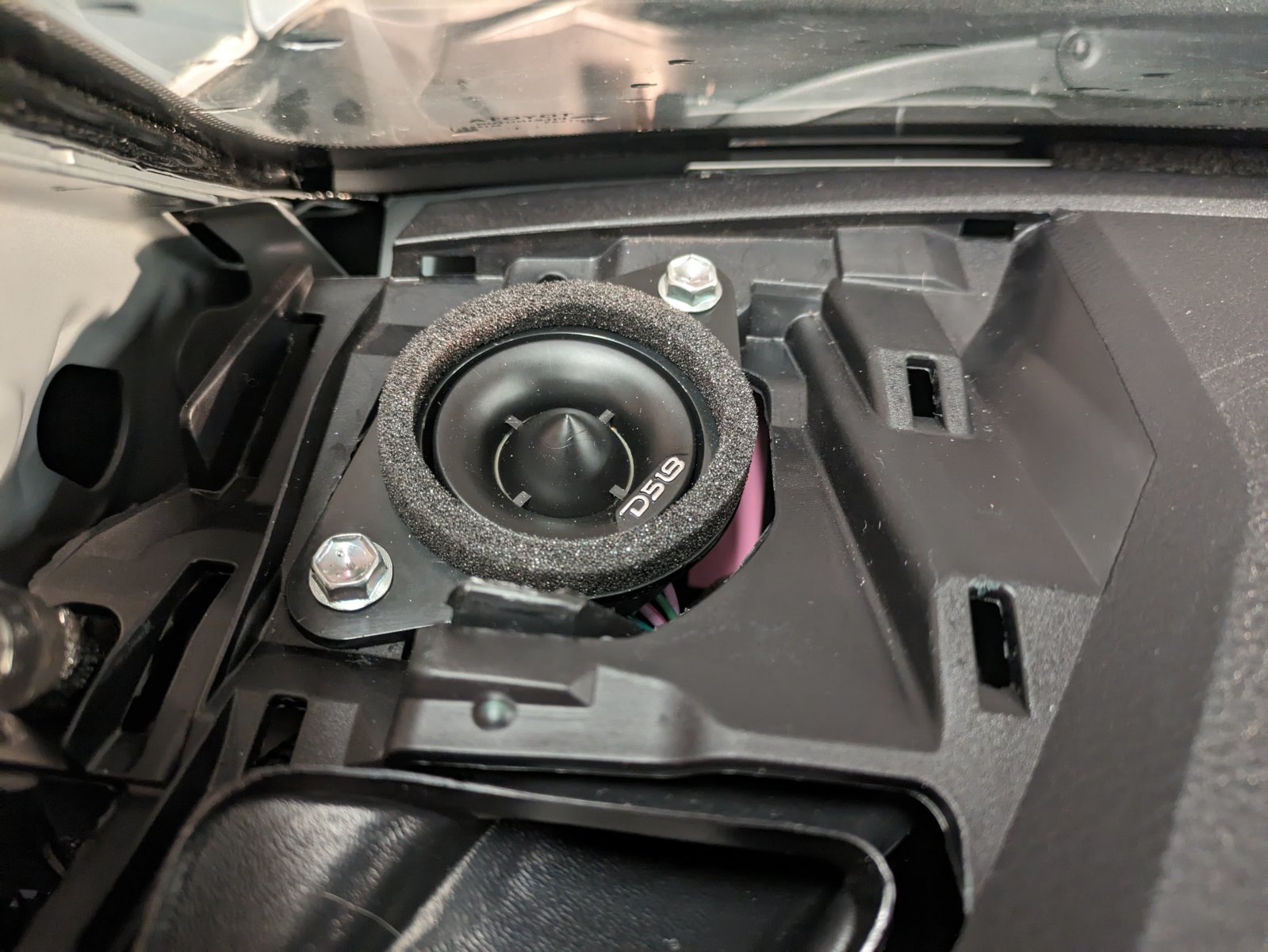

    I purchased these speakers for my 2020 non-jbl, and the alignment holes on the replacement speakers straight up don't fit right. The plastic wings for the sides of the speakers are too far apart.
    Anyone else have this issue?
    Edit: the plug and everything works, turned the truck on and the tweeters sound awesome. The alignment holes on the speaker are the only issue.

    I just did this install today. Mine didn't line up at first either, but I realized I just had to rotate it 180 degrees so the "DS18" isn't upside down and they lined right up. It kinda twists up the stock wiring a bit, but seems fine.
