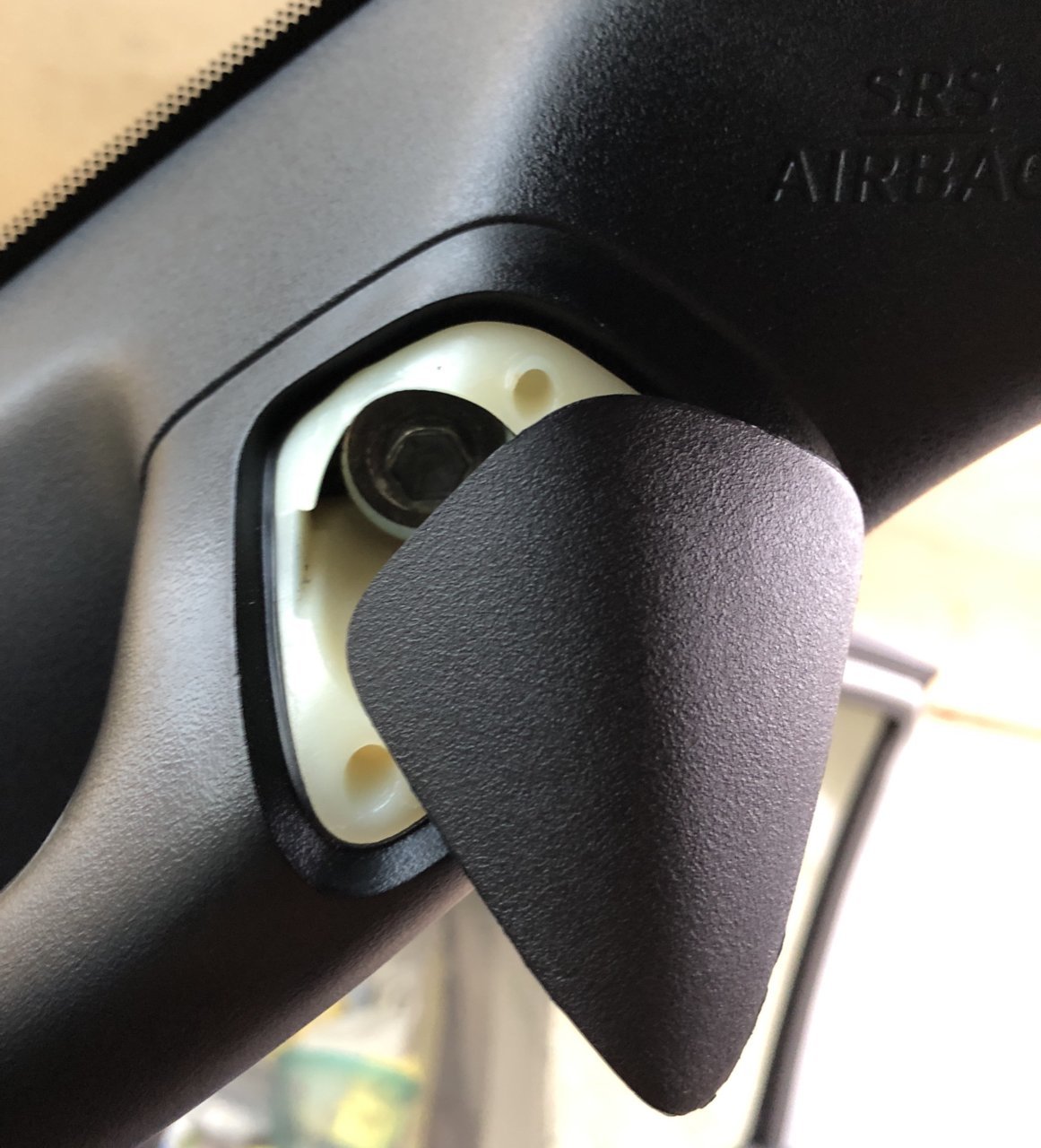

    Can’t put this and the bottom piece back, helllppp...
    sxe4533 likes this.
  8. Apr 2, 2018 at 8:39 PM
    #68
    shakerhood
    shakerhood Well-Known Member
    Aug 9, 2015
    #161370
    37,146
    Southern Ohio
    2017 MGM DCSB Off Road, 6 Speed MT, P&T
    There are little tabs on the back of that small cover that you can get back into place with your fingernail, they bend out of shape easily if you try to put that cover on at the wrong angle.

    Nope. Pull the pillar cover first or you’ll break clips on the speaker cover. It’s really simple. Pop the SRS badge to pull the bolts. Once loose, wiggle the pillar panel free. Then carefully pry up the speaker cover from front to back.

    Gotta have just the right angle. It’ll slide easily once lined up.

    Thanks fellas, just fixed my problem. Had it danglin’ like a dingleberry for a few days.
