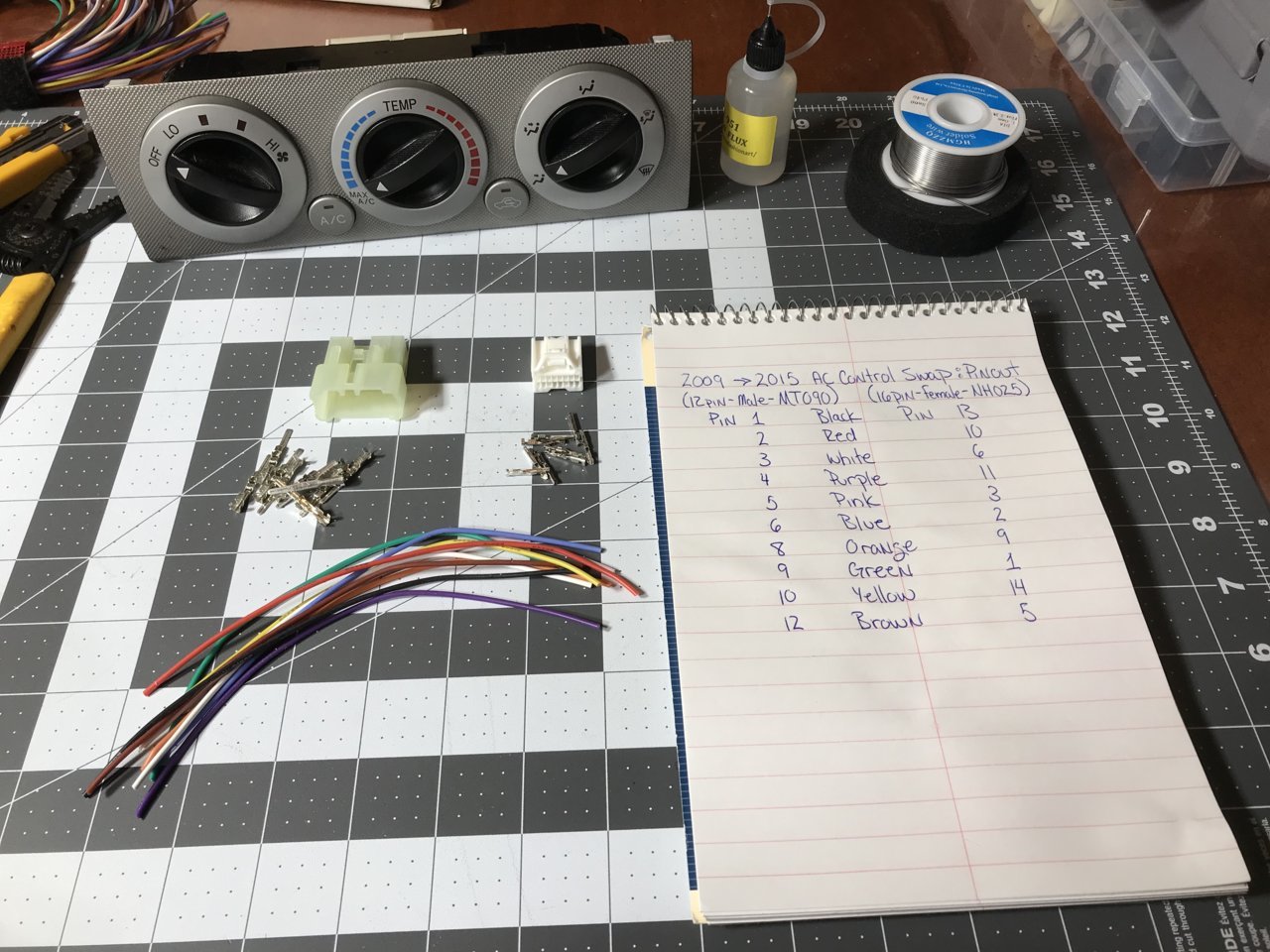

    So I'm going to attempt this soon. I have the hvac assembly, harness housing, and a bunch of pins. Would I just cut the oem connector off and repin the wires into the new harness housing like shown in the diagram on page 1? I'm a little confused on what I would have to cut and crimp and solder. Or did the OP's new wire harness housing come pre-wired and had to solder the wires together instead of repinning?

    anyone making the plug and play wires anymore? or does anyone have to connectors needed I can assemble my own? Just dont want to buy 30 to use 1

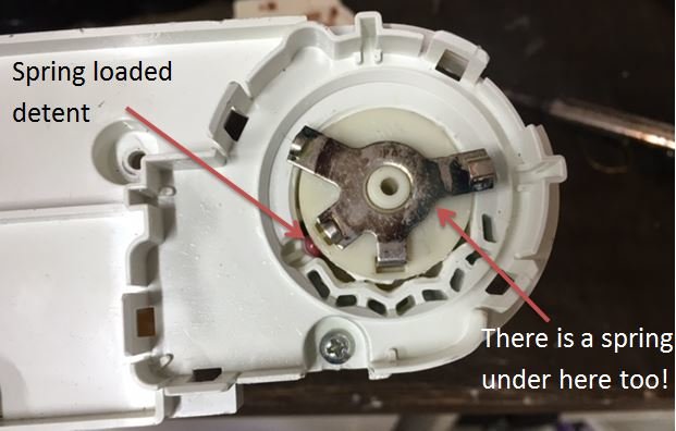

    So I had a similar issue when I first installed mine. The AC light was blinking at first then shut off then it would work. Then as you described the AC button light would stay on. This is how I fixed the issue. Maybe it will help.
    Back when I took the control panel apart to see if I could swap the black parts to the old silver ones, I took apart the motor speed piece's. I later realized I put everything back together wrong. The spring was in the wrong spot, the little metal bracket wasn't lined up right and that tiny little red ball was not in it's rightfull spot. Not having these in correct can effect the way the control panel runs. Pop it open and take a look, worth a shot.
    If not then my last three thoughts would be a wiring issue with the harness, a faulty control panel or a polarity issue.
    I ordered a new Control panel because my LEDs wouldn't turn on and I noticed that the floor vents weren't closing lol. (I plan on selling the old one after the new on arrives.)
    These come from salvaged tacos, sometimes they're not perfect.

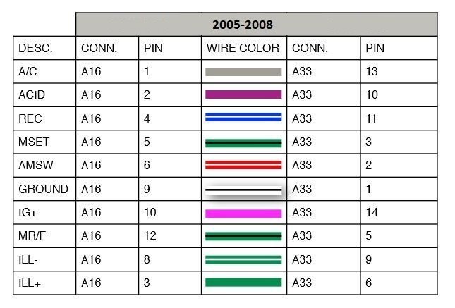

    Pin 1 should go to 13 not 16. I made the same mistake and my AC button would not turn off. Moved the pin to 13 and it worked.IMG_1047.jpg05-08 to 12-15 Climate Control.jpg

    I have a 2010 Tacoma and put pin 1 into the new pin 16, the wiring guide you have posted says 05-08, should I still try it? Also thank you for replying and adding the wiring diagrams, much appreciated.

    It'll work. Same harness wiring diagram for all. 08 and down have to change the polarity on the circuit board. 09+ don't :blahblah:

    I moved the the gray wire from pin 16 to pin 13 and it worked! Thank you everyone for the responses and suggestions!
