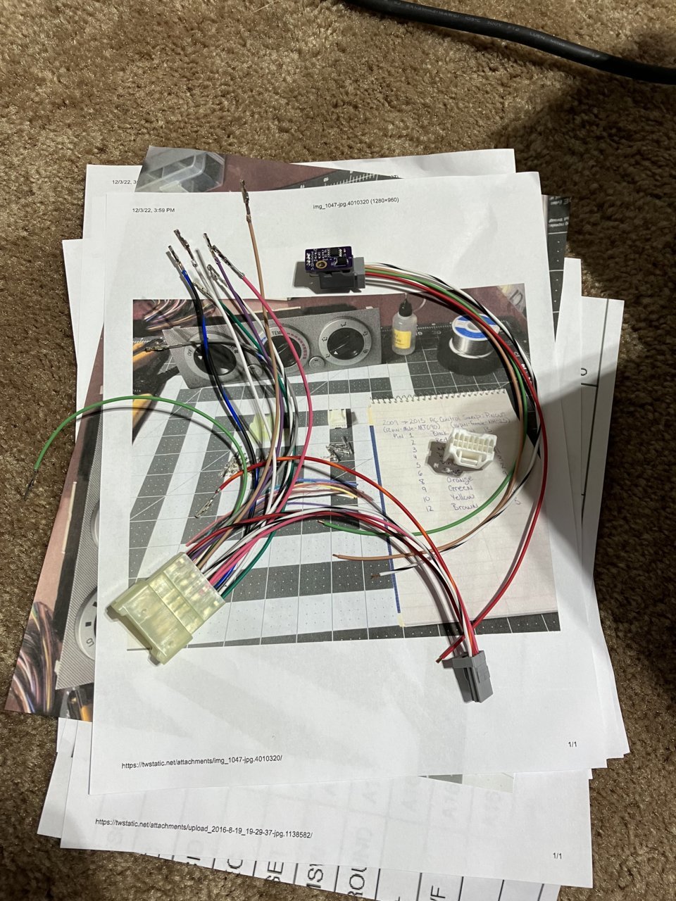

    I got tantalizingly close to wiring up my harness today. I had some trouble with the VSC 4 pin connector so I will have to redo that. Also need to dig up the pin layout for the 16 pin as I’m not sure what goes where without that. The male seems more foolproof based on the supplied images. The board previously tested out good on the bench though it doesn’t quite get to fill supply voltage, and doesn’t go past 0.2v either on the low side. But when testing with the old school silver one I don’t think it went all the way to zero either.

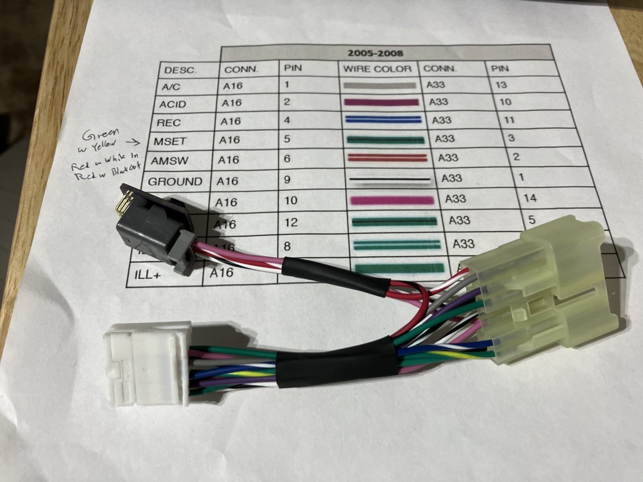

    Ready for QA

    This the work around harness for 05-08s right?

    Yeah, I have an ‘05. If I try to mass produce I might do the fancy with a loop back or I guess I have to do two different ones.

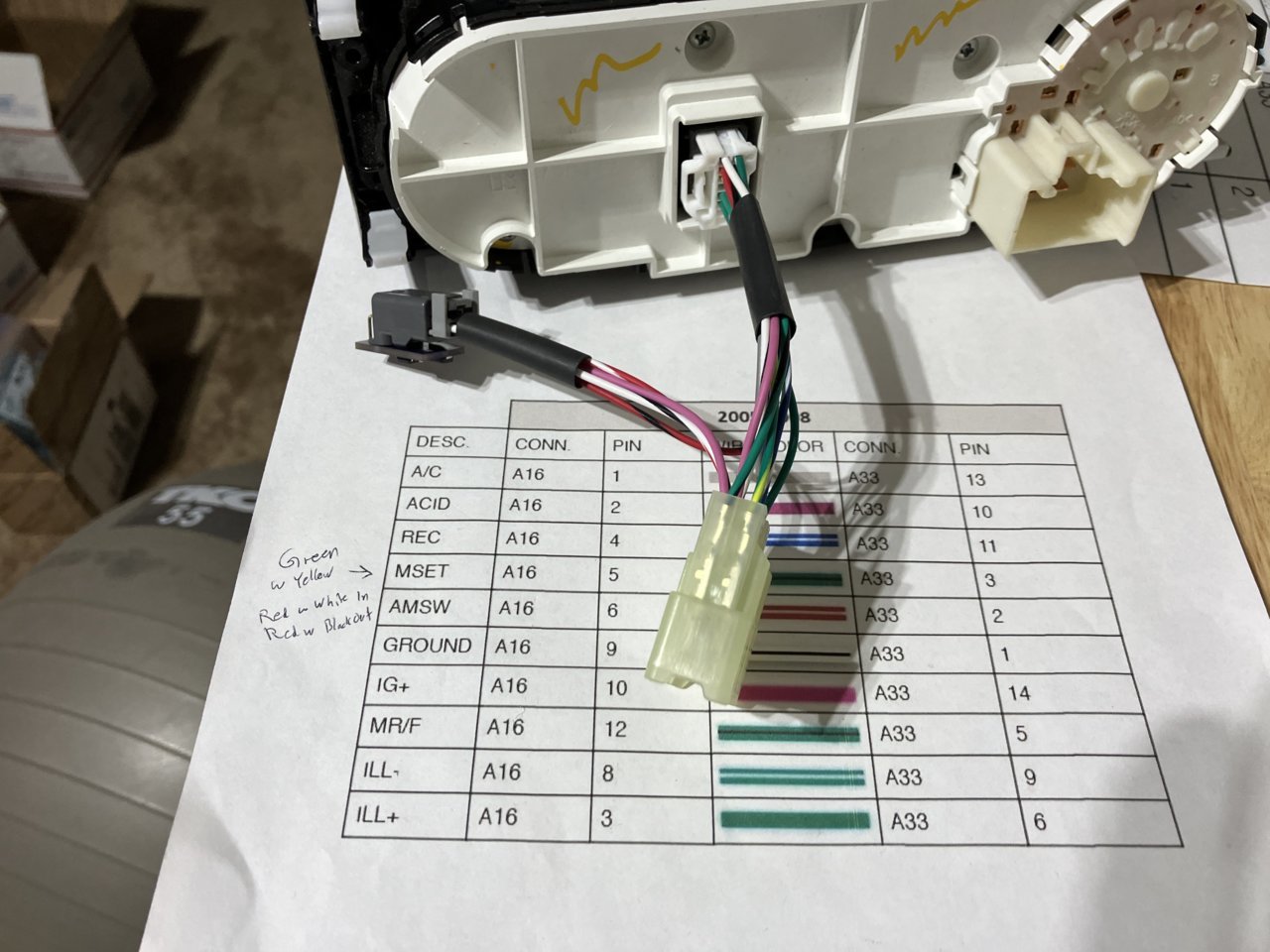

    First test drive. Looks nice. Temp doesn’t change. Back to the drawing board.
