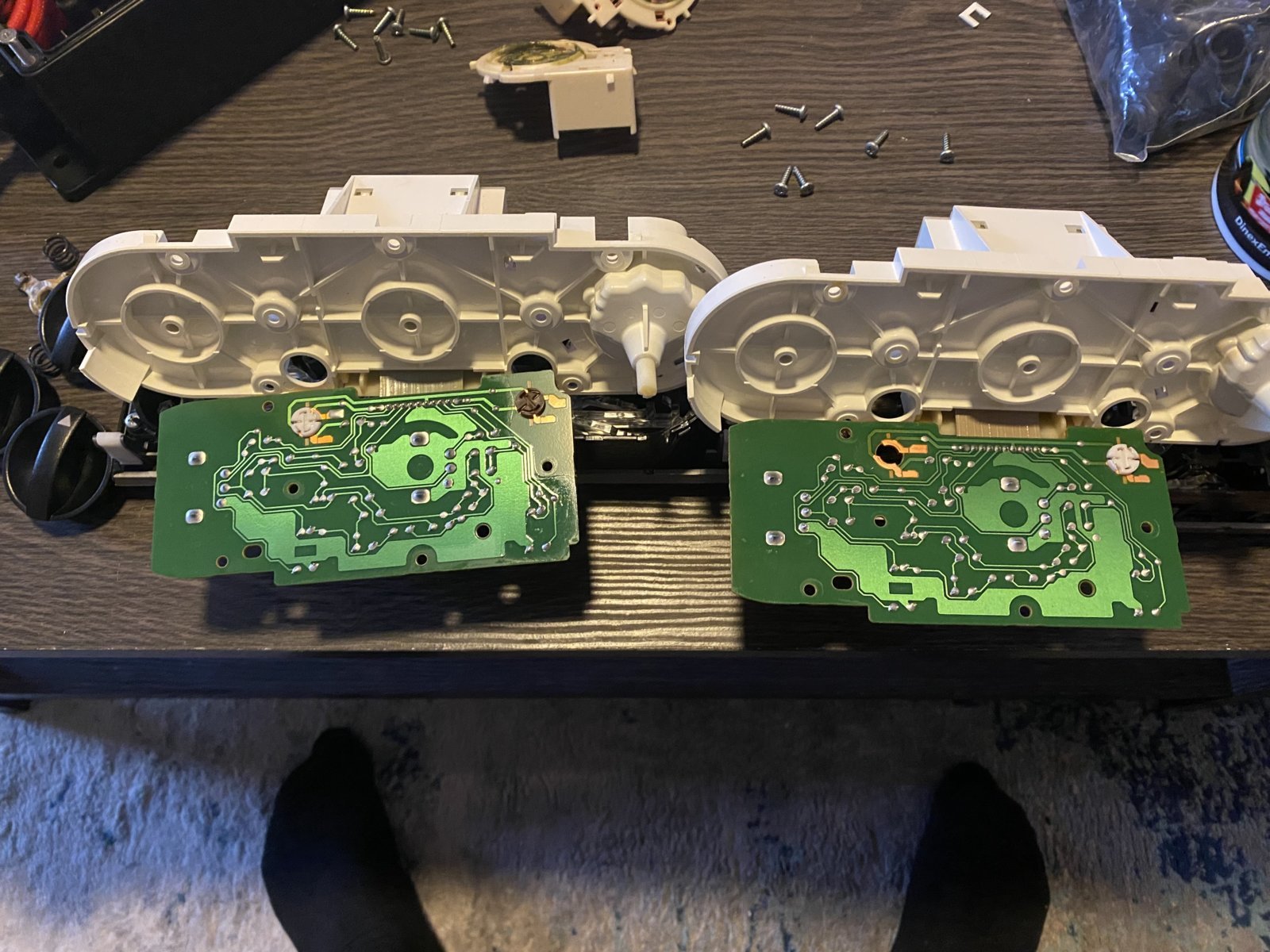

    Hopefully someone in this thread can lend me some help. My truck is an 06, I bought a new AC control module from another member because my stock board kept burning out my AC knob lights no matter how many I would put into them.
    The board is from an 09-11 and I bought it before having the knowledge that the polarity is swapped. Is there a way to resolder some of the connections for the knob like what had to be done on the 2012-2015 so that the 09-11 will work in my 05-08 truck?
    Any pointers are much appreciated. In the photo below, the 09-11 is on the left and 05-08 is on the right.

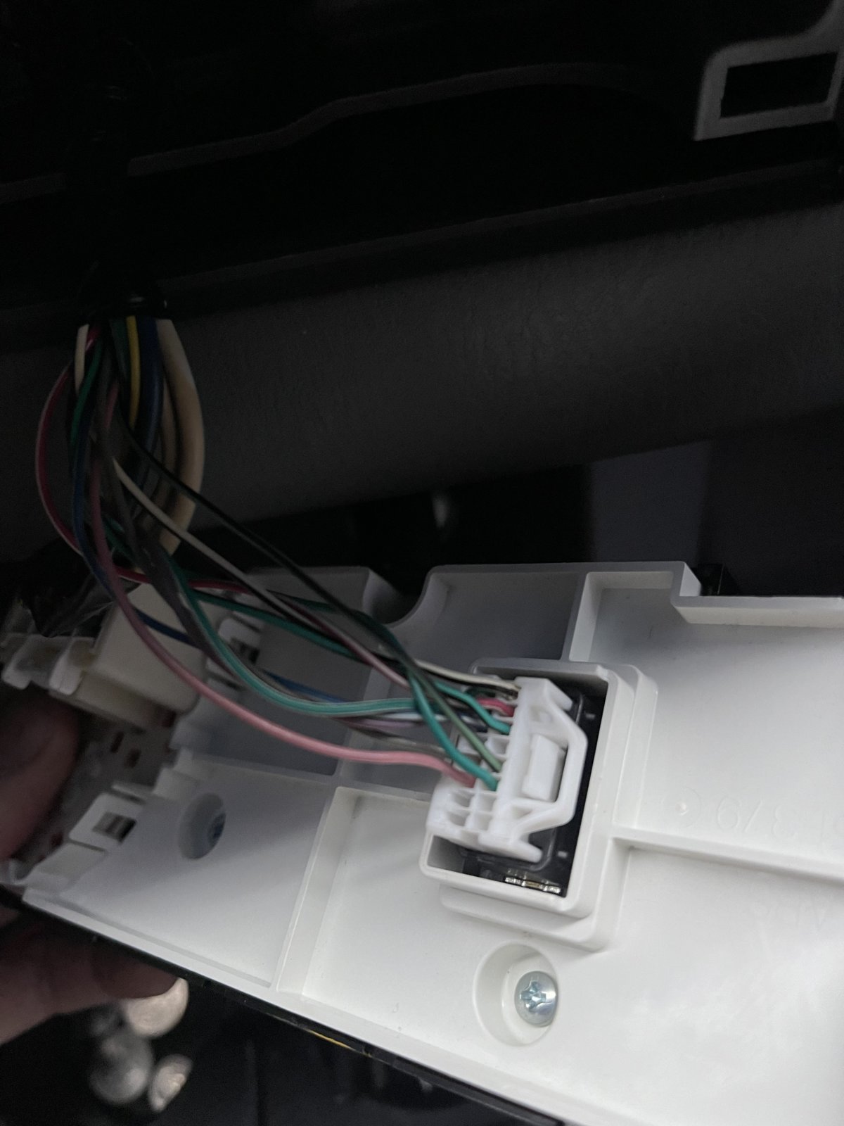

    Needing some help... I'm getting no power to my control panel after swapping connectors. Is there a fuse to check. Can anyone check my wire locations and colors? Thanks IMG_0715.jpg IMG_0716.jpg

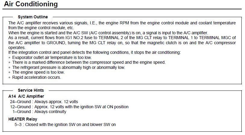

    Looks like I roasted my AC somehow. Swapped back to silver controls and still not cold. Light works with the button. Temp and all other controls are good.
    anyone have a link to a troubleshooting checklist?
